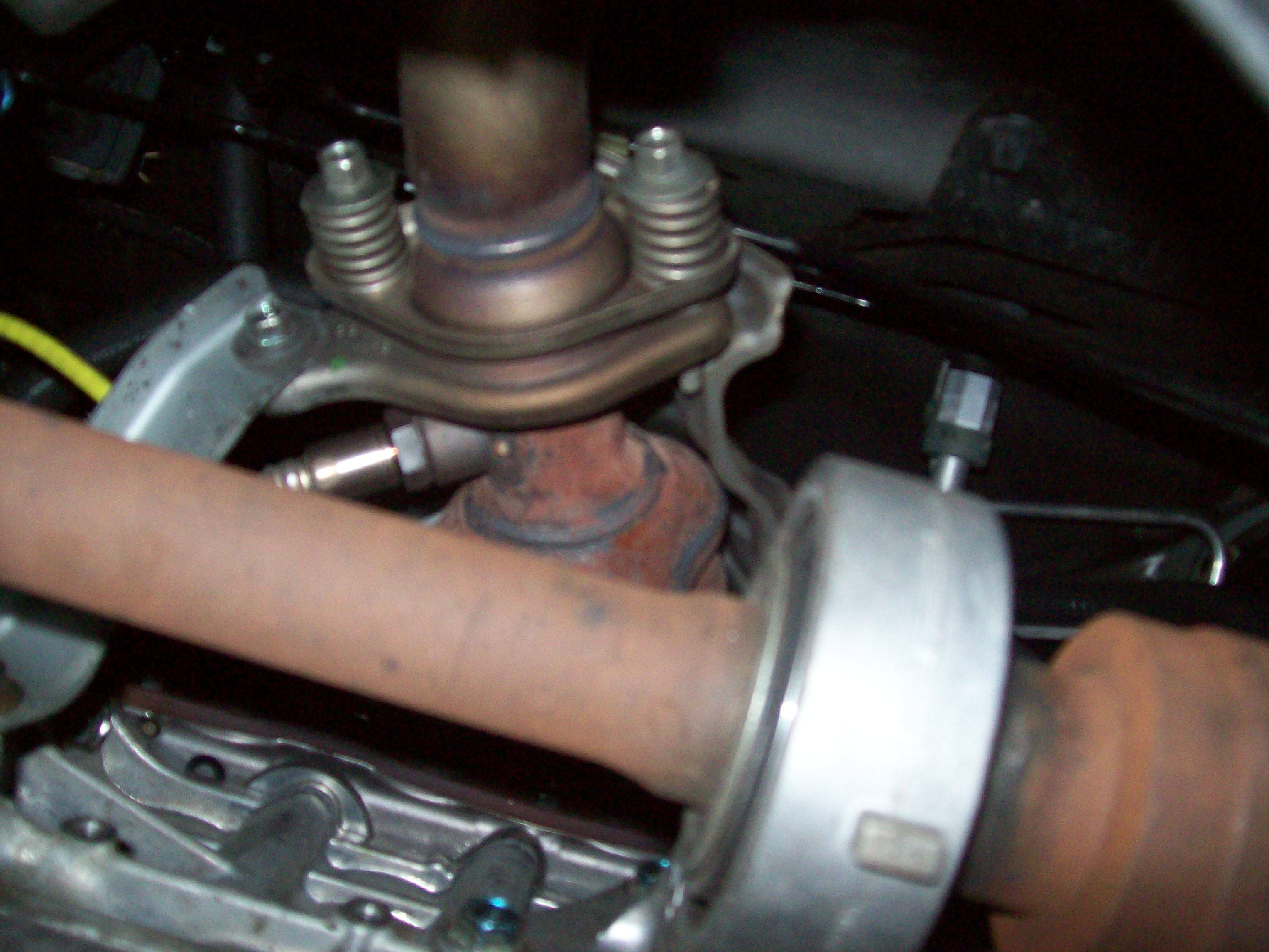

Sounds like CV axle failure (passenger side, connection to the intermediate axle shaft) right next to the shaft support bearing)
The e-brake was failing to hold due to the different issue (rear brake shoes adjustment)

You got it exactly right: front right axle broke. I'll go retrieve her tomorrow to get the full details ($600! High cost of living state).
Thank you.
