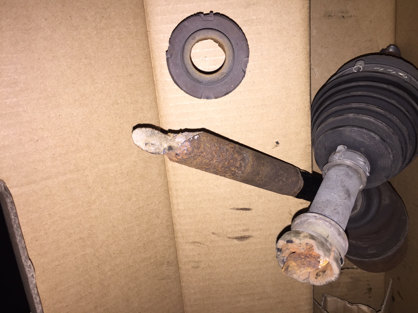

Another broken driveshaft 2008 automatic trans
So, at 209,000 the left half-shaft broke and yesterday, at 211,000 the right one broke. The good news is the both are reasonably easy to replace and are about $50 each. There's a youtube video for the left shaft. None for the right shaft, but the process is mostly similar, except instead of sliding it out of the transmission, there is a midbearing that it slides into/out of. And the right, at least, can be changed with only removal of the 2 - 19mm bolts and unclipping the ABS sensor wire at 2 locations. Even simpler than shown in the videos for the left.
