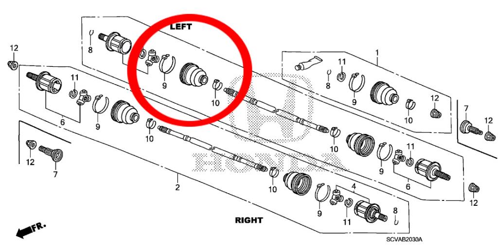

Old Apr 10, 2013 | 10:02 AM
ckipps's Avatar
Joined: Jul 2012
Posts: 68
From: Herndon, VA
once it angles down to a certain point without support it just slides right out.
Correct, to be clear we are not talking about the axle popping out of the transmission. With out supporting the knuckle the inner cv joint will slid out of alignment and binds up. I did the same thing ckipps when I installed my coilovers last week too haha.
