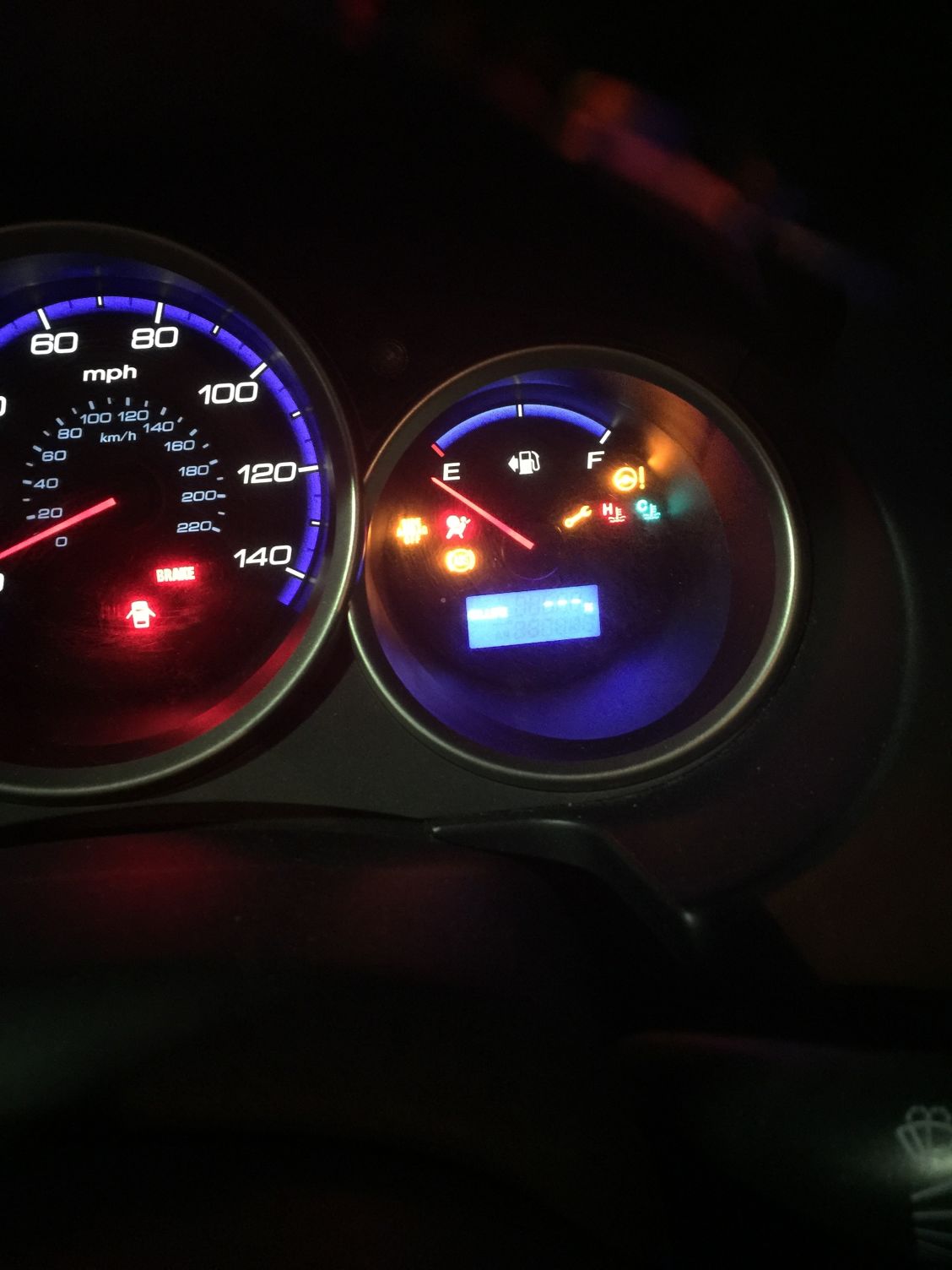

I will check that as well. So I asked my wife what lights blink and when this occurs the lights that blink constantly are on the right the red person in the seat we the circle in front ( I'm guessing that's air bag) and the amber light that's a steering wheel with an exclamation point next to it

Hey guys so I was able to get some more information. When the cars electronics cut out there are 2 indicator lights that block for a few seconds when it happens. The power steering light and the supplemental restraint light ( red light of person sitting in a chair with what looks like the air bag) I posted a pick but I guess it's waiting for approval
Got codes?
Post a link to the pic?
