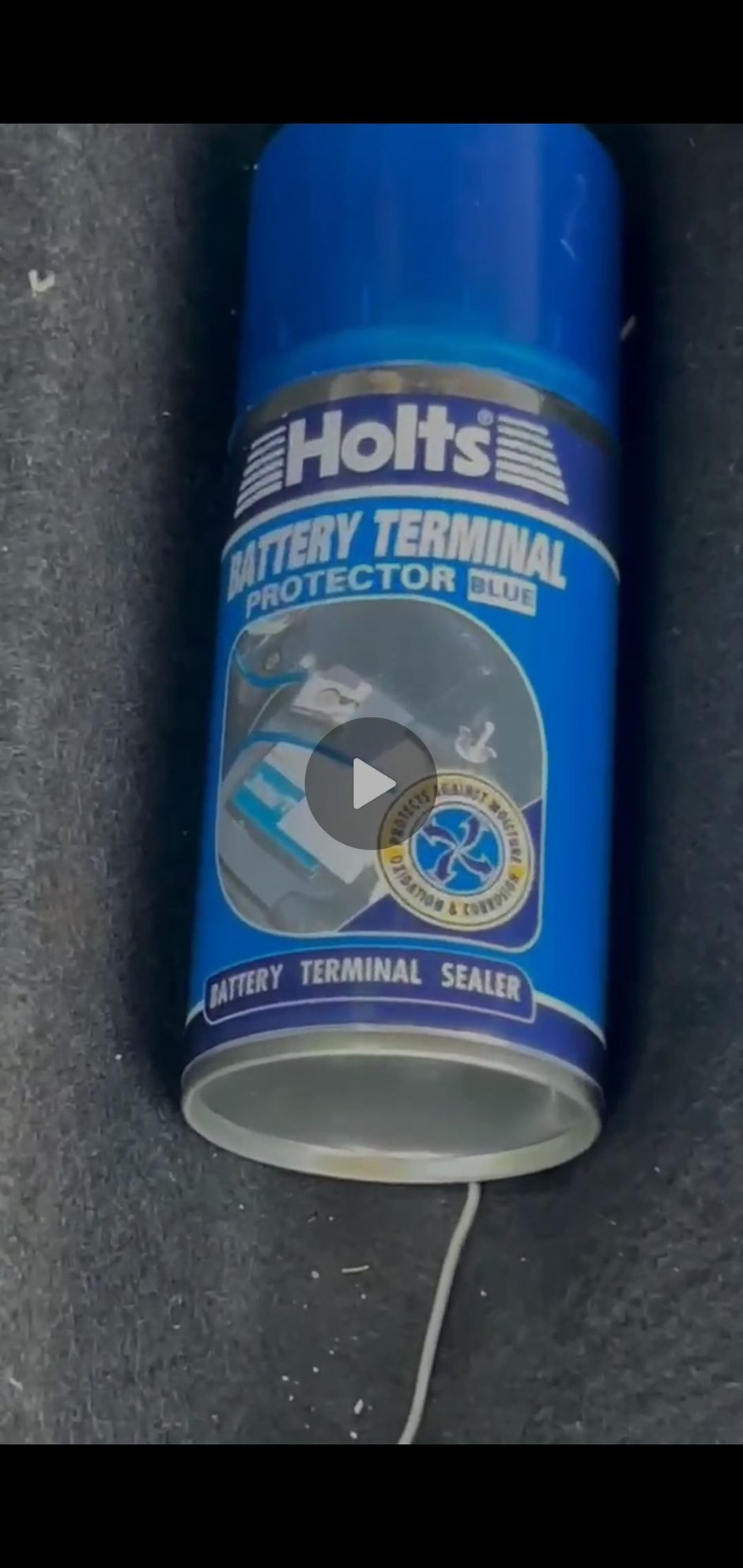

Mine is a Japanese model. Mmh, the battery terminals. 🤔 I recently sprayed some battery terminal protector about a week ago, and that's when I noticed some hesitation when I accelerate. Today is when the EPS and Airbag lights started flashing and lights flickering. Maybe I remove sprayed junk? 😂 Peep the picture I have attached.
