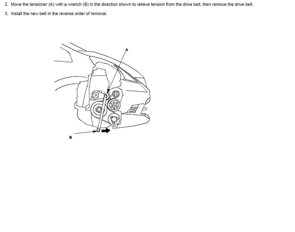

HOW THE EFF DO YOU GET THE DAMN BELT BACK ON???
I've replaced serpentine belts on Ford, Dodge, Jeep, and BMW. This seems prett y much the same...route the belt around everything except the alternator pulley. use a 19mm wrench to pull the tensioner all the way up. Slide the belt over the alternator. Release the tensioner. Have a beer.
I've been at this for almost 2 hours. I tried going back to the old belt, just in case the new one is shorter...same issue.
It just seems like there's not enough slack, even with the tensioner pulled all the way against the stop.
What am I missing? It can't be this difficult.
Old Nov 2, 2015 | 12:24 AM
xxryu139xx's Avatar
Joined: Aug 2012
Posts: 3,354
From: Union, NJ
here u go buddy

here u go buddy
Yup...That's what I was doing. Even with the tensioner up against it's stop, the there wasn't enough slack to slip the belt on.
I did get it, though. It wasn't pretty, but whatever.
I ran a ratcheting tie down from the 19mm wrench attached to the tensioner up to a hook in the rafters of my garage. Cranked the tie down until the tensioner was on the stop. That left my hands free and I used one hand to guide the belt onto the alternator while the other hand used a socket wrench to turn the alternator pulley to suck the belt on.
