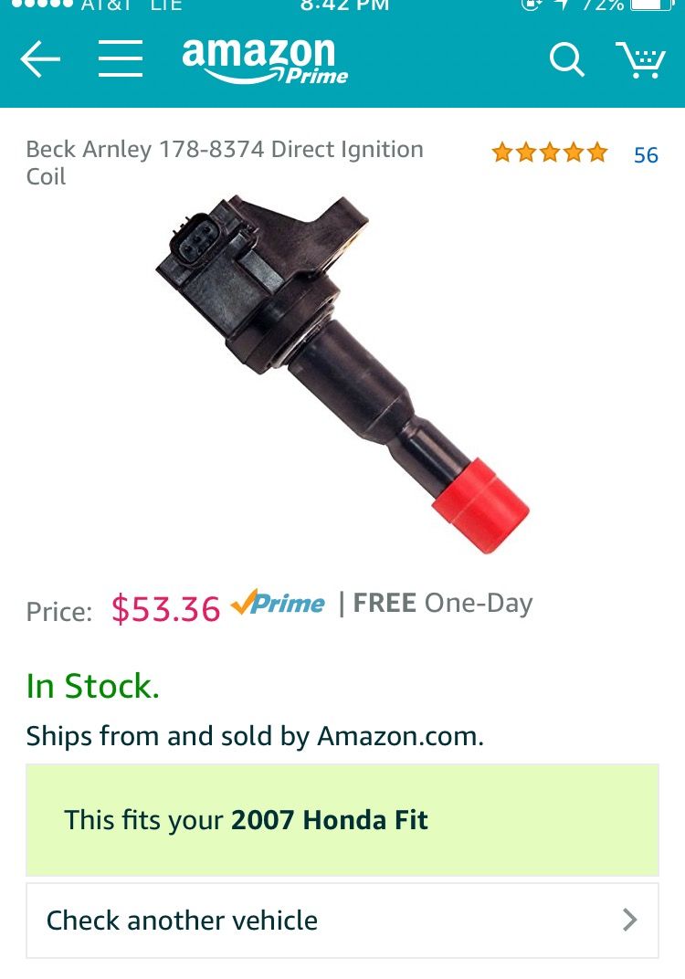

These are the oem Honda ones get these
Attached Thumbnails 07 Fit Sport PLEASE HELP-80-img_8962_png_929217f71613ee00b0b895345f8ddfdd45b364d4.jpeg

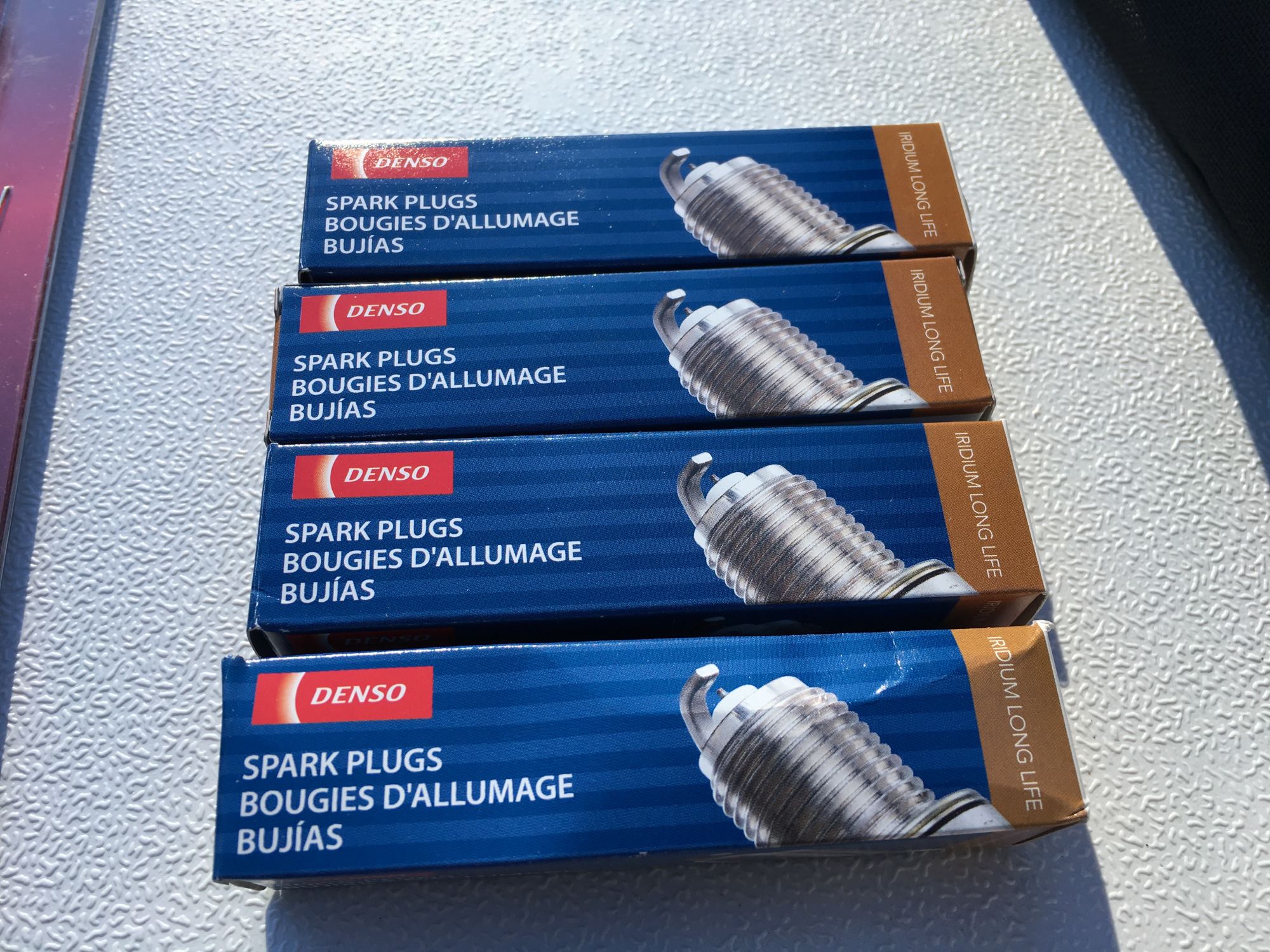

These are the Denso spark plugs, I like buying online for in store pickup at Advance Auto using their $20 off $50 coupons
Attached Thumbnails 07 Fit Sport PLEASE HELP-80-img_8480_9762ad0e585447d0a27b1cbc5d68361e4921227f.jpg

The coil on the picture is of the older version without vent hole. Hitachi (IG0053) design is identical to coils currently sold by the dealer (Hitachi for Honda) (boot , spring, high voltage terminal shape)
There is no hard evidence, though, that the electrical parameters of high end replacement coils are identical to those sold in the dealership.

Beck Arnley Is Not The OEM Part
Just because someone stamped OEM next to an item on a retail website does not mean it is the OEM plug. Yes, they will fit. If you are going to the trouble of replacing parts, stick with the Hitachi parts which will last you another 100,000+ miles. Most mechanics will tell you not to venture away from Denso or Hitachi for Japanese engines. And yes, your GD3 will be as good as new again when you get the plugs and ignition coils replaced. Don't skimp on the cost and find yourself somewhere far from home when your Beck Arnley ignition coils fail "prematurely" down the road.

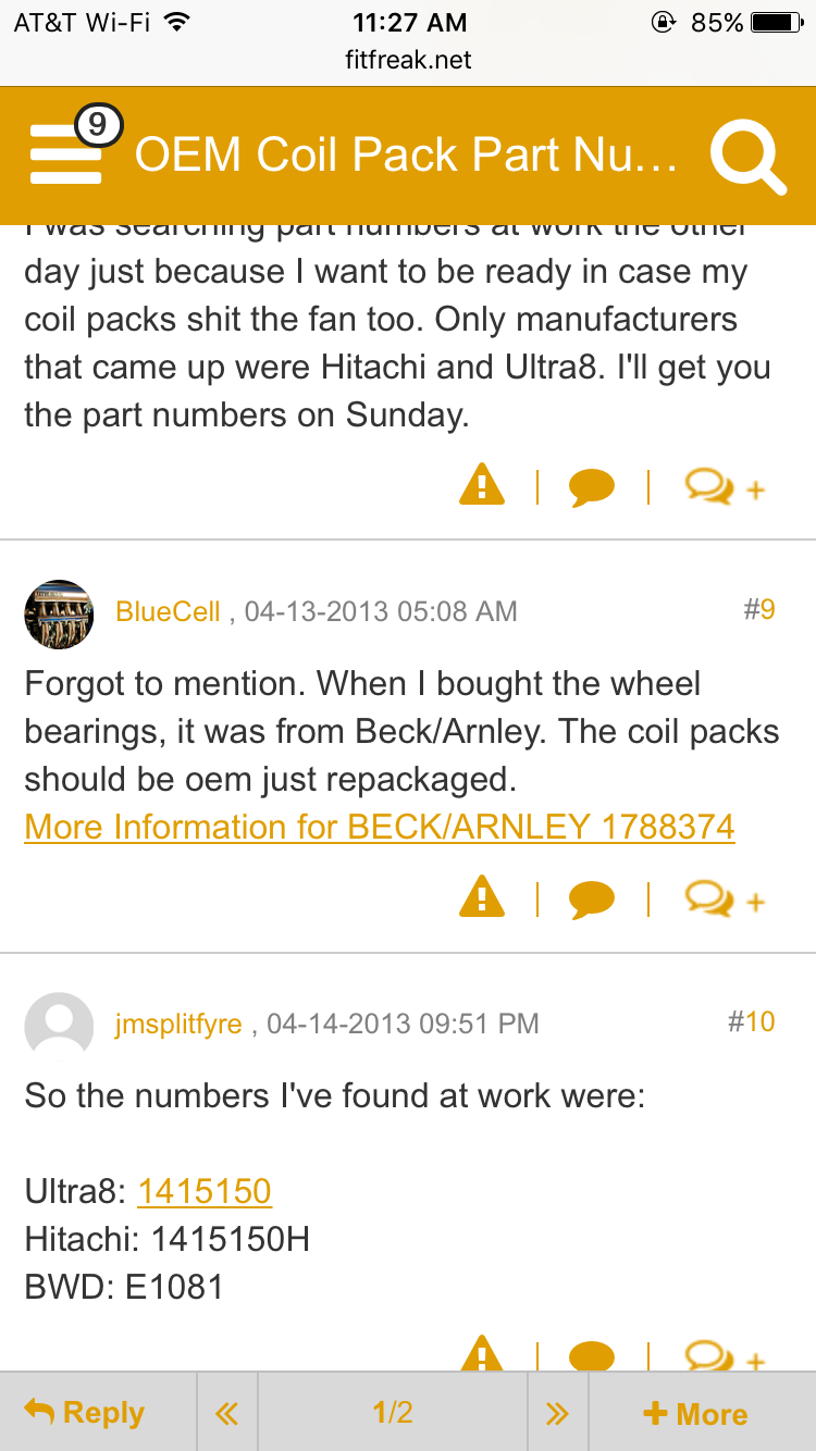

I'll take a look at my coilpacks when I work on my car this weekend but from my research Beck Arnley is used as OEM as well.
https://www.fitfreak.net/forums/1st-generation-gd-01-08/77493-oem-coil-pack-part-numbers-2007-honda-fit-base-model.html
Attached Thumbnails 07 Fit Sport PLEASE HELP-80-img_8979_f69e64649320cbdfcafe58f19d3a5a8704c58a35.png

On the junk yard I found a Fit with Duralast cois (older version with red boot and no vent hole), replaced relatively recently (the boot ends were bright red, not fading to pink)
I pulled the boot assembly from the coil and found re-designed flat high voltage terminal contacting the conductor spring with significant amount of burned residue = electrical arching (old Hitachi and new Hitachi 0053 has cone shape terminal with minimum residue)
While the 0053 (Japan-made) coil is claimed to be "same" as the coil sold at the dealer (the only difference is the color of the tip) the hard evidence should be acceptable primary voltage range, consistency of spark, and amount of hours at maximum working temperature before failure. It is wild thinking but the coils which are exceeding minimum requirements are going to the dealer, while these that "just meet requirements " are going to Autozone or Rockauto.
Need to add that even coils that just meet requirements may work very well (miss not noticeable to driver) on high mileage car there engine runs with increased vibration due to the old motor mounts or mechanical wear.
Not sure if these are the coils but on my car the levels of engine vibrations is higher after installing 0053 coils (from Autozone)
