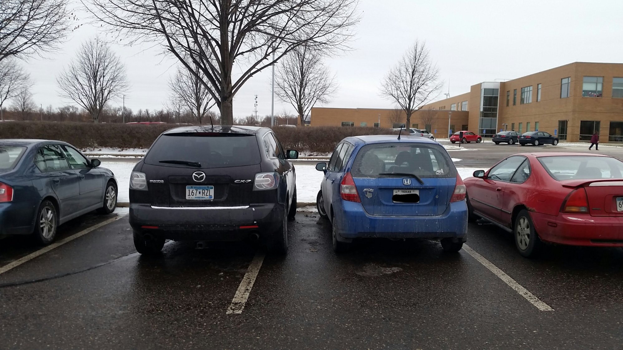

We picked up a 2007 Fit from my father in law down in Texas. We're using it for the winter with some possibility to buy. Our other car gets garaged in the winter. Wasn't sure I had a photo, but I do. It's an interesting one, lol.
So, there it is. Pretty good on the outside. It got new plugs before we got it. It has generic (junk?) coils on it for now. I'll watch for loosening plugs. Number two seems a little funny. There's a few other things for maintenance it needs.
