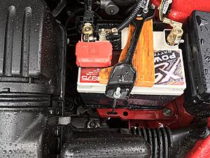

Hi Folks,
My wife had 340,000 miles on her '93 Civic CX and it was starting to show its age.
In October I found a base 2008 Fit for her.(She likes it.)
The battery was on its way out so I did some searching.
We hold on to our vehicles a long time, so years ago went to AGM batteries.
Odyssey had one that would sorta fit, but would need different cables.
Ended up buying an XS Power S975.
It fits nicely in the factory plastic sleeve base, but I removed the top plastic cover.
Added a block of wood on top to make the hold-down fit.
Am going to replace the hold-down bolts with shorter ones.
Actual weight as measured at the local shipping store was 25.2#, with the terminals.
https://4xspower.com/shop/12v-agm/s-series/s975/
Terminal note:
There are short and tall terminals, with the tall ones being only slightly taller.
You need the tall ones to get the cables on.
The retailer shipped it with the wrong terminals, so ya really have to watch this.
These batteries are made overseas.
With a properly maintained charging system, and never leaving the lights on and totally killing the battery,
am hoping for ten years life. Time will tell.
Thanks and good health, Weogo
