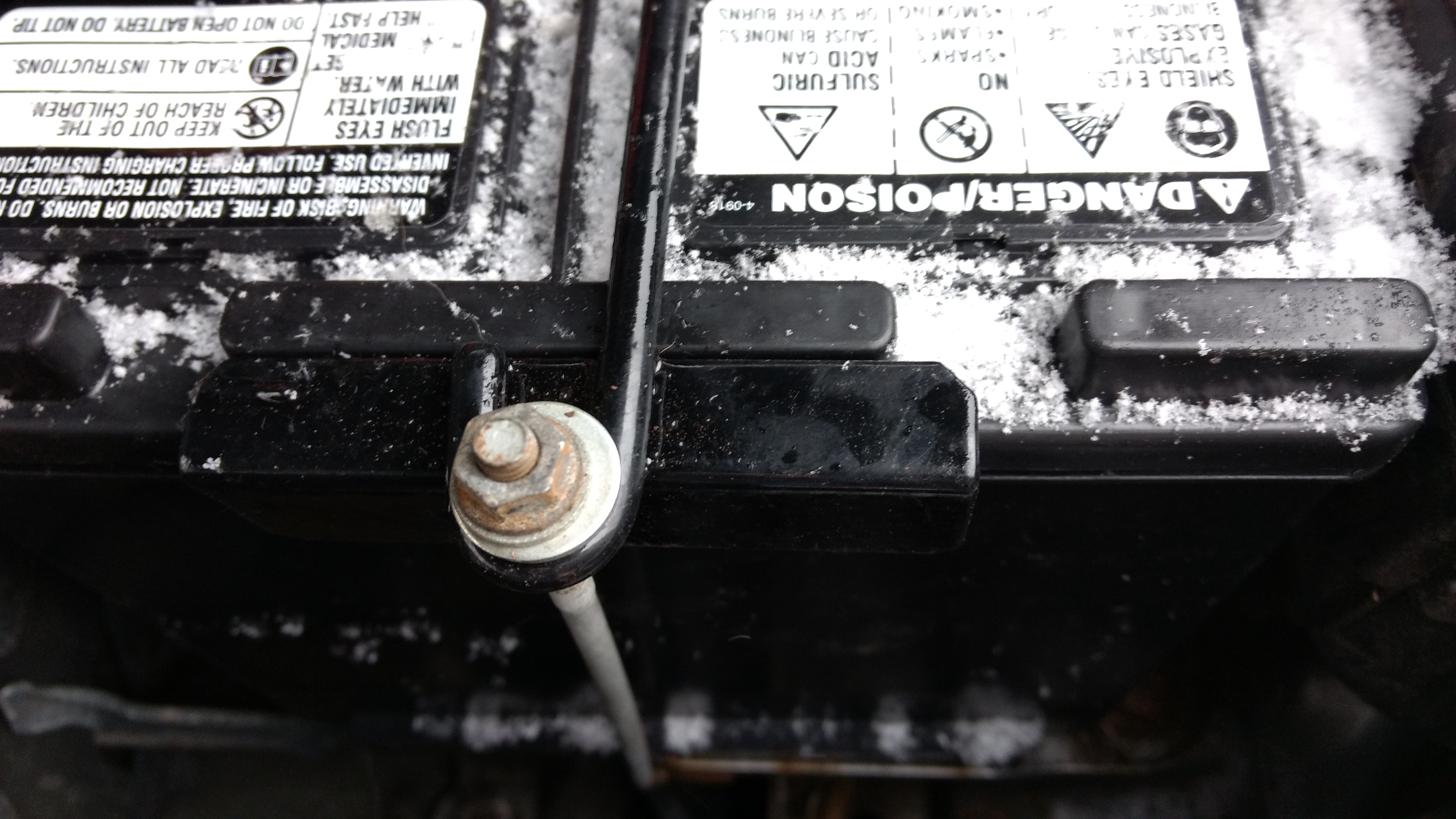

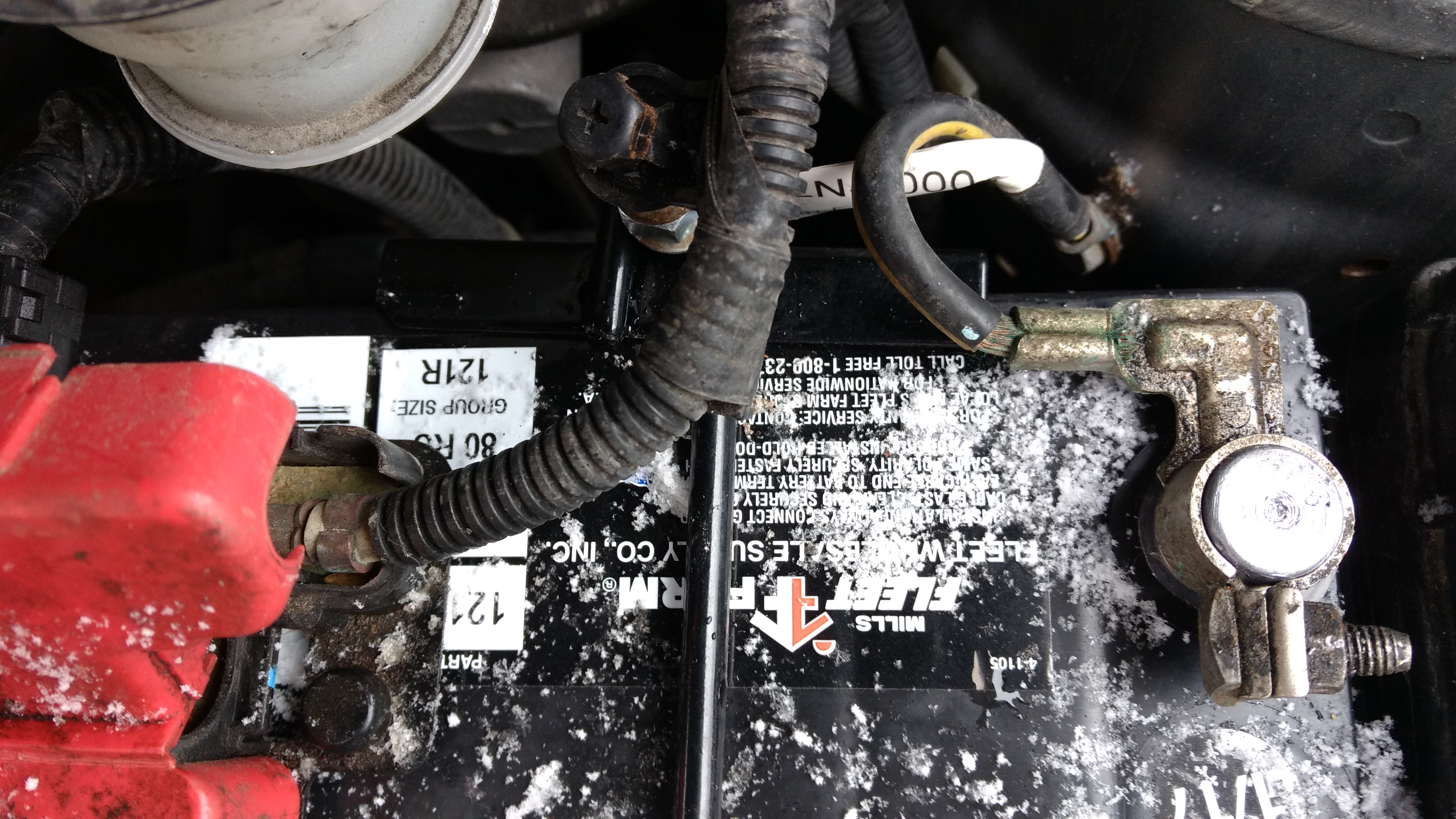

Kudos on the 121R battery. I to have spent a lot of time searching for a bigger battery to fit into my 2008 Fit Sport. I did replace the 151R battery back some years ago with a 51R and I wound up removing the battery plastic tray thingy and bolted things into place. It is a tight fit but after many years of driving nothing was damaged. Now it is time to install a 121R. The biggest issue I see is that is wider by almost two inches but I have a plan to get it installed in a proper fashion. Length is not a problem as it could have been with the old 151R.
I bought a Deka Battery Tray and a Deka Battery Hold-Down they are made by the East Penn Company that also happens to be one the oldest battery companies around and they were the ones that built my new 121R Battery 72 month warranty and 24 month free replacement.
The battery tray is polypropylene and will require some cutting down to enable it to fit where the original one was. I'll try to post some pics when I get done.
Okay, I found that the rear (close to the firewall) "J" bolt is longer than the Front one. When using the aftermarket hold down I found that if I swapped the J-bolts from front to back, they would be long enough.
Now there is plenty of room around the battery.
Make sure on the firewall side that the J-bolt faces away from the battery.
On the front side I placed the hook on the outside of the battery tray. Worked out very well... snow not withstanding.

As a FYI: I did not use any tray at all in the installation of the 121R, just an aftermarket hold down. After discovering that the "J Bolts" from the factory on my 2008 Fit were of different lengths, I had to swap them around to get that hold down to work, along with a washer or two.
Just a heads up when placing the rear J Bolt, be sure to have the hook end pointed away from the battery.
