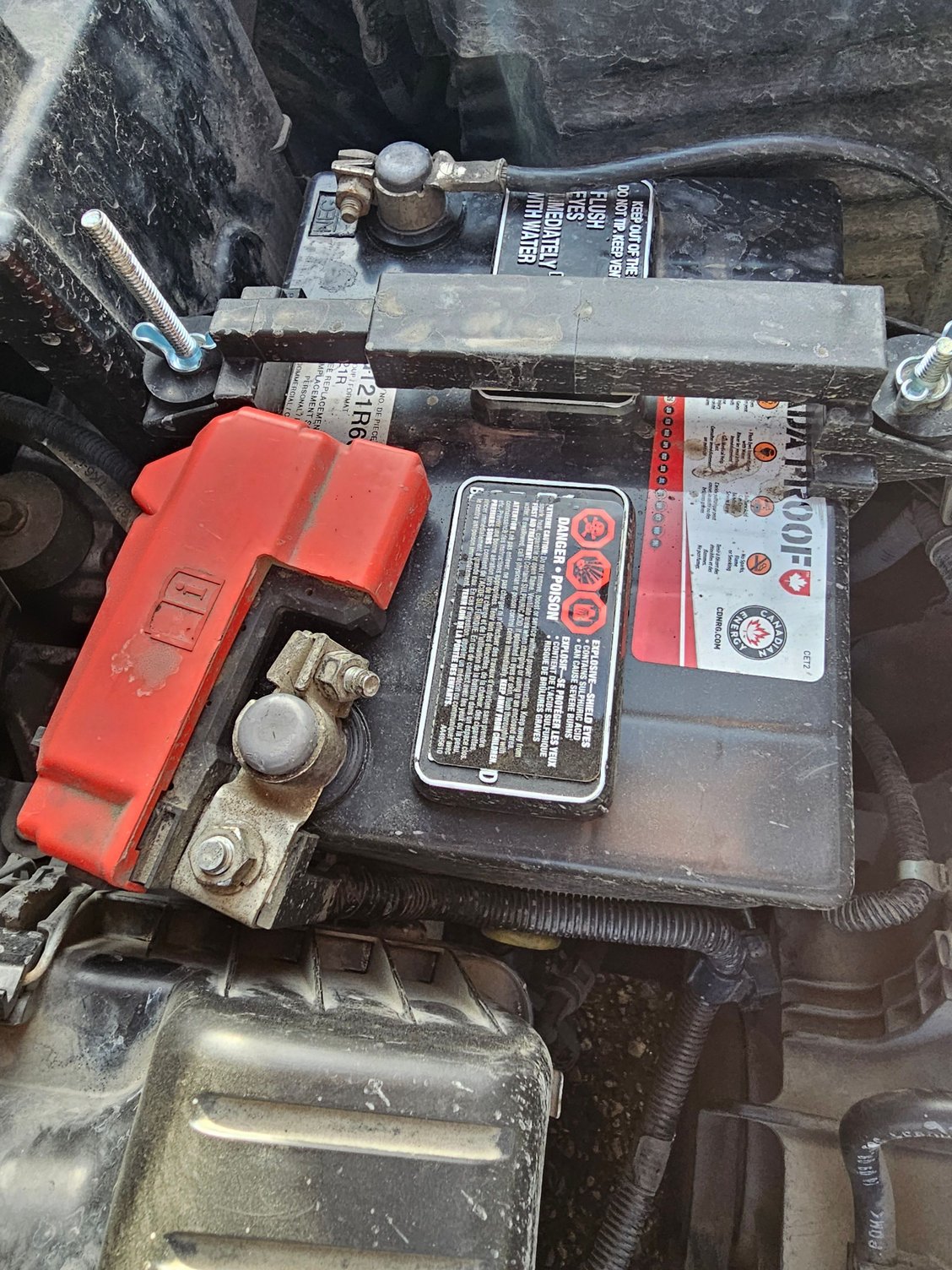

I would really like to see the 51R under the Fit's hood!
Ask and receive.

I just did this....(Dual battery)
Originally Posted by SevereService
First, the 51R battery does fit under the hood after the removal of the battery tray. While I have never needed more capacity or cranking amps past what the smaller 151R battery gave me, it would have been nice to know more capacity was there in the event of emergency conditions. Lets say I had an emergency where I needed to keep the hazard lights and vehicle lights going for an extended period. The 51R has 85 reserve minutes versus the 55 of the smaller battery. Also, if something did happen to the 151R its not easy to get that replaced. The 51R can be purchased at any Walmart whereas the 151R is generally only in-stock at the dealership. The only downfall is that you will be modifying the inside of the vehicle by getting rid of the battery tray. Im not sure if anyone will notice however.
The 51R is larger, more robust and will probably last longer then the smaller 151R. In a heavy snowstorm or really cold weather, the 51R has better chance of cranking that vehicle up.
Second, I looked at Interstate, Autozone Duralast, Sears DieHard and Walmart Everlast. They are all the same battery manufactured by Johnson controls and Walmart was by far the cheapest 51R at $85. The Interstate battery, the same battery as the Everlast, went for $140 at the local Firestone dealership.
Not trying to steal your thread, just want to put out an alternative to the 51R battery
I just did a dual xp750 battery modification to my fit.
From what I seen , the 51r battery barely fits, and has to be mounted on an angle pointing towards the headlight...(at least the one I saw was setup like that). There isn't a lot of room there though to begin with in all honesty.
With one of these batteries, cranking was fine and did the job, and is light as hell too. BUT.....when we had this recent cold snap and temps dipped into the negative or near negative temps, the battery lacked some power and I had to keep jumping it from time to time with one of those mini battery jumper things. Apparently it didn't need much of a jump though, due to what those jumper battery packs put out. So, I started eyeballing up how to fit in two of these little batteries in the same area that the stock battery sits in.
This new base/tray will accommodate a battery that is 7.5 ( wide, 6 depth x 6.5" tall.
(With a little bit of milling on the top part of the one I made, you could squeeze in something that is 6 1/4" in depth, but thats pushing it).
Also noticed, the colder it got, the more starting issues I was having, and hearing the starter lag in its actions in both directions (engaging and disengaging the flywheel.
Now, even though the temps are better lately, the car starts up like a champ, and the starter doesn't hang up at all either.
Btw, I'm planning on making more of these if there's an interest...

Originally Posted by Realdeal73
From what the older generation fits battery base/trays look like they look to me like they bolt up differently. The 2009-2014 have four bolts that mount directly to the front frame rail. I looked at the older and newer fit battery tray/bases, and they have a different shape and appears to have a different bolt pattern. But hey, I'm somewhat new to having these cars soz the more I work on them the more I'm learning about them.
There's no need to replace anything but the plastic tray itself. The steel supports remain in place. You get a battery tray for a 2015-2017 Fit with 51R battery. It looks like this:
Bottom-ish view
Bottom-ish view
I do believe you misses what I said and automatically thought i said tapping the threads. I mentioned chasing the threads. Little bit different than cutting new threads.
I believe otherwise. Note that I said "retap", not "tap". "Chasing" is retapping.
Also, the sluggish starting comment.....
As I said, I wasn't having an issue with starting until the cold snap started. Car was fine on just one of these xs batteries.
Also, when the battery is subjected to cold temps, voltage diminishes...which will cause the lazy starter issue. That I mentioned. Since then the weather has warmed up...and even though I have two batteries nset up on this car ..it's flawless now.
... hearing the starter lag in its actions in both directions (engaging and disengaging the flywheel.
"Engaging and disengaging the flywheel" isn't the domain of battery voltage, regardless of temperature. It's the domain of the solenoid and Bendix.
You also mentioned the rigors on engine bay service ....been in the car for over a year now....so....yeah.
OK. I was concerned not so much about low temperatures but about high temperatures. It gets awfully hot in there. No sign of UV degradation in the white battery shells?
It's always good to talk these things out, is it not? I mean... that's why we're here at a forum.
