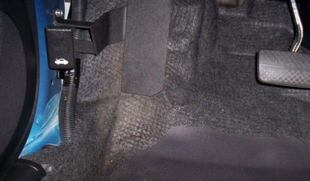

The one from Zeta looks like this:
Pretty straightforward, 5 major visible pieces to weld together (2 x bolt supports, 1 x L brace, 1 x pedal face, and 1 x pedal underside support). 3 pieces to bend (2 bolt supports and 1 L brace). Summer project most likely. I'll make extra few prototypes. Based on the response, I don't see great demand for this product. Not doing this commercially, so if you want an guarantees on beauty or whatever, keep looking for a used Zeta. This will likely stay a prototype product, enough to share some costs to offset just making a single unit. I just need a unit for myself.

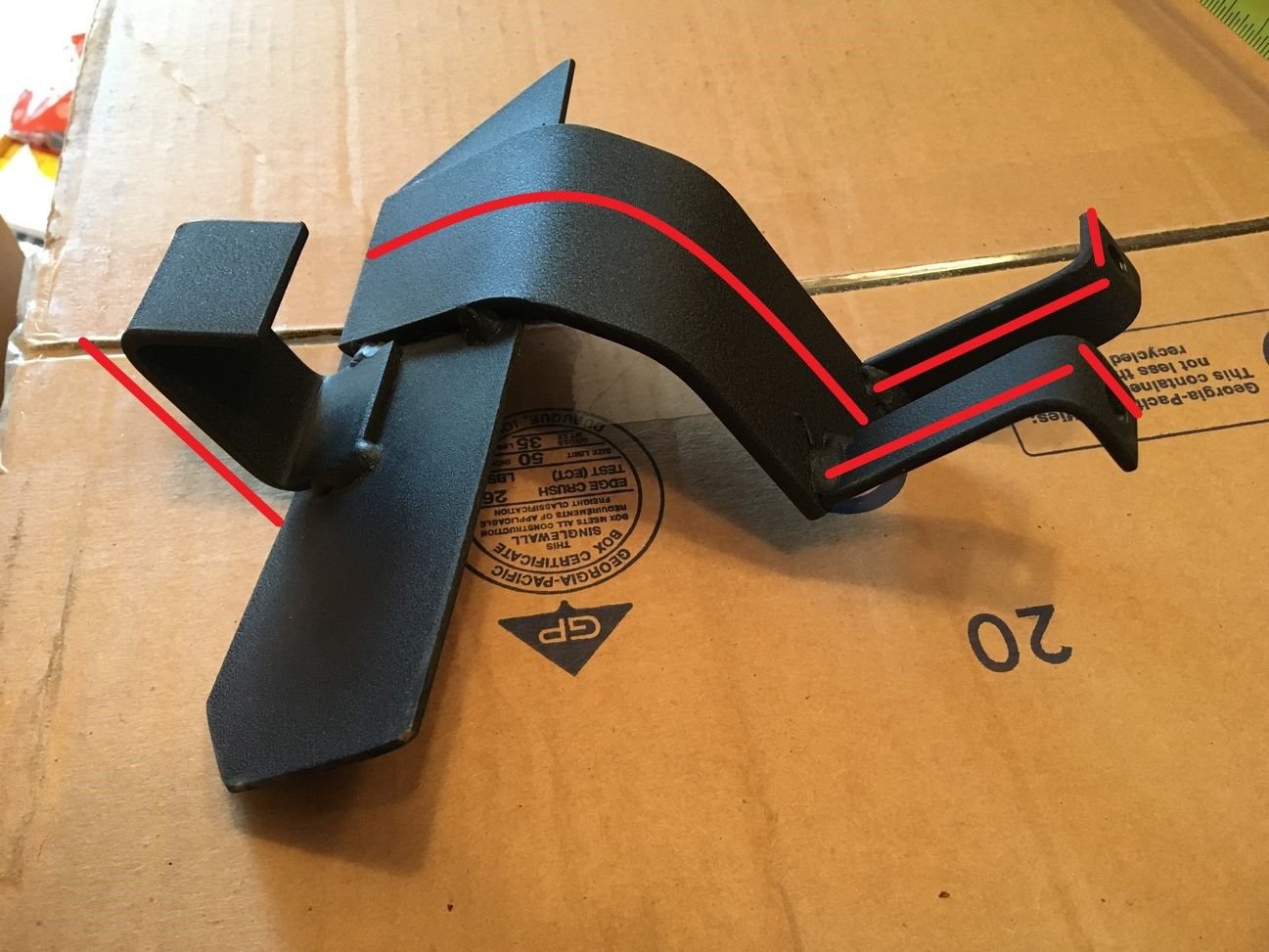

I think there's more to the design than you realize. Not that it couldn't be simplified, but there's more going on than you see in that picture.
Finally back from a long trip so I could pull ours out and get a few pics. More available upon request...

Can you put a tape measure to each of the bendy pieces? So I can get rough measurements for the items in red? Photos are fine. Thanks for the pictures of the rear. Still pretty straightforward, but you were right about it being a bit complex still. Can you also give me a thickness measurement. Look like 1/8" thick sheet steel, hard to bend.

Since you are clearly better at photoshop than I am , could you add letters to the lines? That way I can give you A measurement, B measurement, etc.
I don't know why, but they used four different thicknesses of metal. The large bracket is actually 3/16" (7 gauge), the short C in the back is 9/64" (10 gauge), the parts that bolt to the hood latch seem to be 1/8" (11 gauge), and the pedal itself is 5/64" (14 gauge).

Since you are clearly better at photoshop than I am , could you add letters to the lines? That way I can give you A measurement, B measurement, etc..
Here you go. Thanks for taking time to do this. Also let me know where the improvements can be made.
E1 is distance from center of one hole to the center of the other hole. Also tell me in F1 how large the hole is while you are in there. 8)
Also can you take a photo of the side of this bracket. I'd like to better understand the angle.

A1 - 1.25"
A - 2 1/4" (flat part is just under 2")
B1 - 2 1/2"
B2 - 1 1/2"
B3 - 1 3/4"
B - 7"
C - 2 1/8"
D - 2 1/8"
E - 3/4"
E1 - 2"
F - 3/4"
F1 - 3/4"
G - 3"
H - 1 3/4"
i - 1 1/2"
J - 3 1/2"
That bracket is a compound angle as you apparently suspect. Not sure how to even describe it. Will work on a pic.

F and F1 should not be the same. F1 should be the diameter of the hole. F should be the plate that has the hole and should be larger than F1. Don't forget about K. Just checking. Thanks for the measurements!

Sorry, F1 is about 5/16".
This gives an idea of the compound angle...
