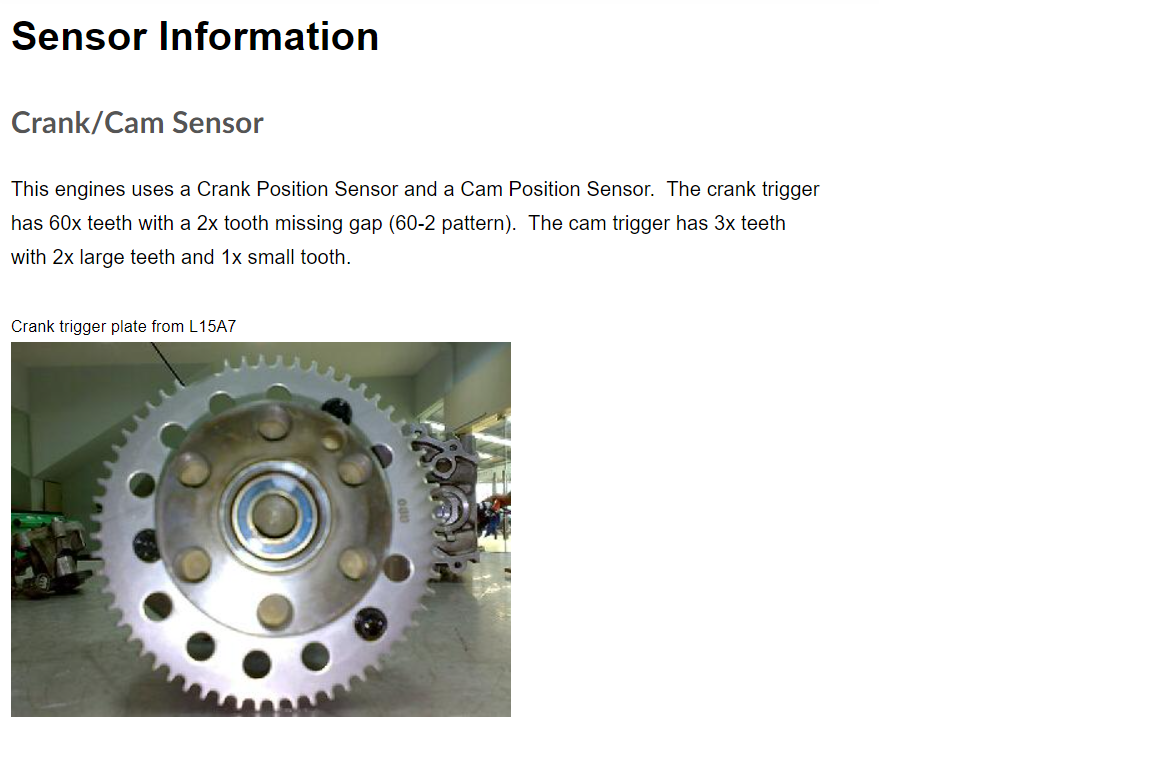

58 + 2 missing teeth. Very important as I need this info to set the timing in the emublack standalone

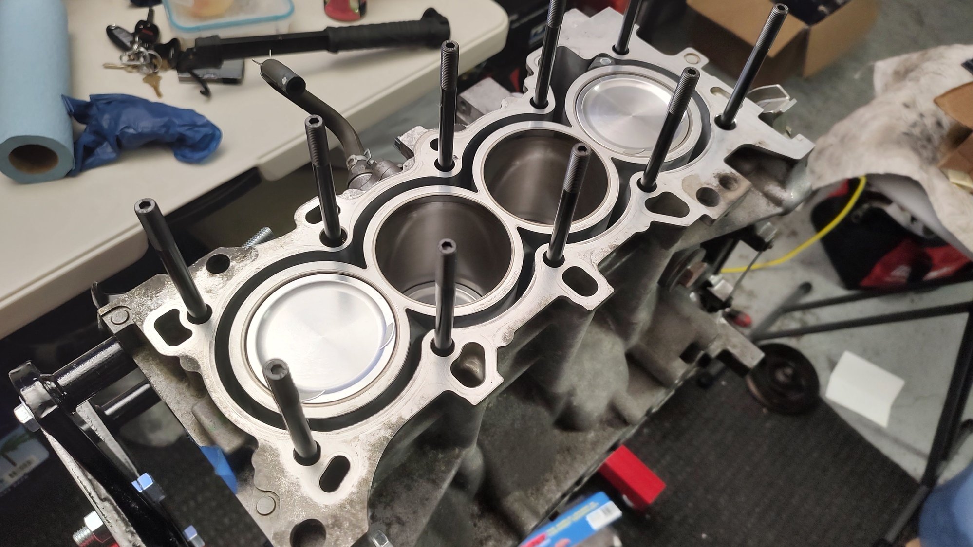

Honed and checked ring gap clearances. Bore is STD 73mm
First piston/rod done and a comparison to the stock setup. Funny how I am currently still managing 14 psi peak pressure on these tiny rods @ 148k miles daily driven.
Got the bottom end together
Next up is getting the head done!

Just an update
Triple checked everything and installed the ARP headstuds
Installed Honda head gasket and dowl pins
Valves, valve springs, retainers, and valve lash

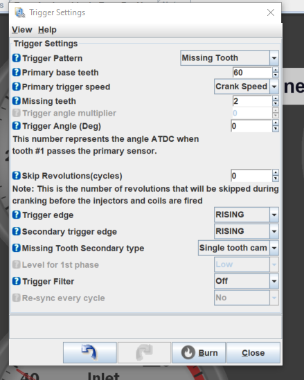

it looks shiny and expensive. i go few questions
1. trigger setup: do i put 60+2 or 58+2, aem said 60 but i saw that they did other mistakes on sensors info, idk how to configure it, cam sensor neither

It would be 58 teeth and 2 missing teeth. So a base of 60 teeth and 2 missing. If you look at the picture I posted on the crank you can count and see for yourselfOn pump gas you will be knock limited and won't be able to squeeze every bit of HP/TQ out of the stock engine.

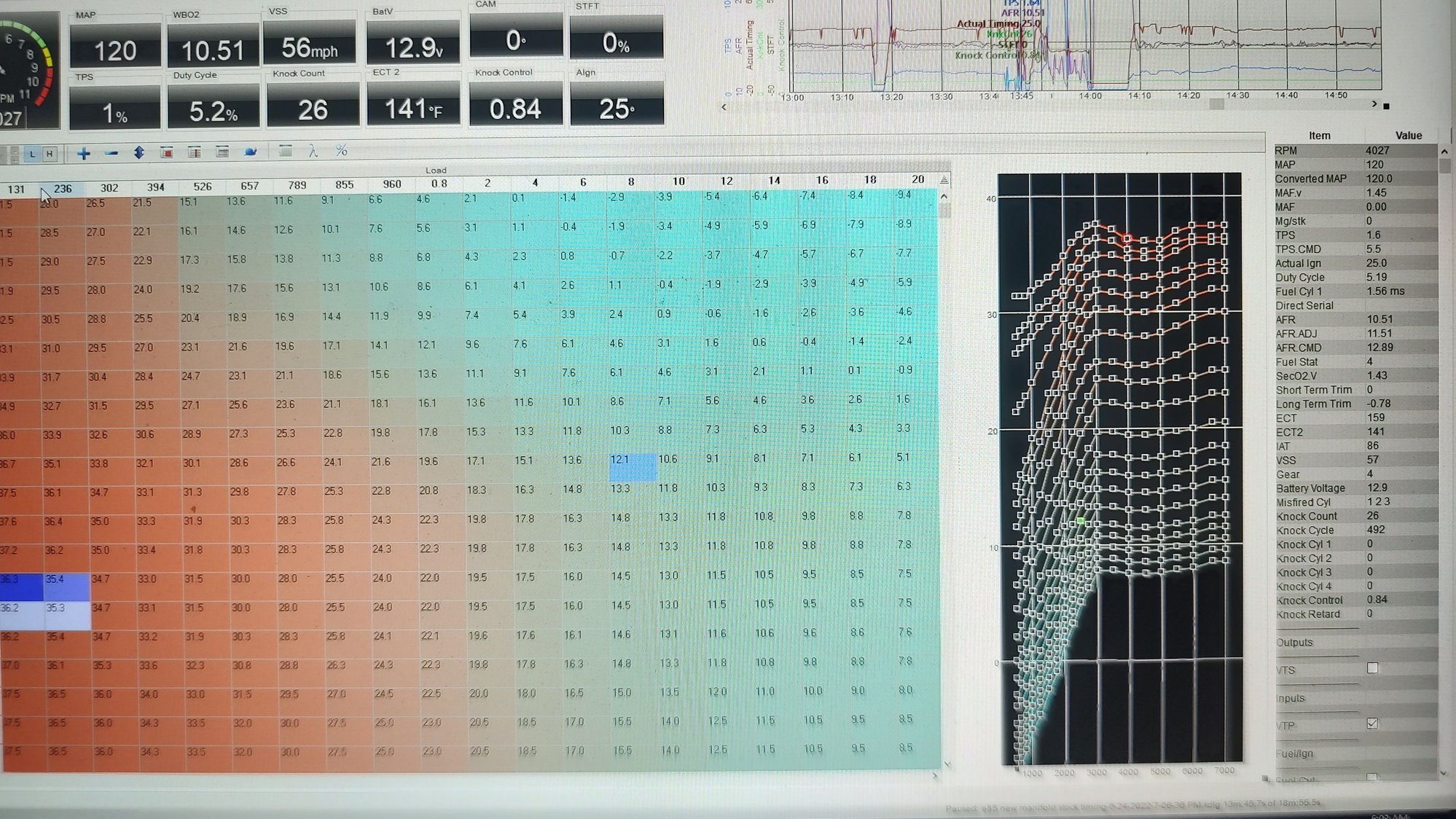

low cam ignition table
Hi cam ignition table
I wanted to post my ignition tables to show what's been working for me on e85
Knocks are from deceleration, from what I have learned this is okay when off throttle

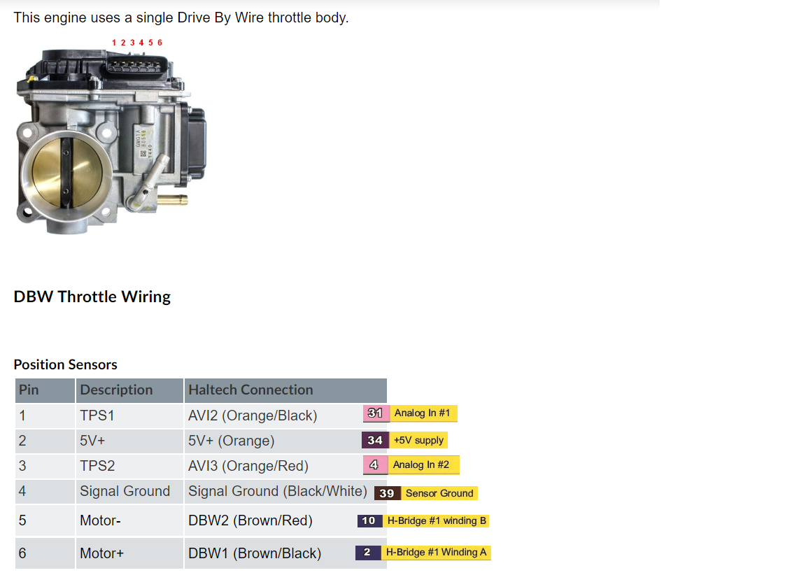

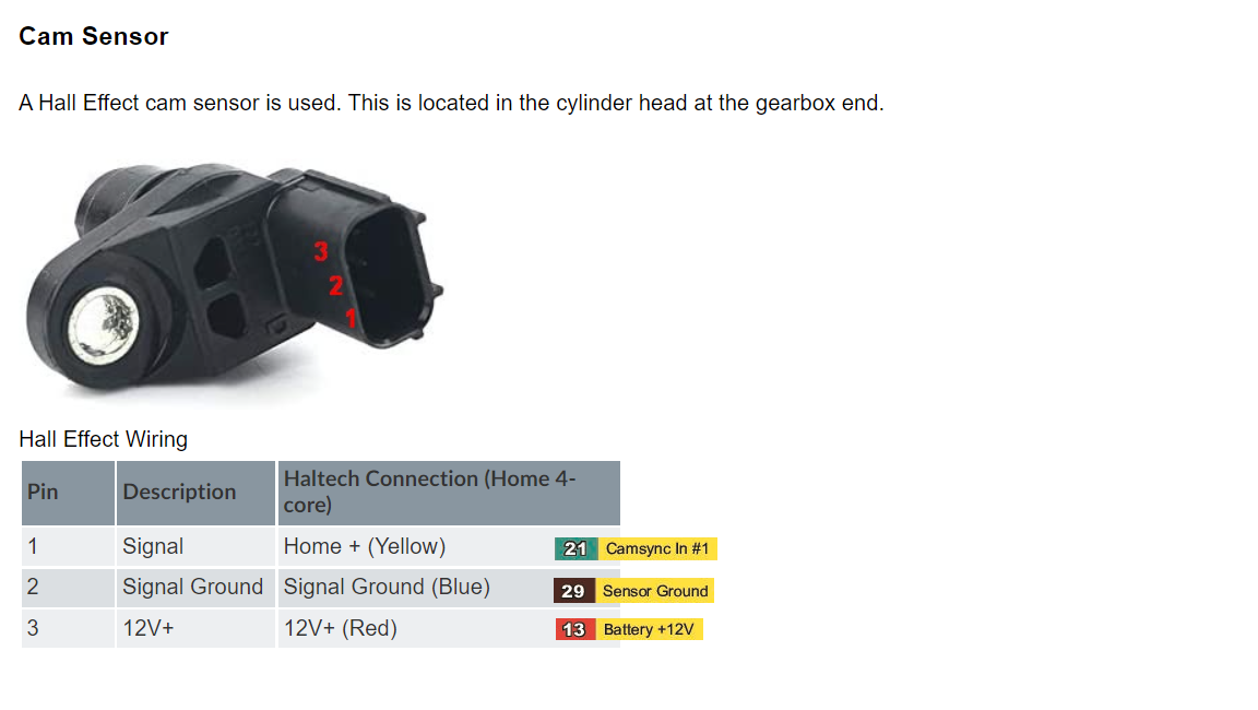

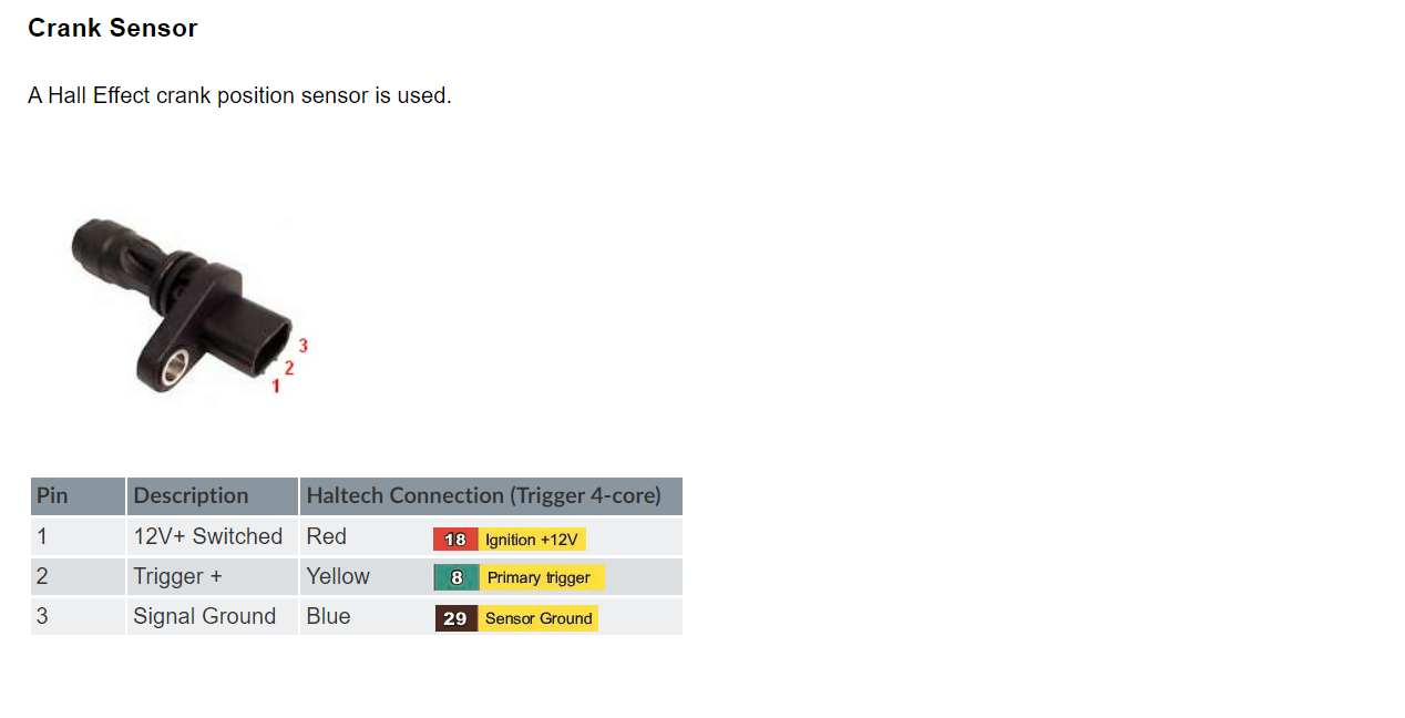

I found information on Halttech's website, engine sensors and also the wiring diagrams to get any standalone all wired up. Have fun!
