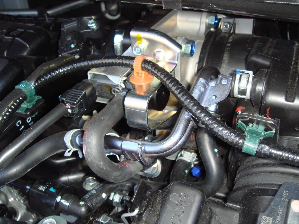

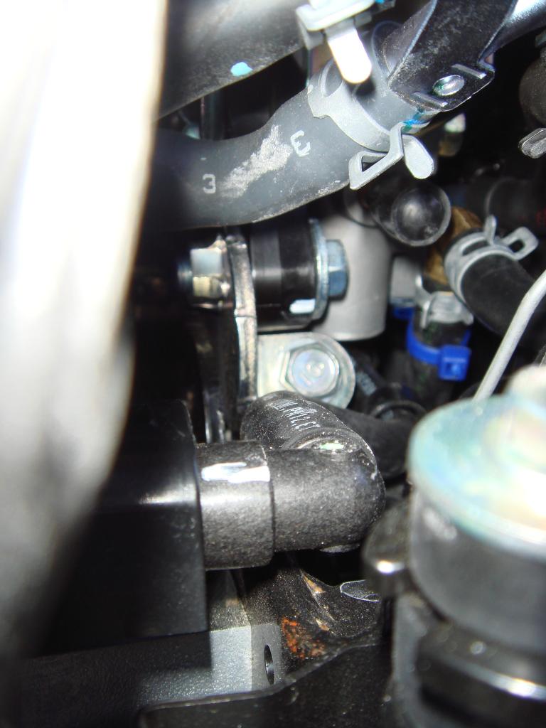

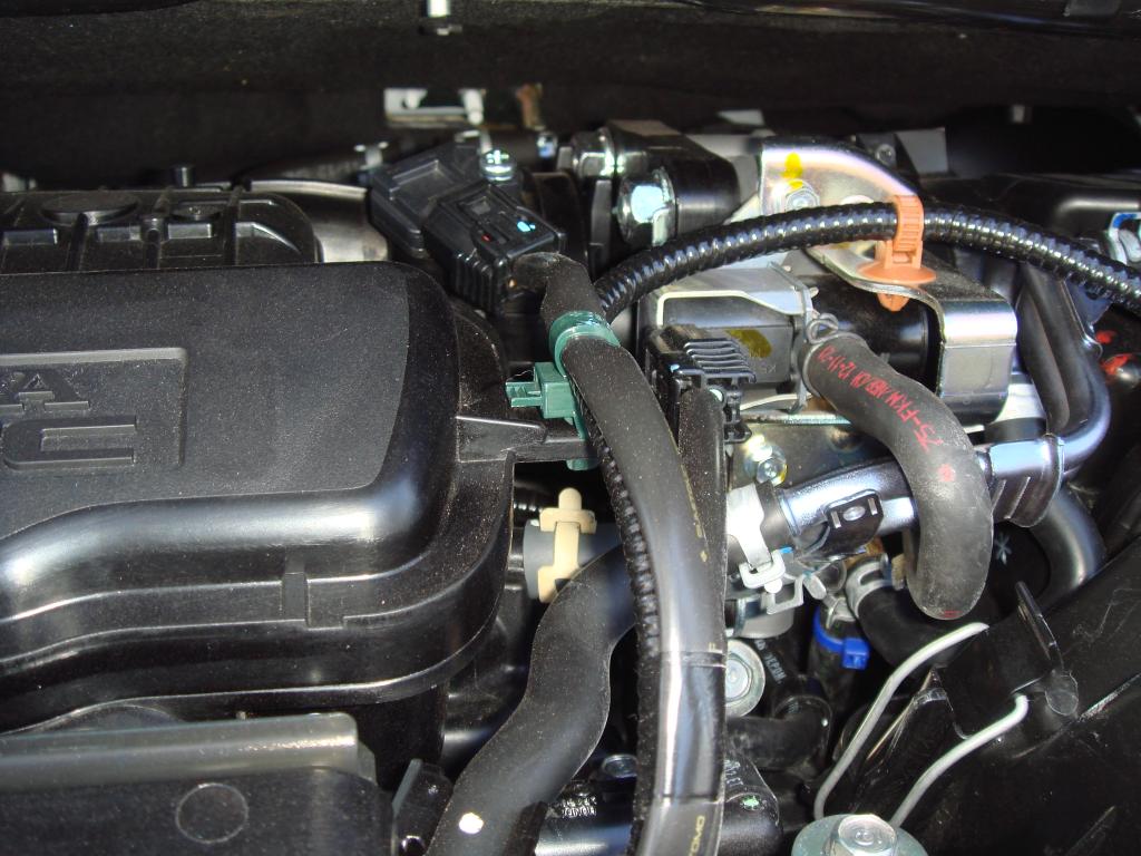

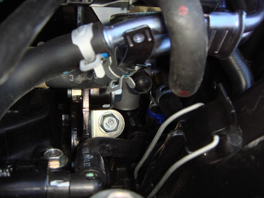

Finally Took Some Pictures Today,
The ByPass were tied with the Blue Tie Lock, notice also the inlet and outlet
pipe on the Throttle Body were cap with Rubber Cap.
