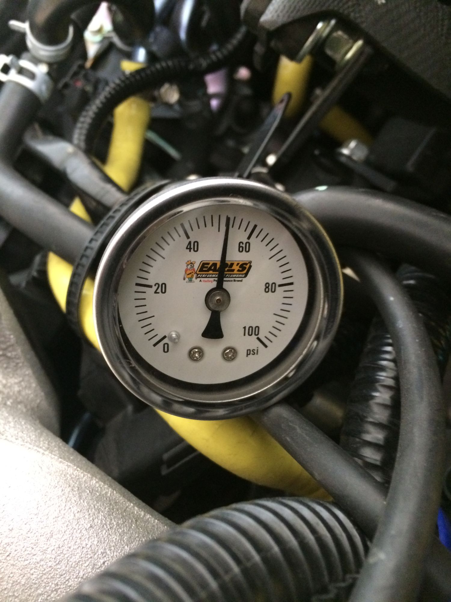

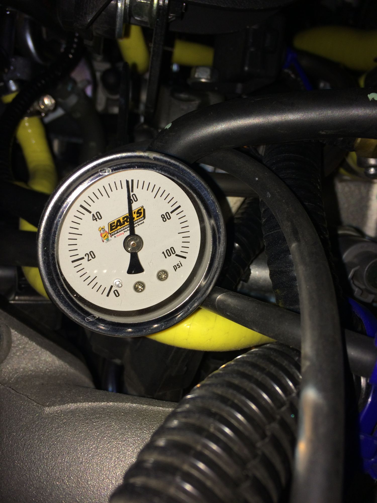

I once again check the current fuel pressure using the stock fuel pump
and it's stable at 52psi:

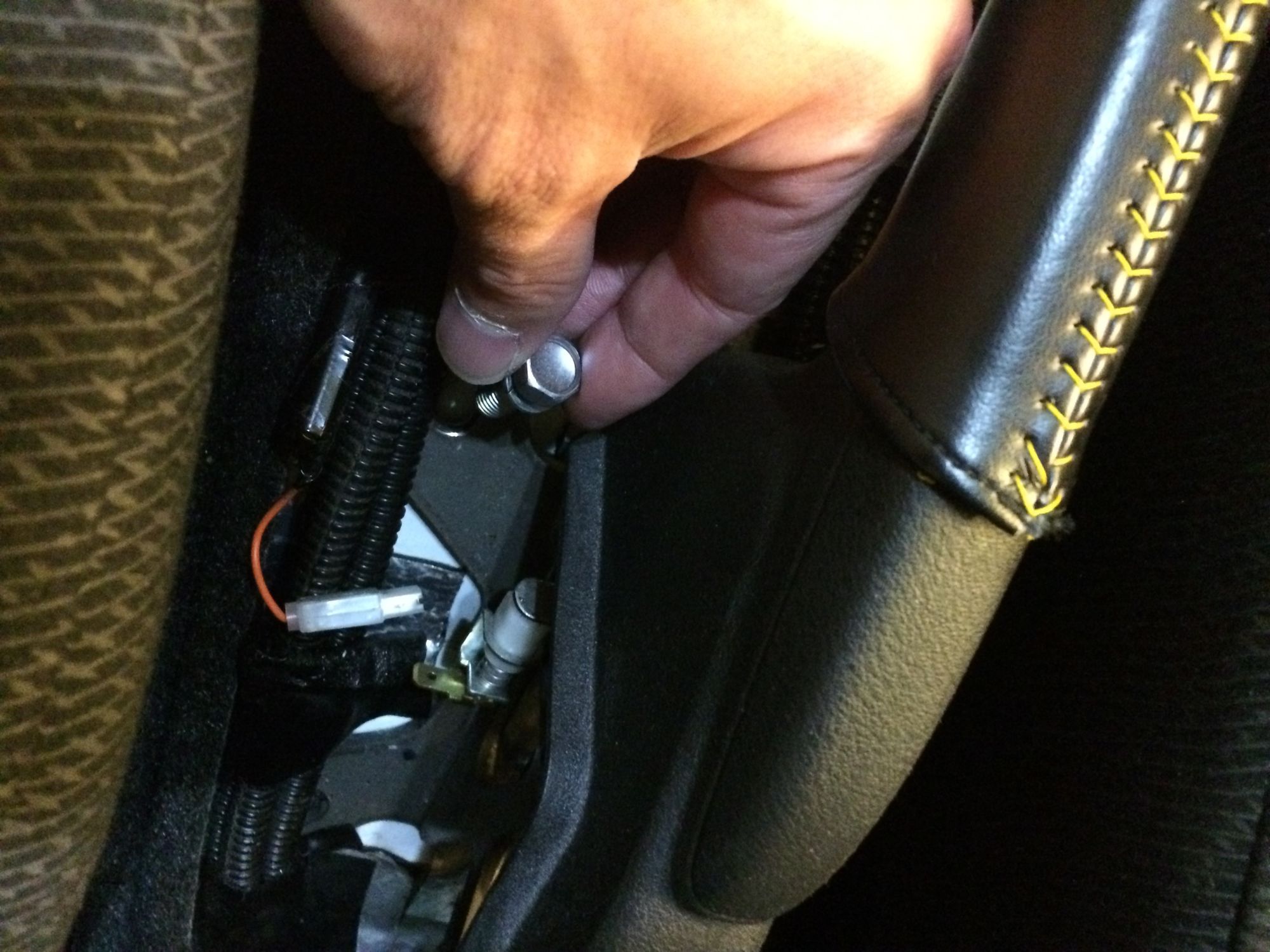

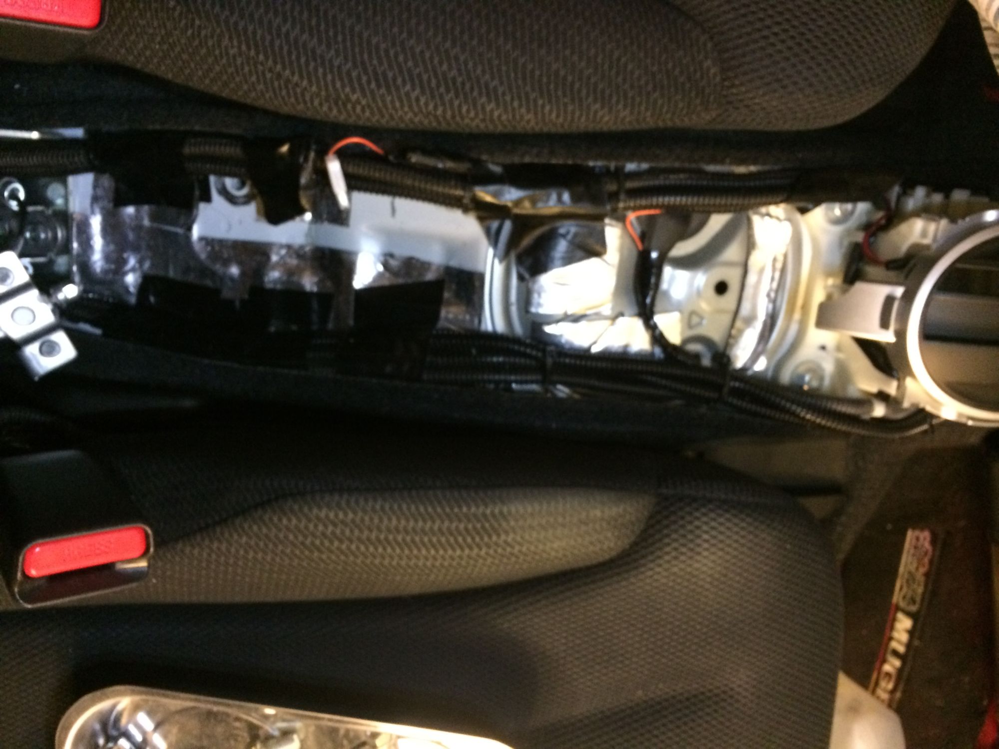

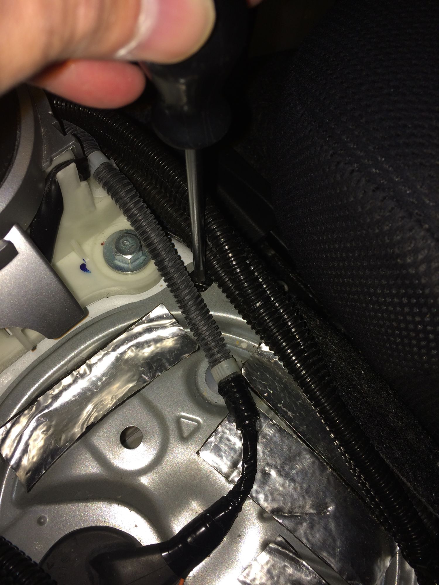

So I start the process by taking out the two bolts that hold the parking brake lever and move the parking brake lever out of the way...
Oh, I already had my center console removed this past few months because
I cover the center console in leather and yellow stitching otherwise I need
to take out the center console before I can access the fuel pump opening...
Then I need to turn counterclockwise on all 4 plastic bolt that hold the
fuel pump cover...

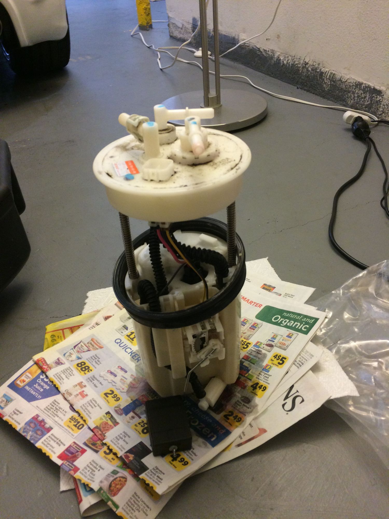

then open the cover:

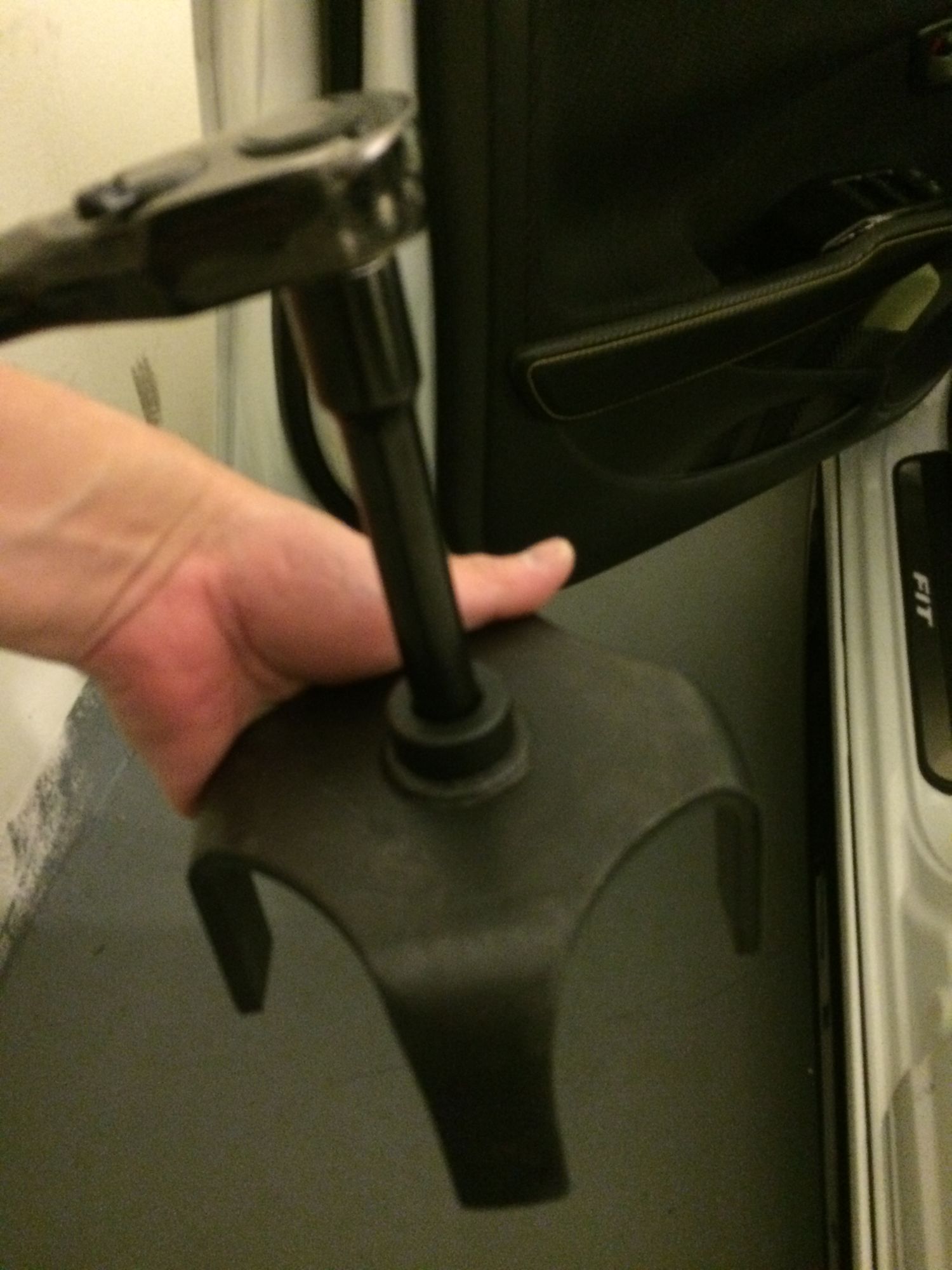

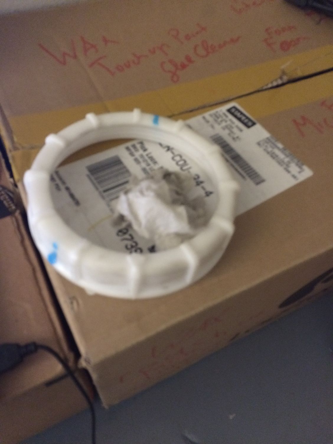

after that, use Honda Special tool to open the giant plastic ring/nut
that hold the fuel pump cage in place:

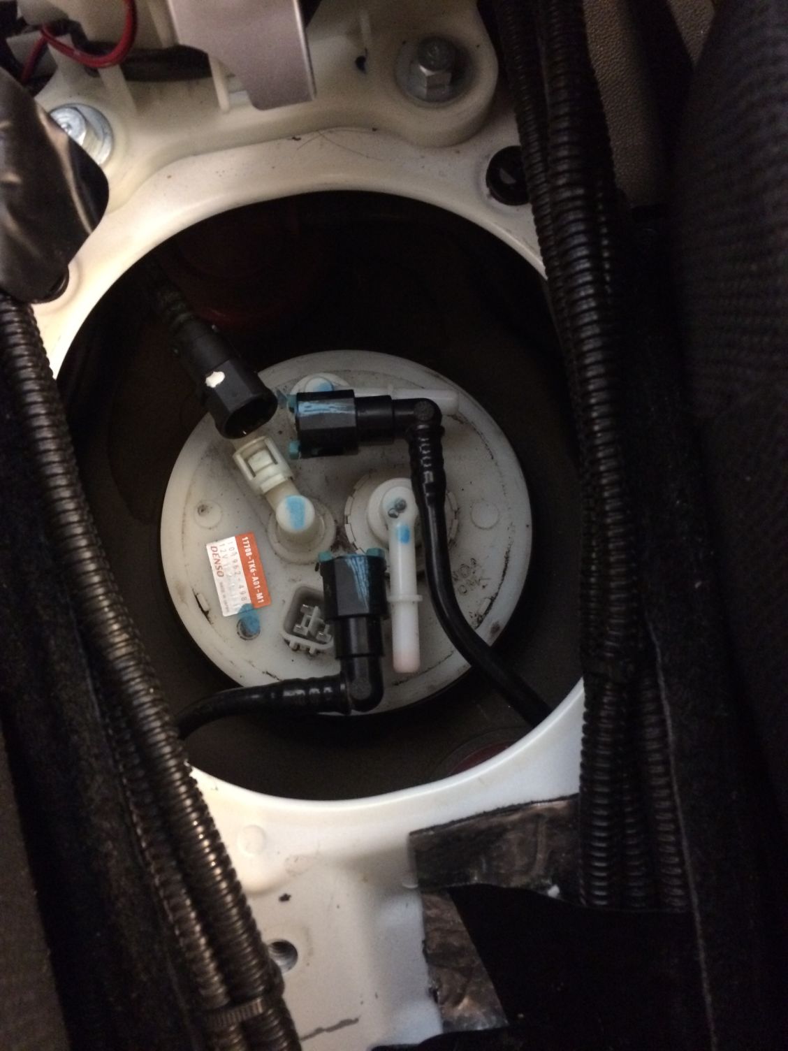

After the nut removed:

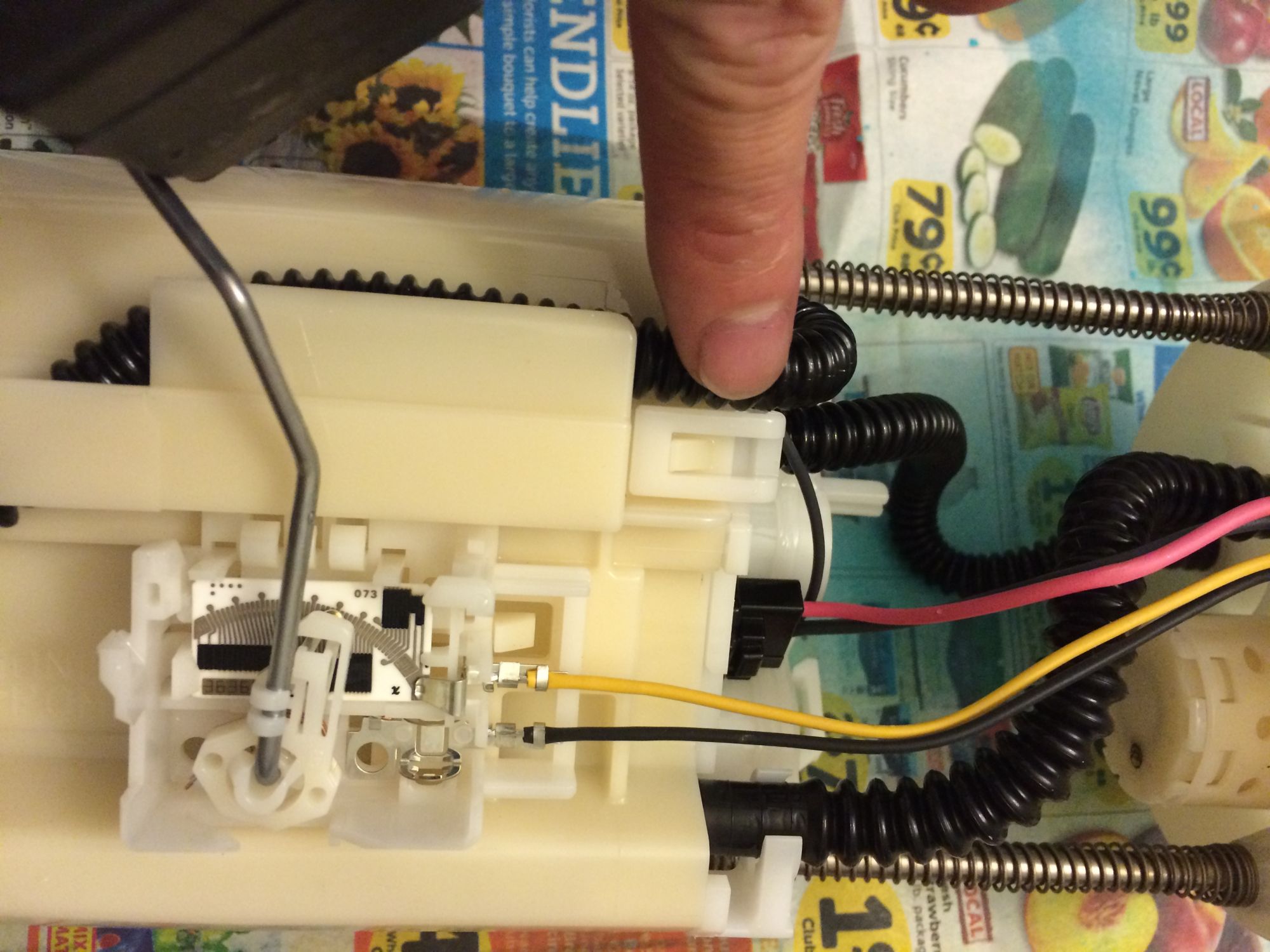

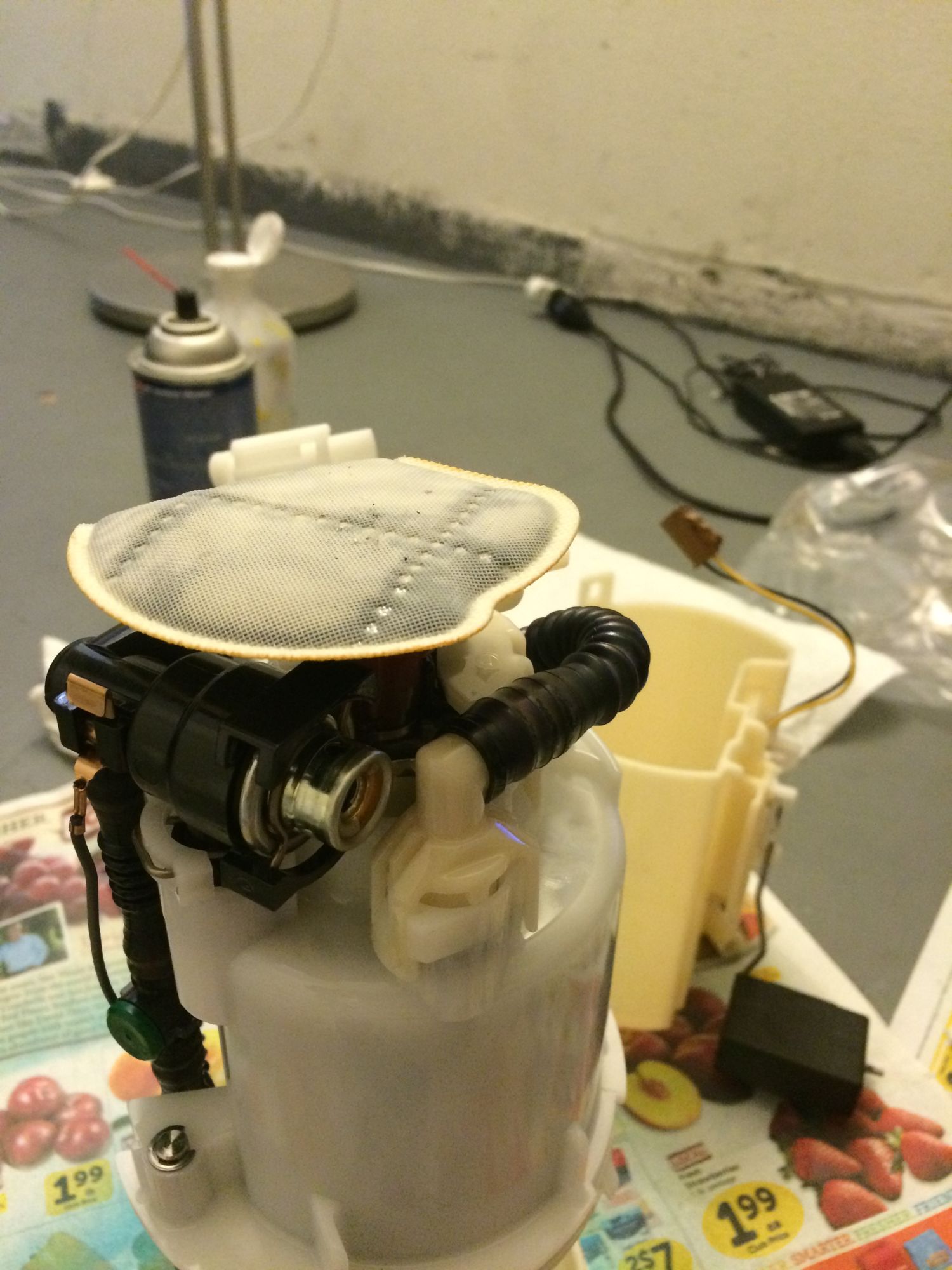

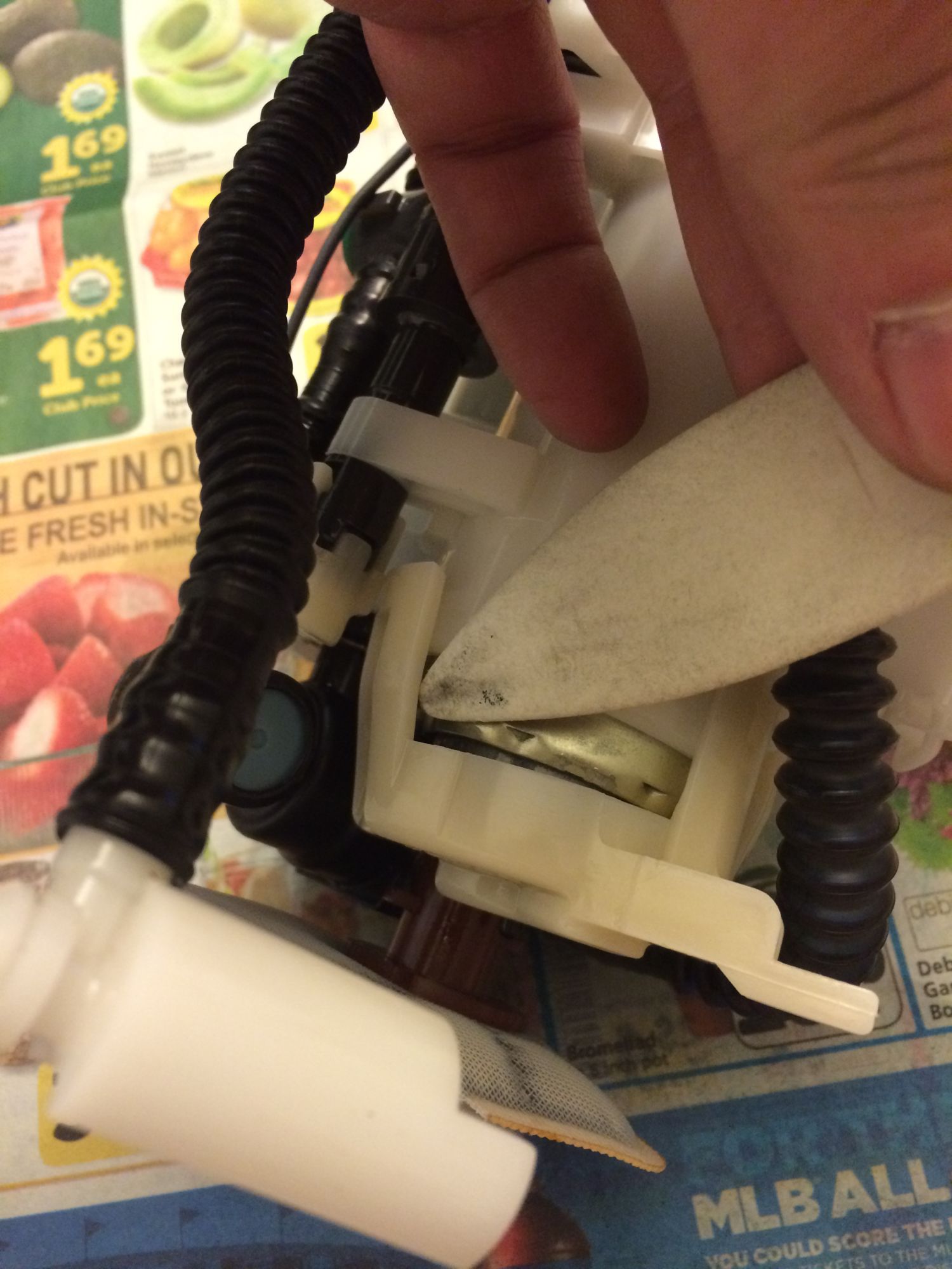

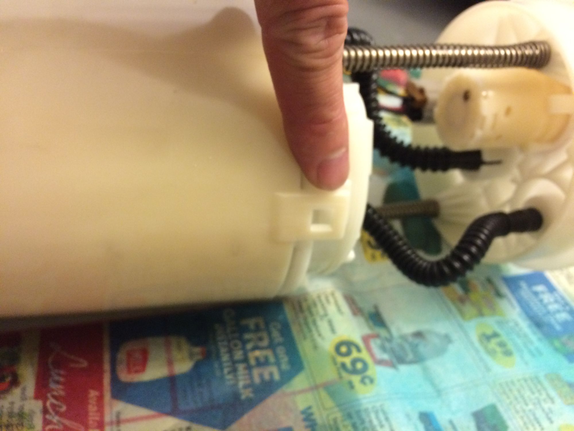

The Fuel Pump Cage assy:

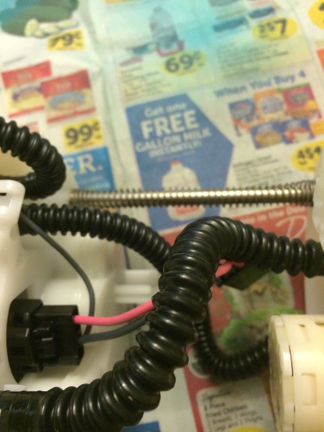

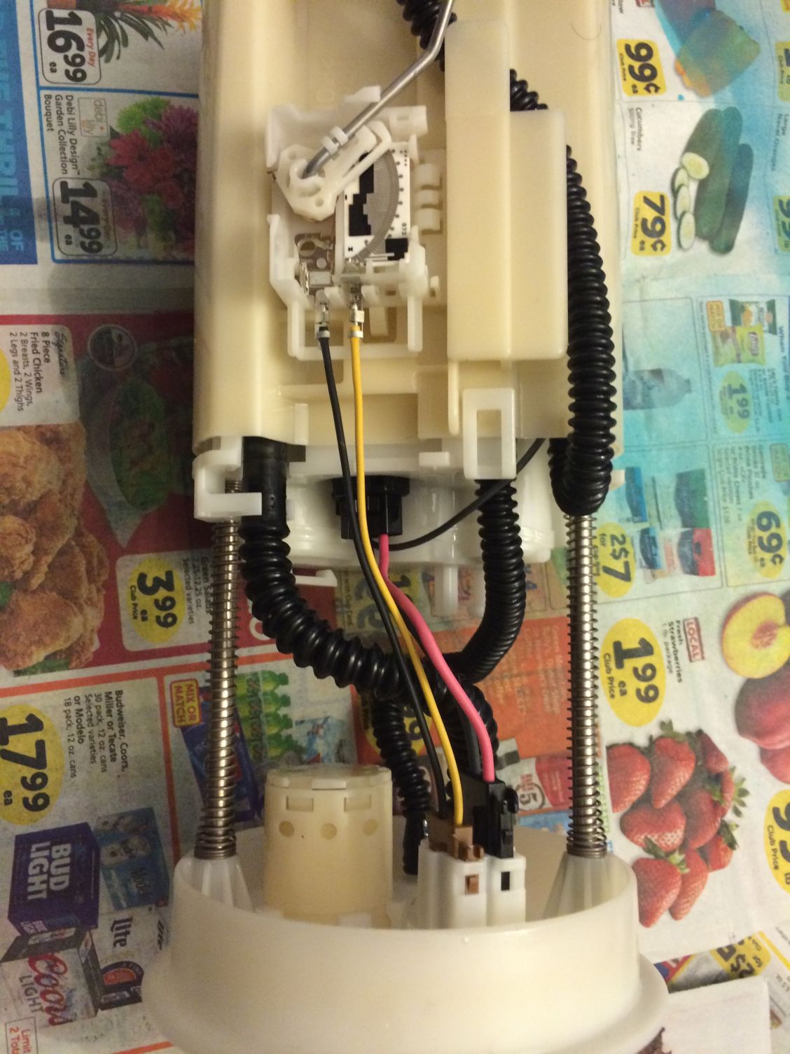

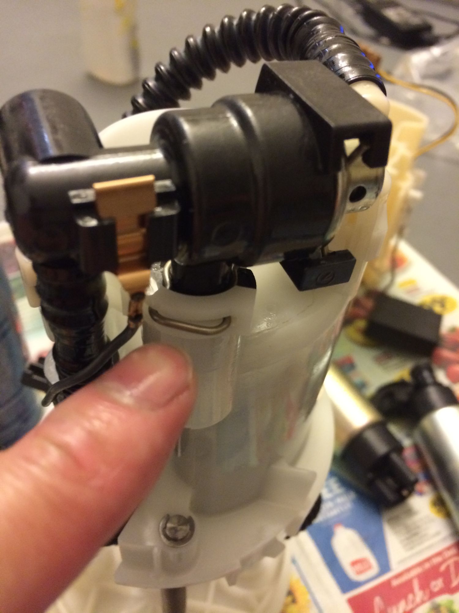

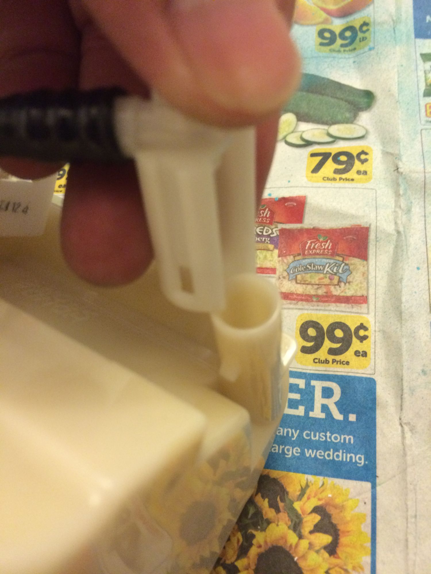

Remove the tabs and all socket connection:
After removal of the lower bottom cover,
we know see the exposed fuel pump with the fuel filter:

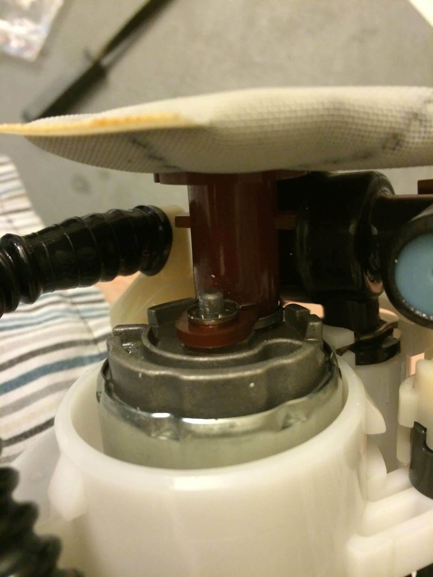

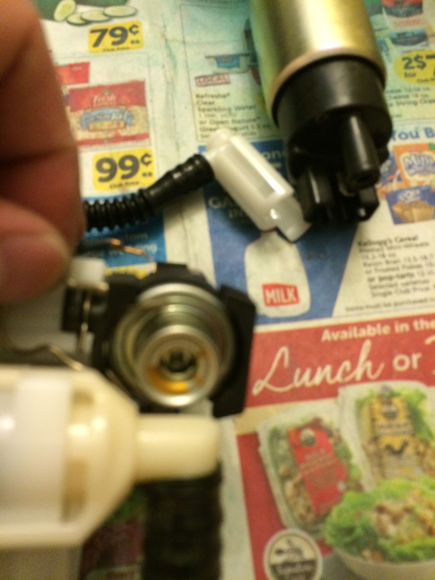

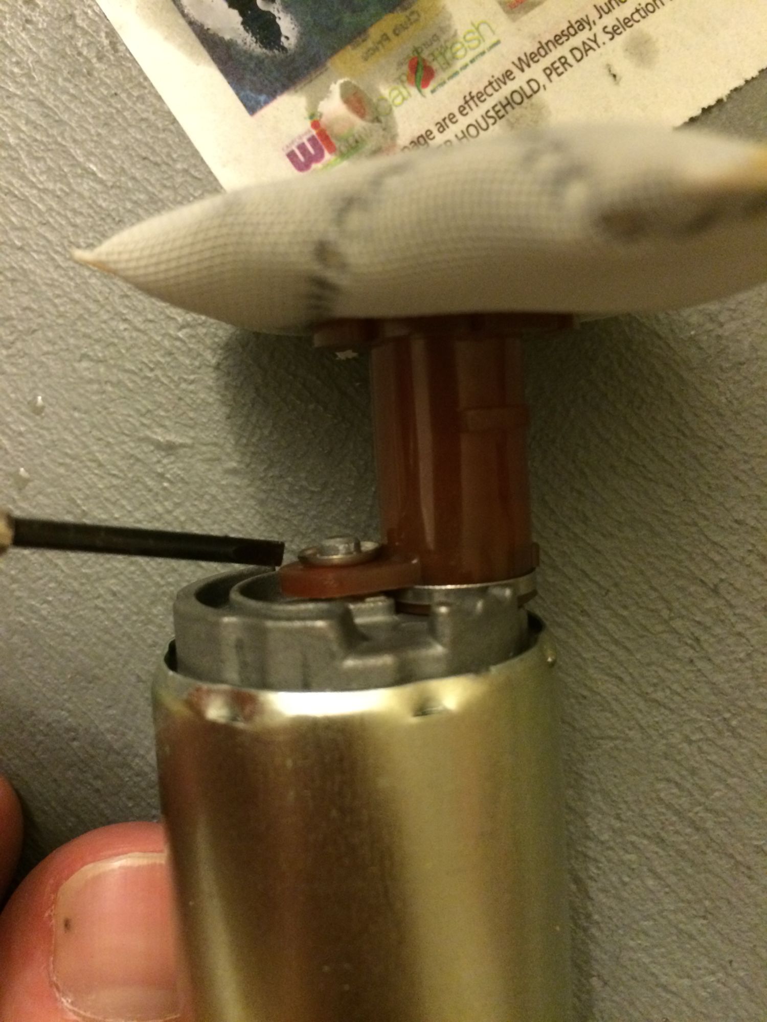

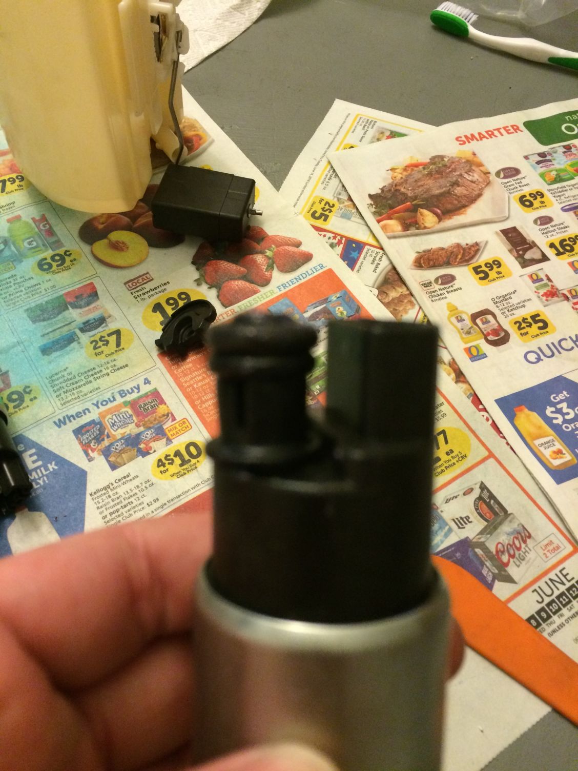

Remove the plastic piece that hold the fuel pump, then you can remove the fuel pump:

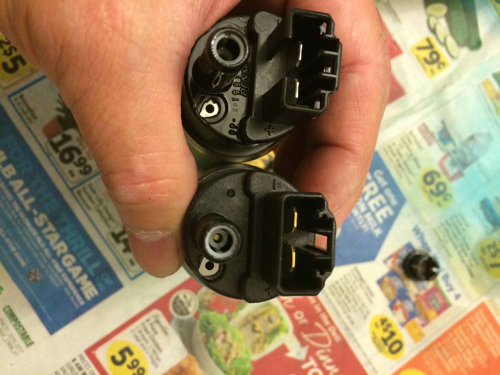

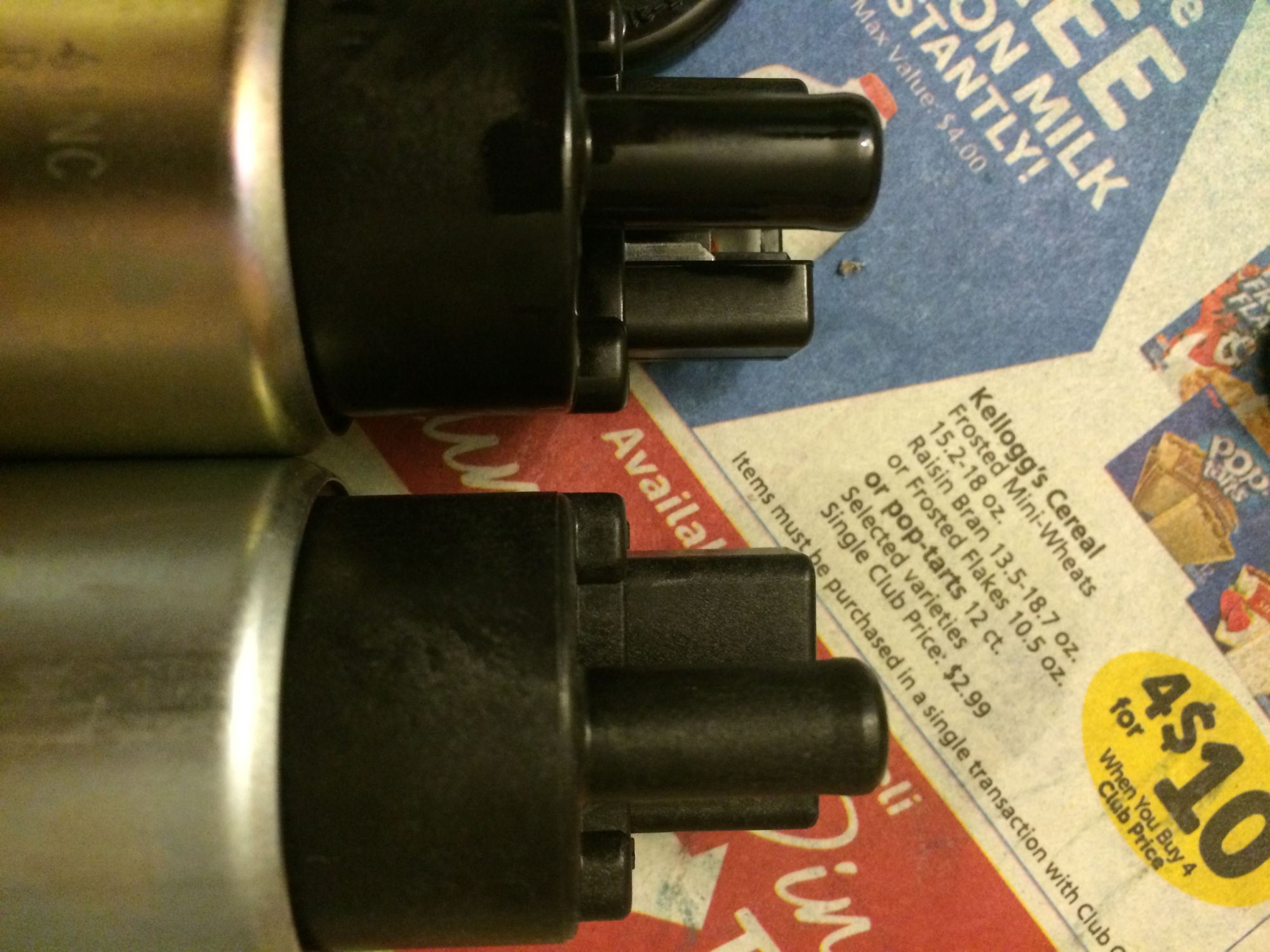

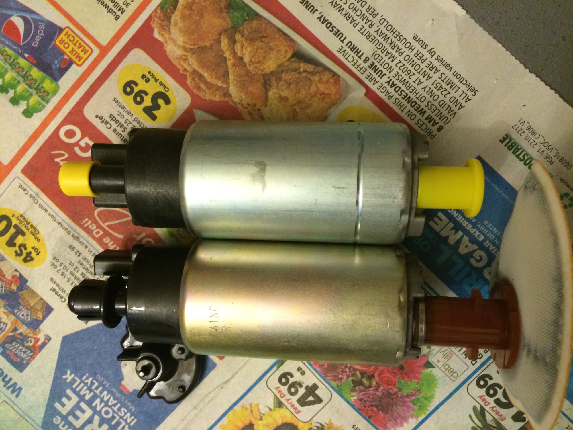

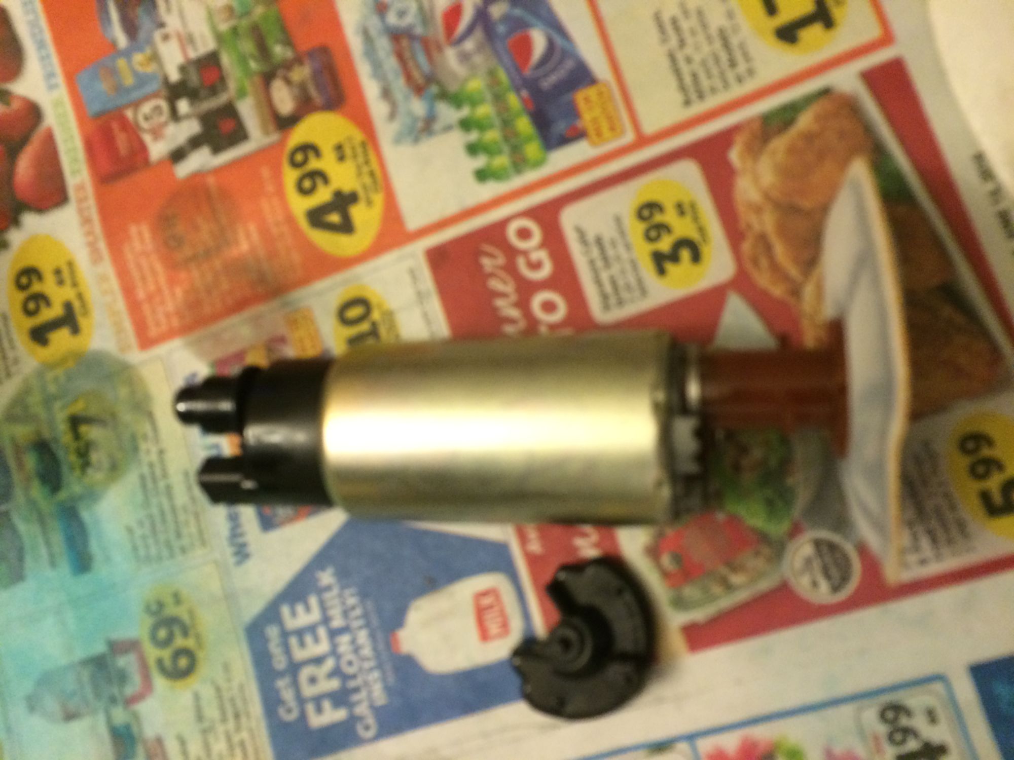

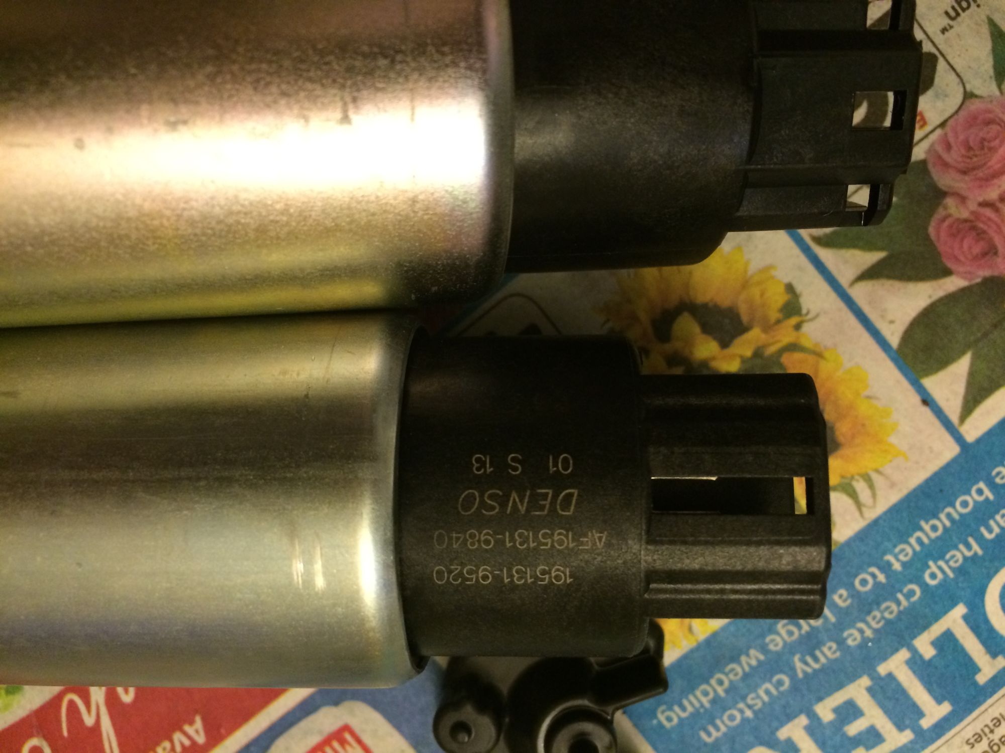

Now compare side by side between the old stock OEM HOnda Fit (yellowish color) and the silver color of the new Denso, the are exactly the same:

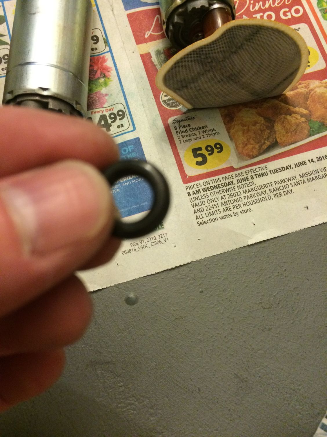

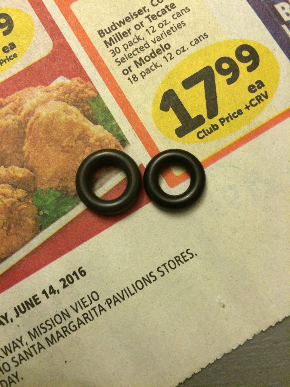

Move the o-ring SPACER from the stock Honda to the new Denso and put the new o-ring that came with the new Denso pump, I also reuse the old o-ring from the stock Honda fuel pump just so to make it double o-ring and more leak proof:

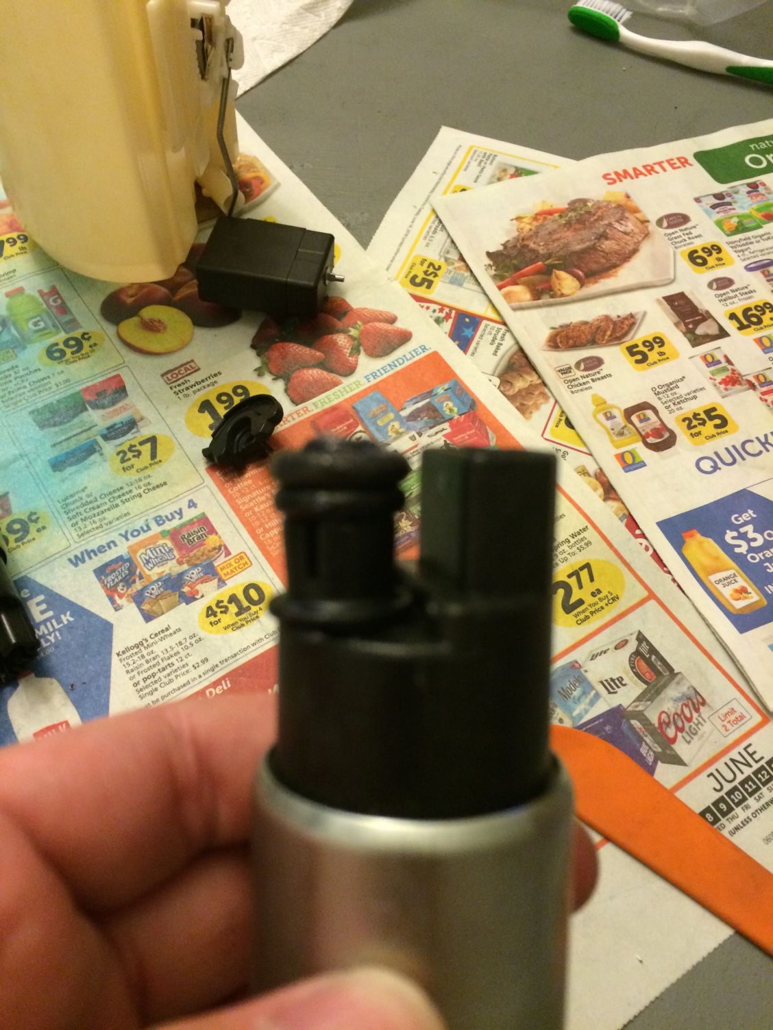

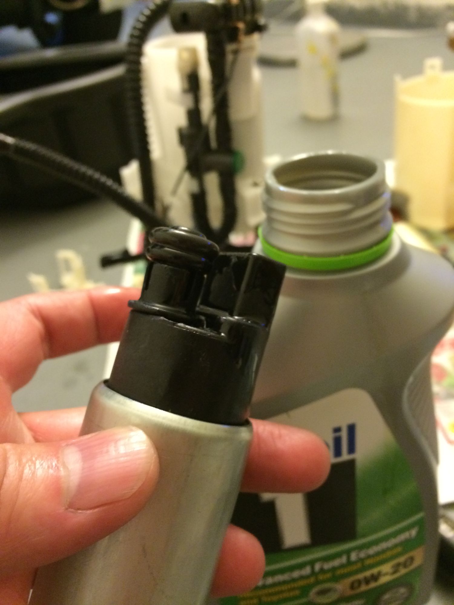

Use Engine Oil to lubricate the oring before install it back to the cage...

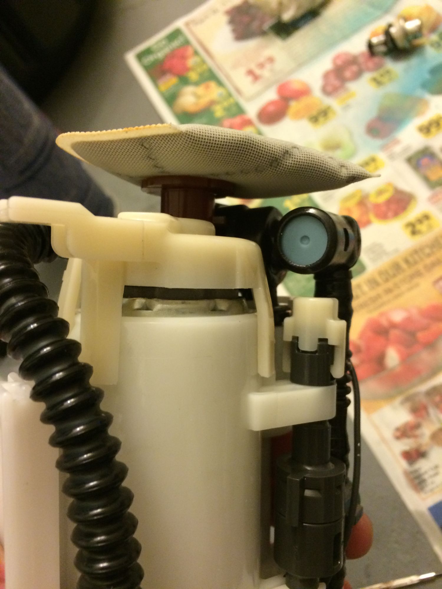

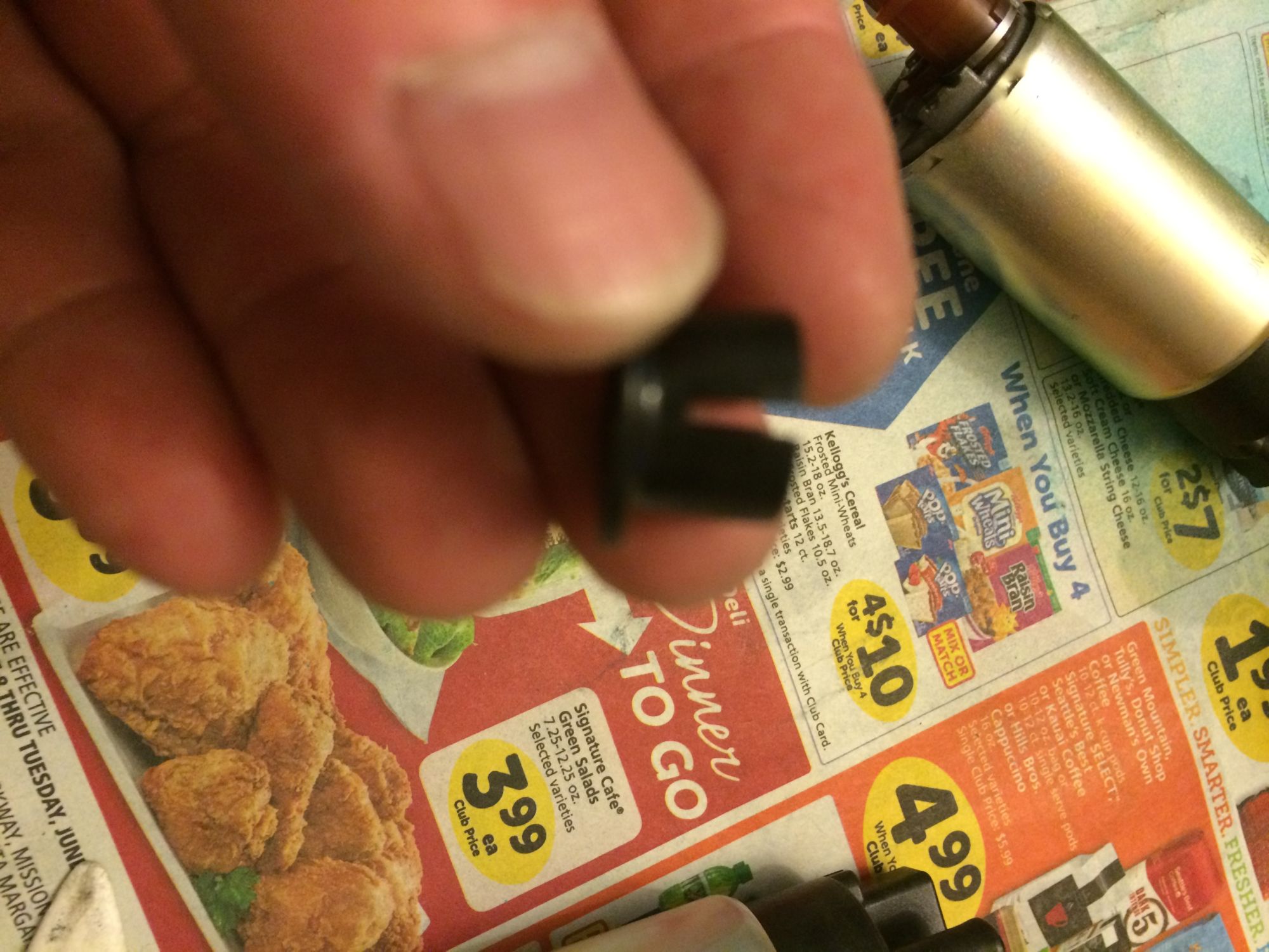

Oh, I also need to swap the old fuel filter to the new Denso because the fuel filter that came with the Denso is not compatible (face different direction):

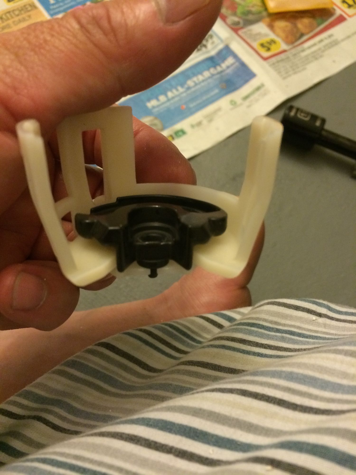

Also transfer the rubber cover of the old fuel pump, and push back the plastic holder of the fuel pump and you are done with the fuel pump swap:

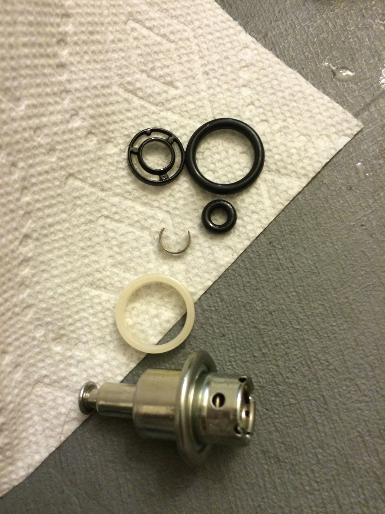

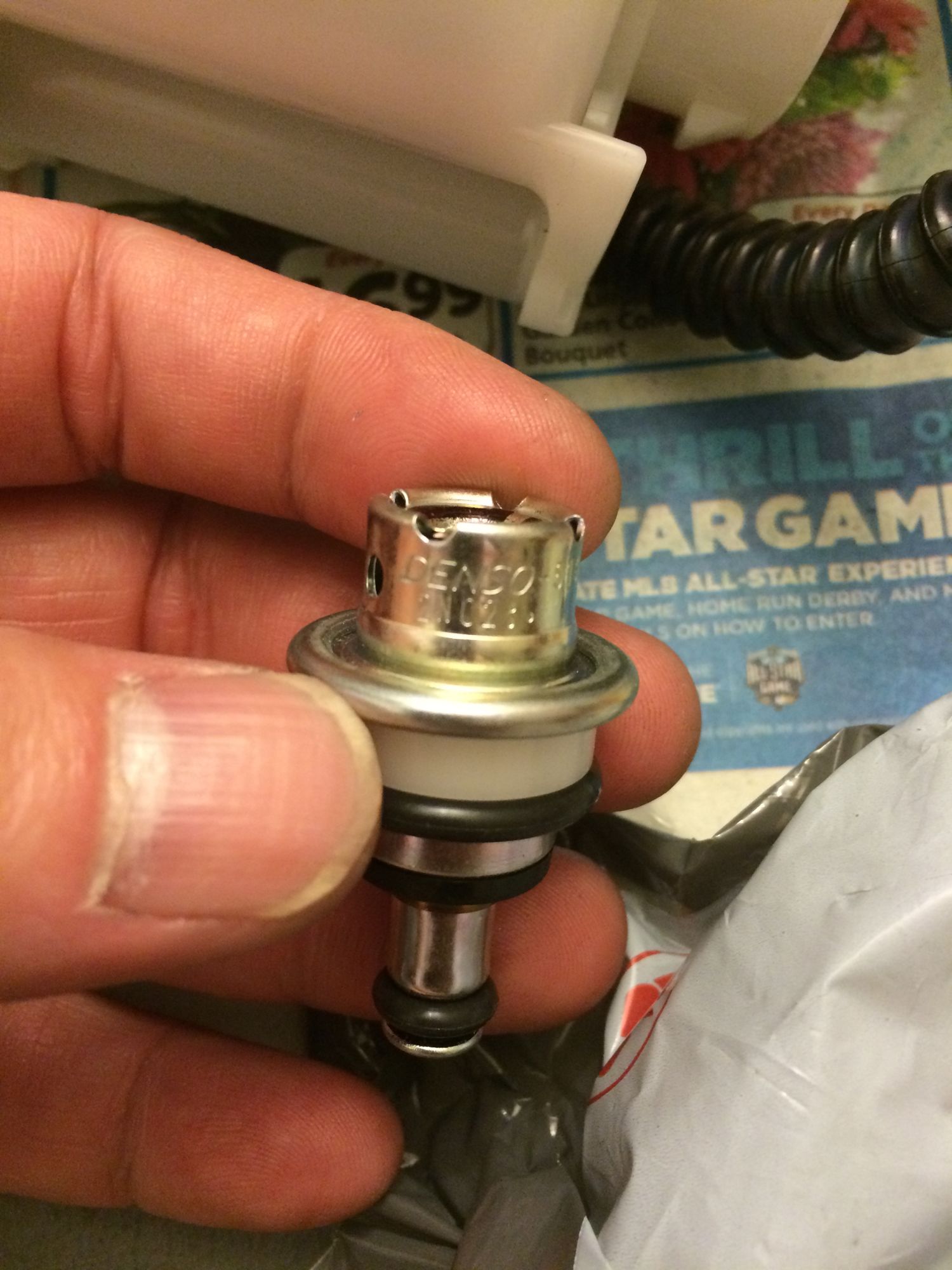

I also bought Fuel Pressure Regulator that came with the seal kit for Honda Accord who happended to have the same seal kit and that large ring nut and other gasket that we need...
but unfortunately the Honda Accord Fuel Pressure only have an inlet diameter of 2mm while the stock honda fit wth 2.65mm inlet diameter should flow more and allow for lower pressure, so I just transfer all the oring from this new fuel pressure regulator onto the stock Fit fuel pressure regulator and I am done.
by the way, removing the fuel pressure regulator is very easy,
just 2 metal clip holding the fuel pressure regulator assy and pull it out,
to install just reverse procedure:
Install back the fuel cage into the fuel tank and turn on the car,
and the pressure with this larger flow Denso is just 58psi...
so I decided it's still ok and no need for dedicated new fuel return line or adjustable fuel presure regulator..
