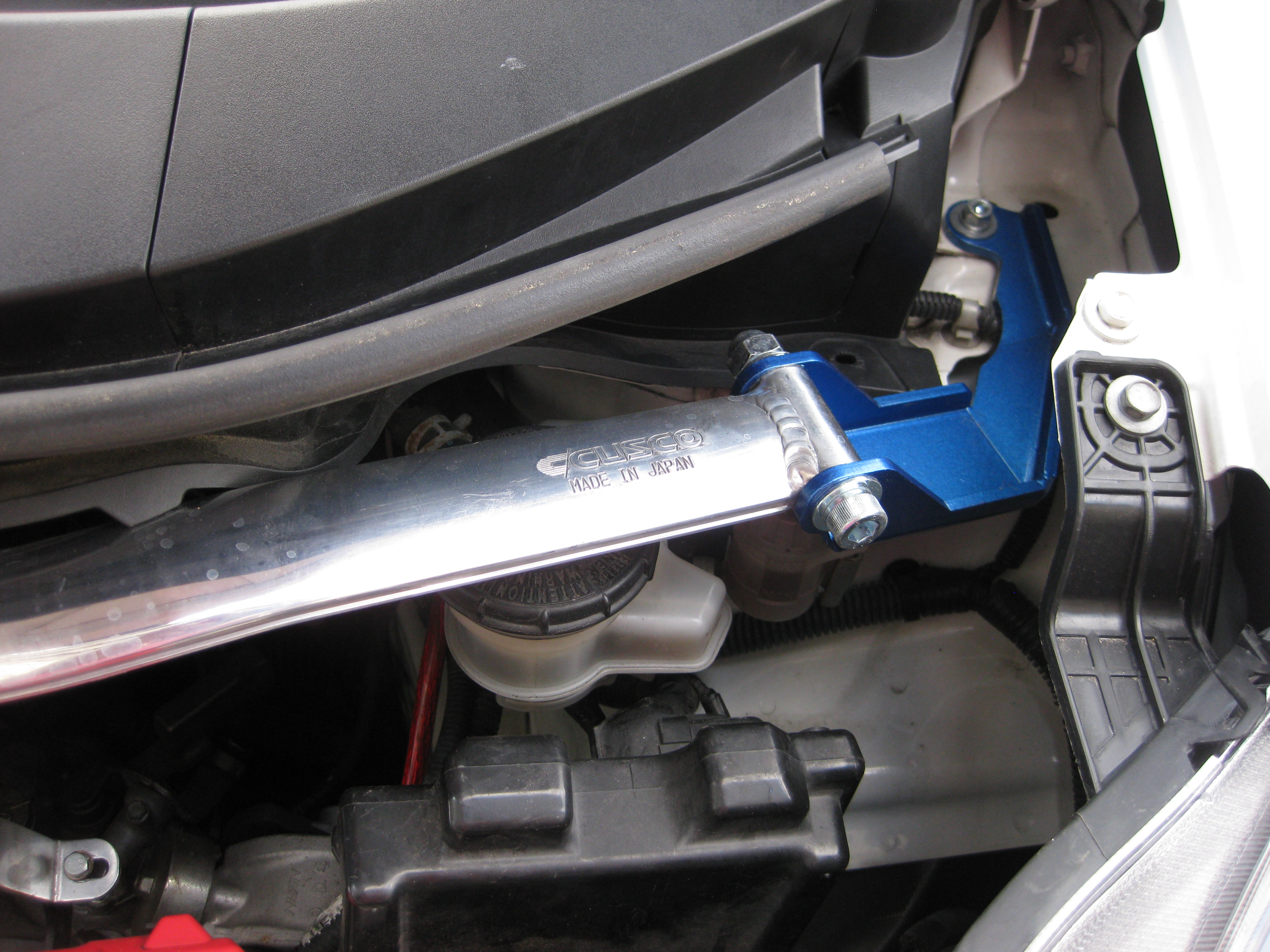

Well done and congrats Vash! I have a semi off topic question for you, It’s about the Cusco front strut brace. How did you get everything to fit correctly? When I installed the brace it pushed the whole cowl up too far for the hood to close. I followed the instructions and removed the “air tunnel” rubber as directed. I have a full Sprintex kit to install so I’m concerned about fittment of the whole package. I purchased some metal wedge shims but uncertain about the whole thing. Looks as if yours fits with no issues. Also, what size coupler did you use? Would like to get one for my supercharger prior to install.
here is a pic of where mine is bolted up, I have it bolted on top of the hinge of the hood mounts, the hole closest to the front of the car:
