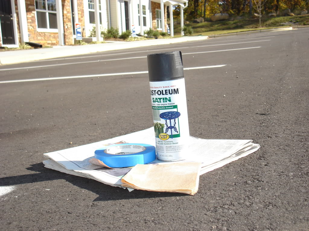

Tools used:
Painters Tape 3/4th inch
Rustoleum Satin Black (kinda like a flat black color) I did about 3 coats, a few minutes apart from each other, just like the directions on the spray paint can.
News Paper
Sand Paper

heres what i used:

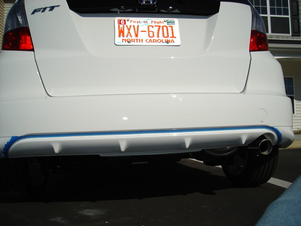

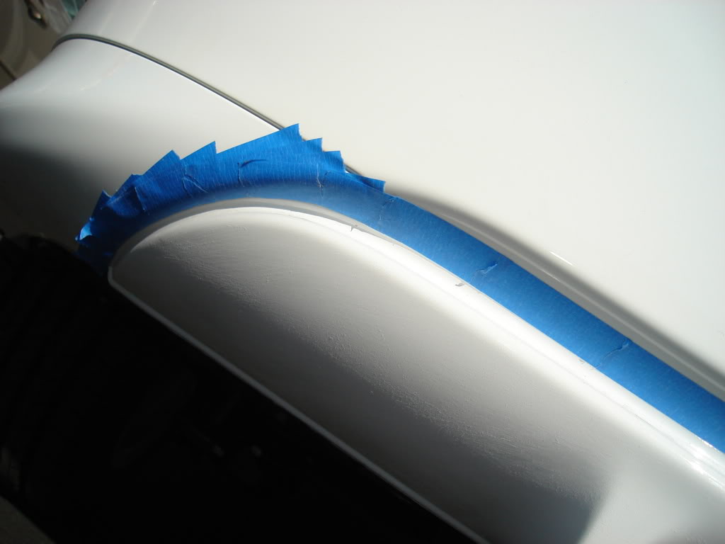

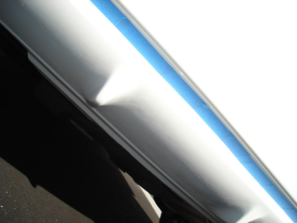

prep (taping and sanding surface to be painted):
that blue tape is painters tape.. beleive me i done it before without painters tape and alot of the paint will come off when you pull off non-painters tape after painting

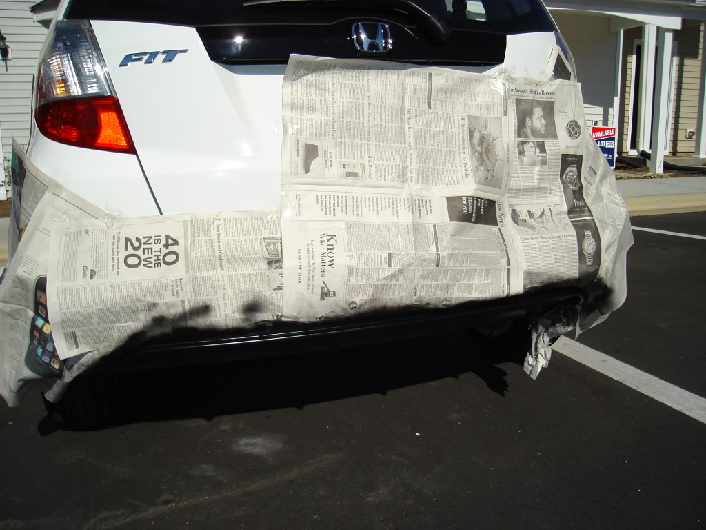

spray:

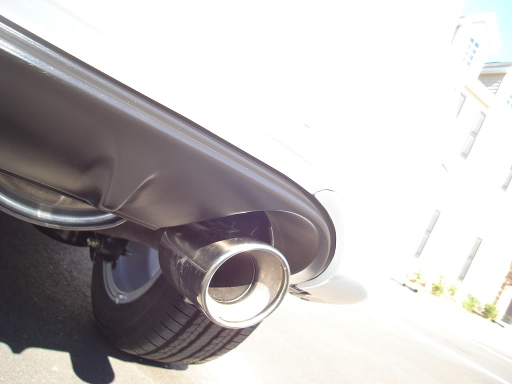

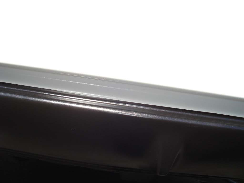

results:

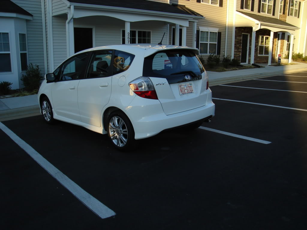

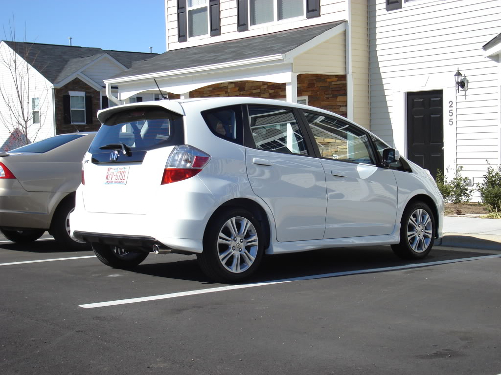

whole car results:

Nice Mustangs ............... The reason for sanding is it cuts a tooth in the surface for the paint to bond into. If your spaying a color coat then the sandpaper should have a high # if your using dry paper 240-320 grit but if your wet sanding then you can go even finer 600 grit then clean the area with a paint prep to eliminate fisheying and spray away!
And you are right Vash with the thought that too many coats or to heavy a coat is better, it's Not! When sraying wether it's a rattle can or a HVLP gun you look for the moment that the coverage (paint) "just flows out" and stop!! You have to be looking at the correct angle with a good light source, and the first coat is called a tack coat this is really important, it's not meant to be a finish coat. The tack coat is lighter (less material/Paint) and is sprayed on the surface to hold the gloss/finish coats.
I know,I know it's that I've been painting stuff for years and years and I just was going to say Nice Job there Vash, Great visuals for 5 bucks and 2.5 hours. Good Work!!
