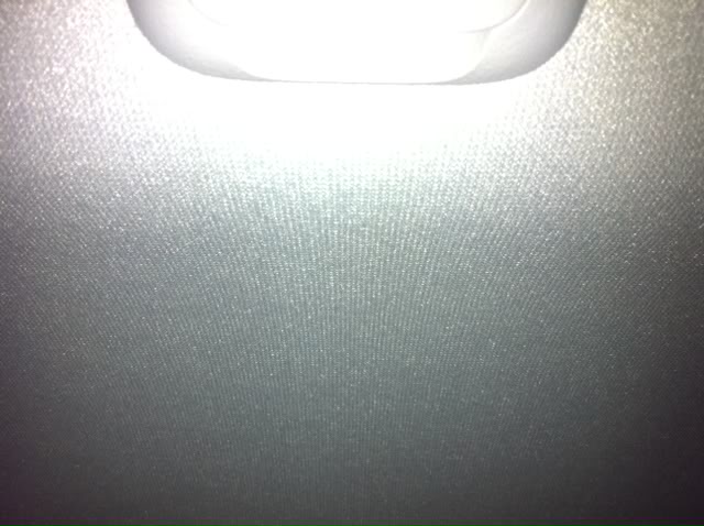

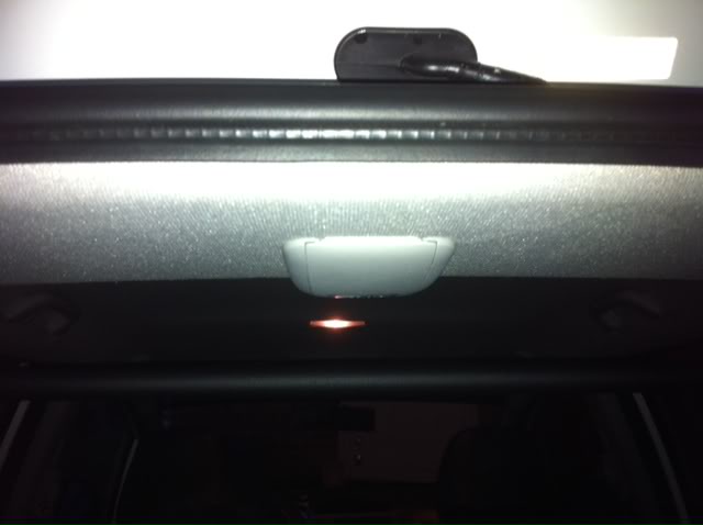

Ok here's where I went in...there is a clip behind the door of the latch hook cover.
This is right about where the wire is for the antenna
There are 2 lock pins on the clip, it doesn't just squeeze and come apart
The lock pins are dark grey where as the clip/connector is lighter grey
Here is the area where there is some sort of sliding clip. I never could see it, just feel it. Felt like there was electrical tape around the wire and then it was slid onto a clip shaped like a u. The clip bent enough when I pushed the wire forward towards the front of the car but did not break. I did not put it back on that clip when finished.
Here is about where the bolt is...again, 15mm...but it would be easier and probably cause less strain on the headliner if you used a ratcheting box wrench.
Does that help?
