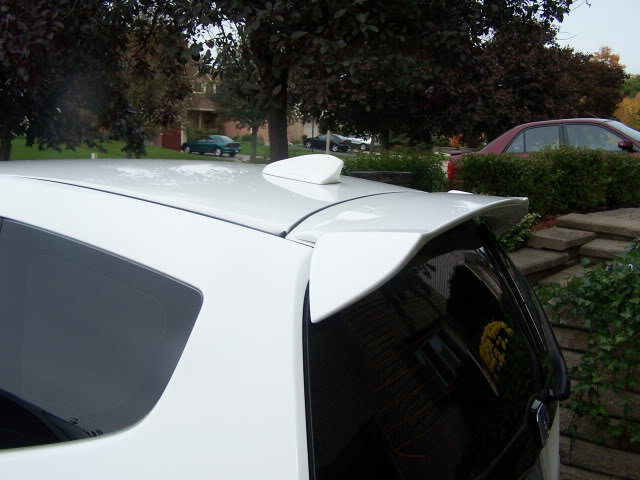

Question Is there a DIY for taking off Rear spoiler?
Ordered a CF rear spoiler, is it just like the civic hatches?
Anyone know of a DIY?

if its anything like the GD spoiler. Take a small screw driver and pop a cover off on the top of the spoiler on each side. then remove the bolt and the wing should lift right off.

Thanks got it off heat gun to release the 3M and just popped the plugs out.
