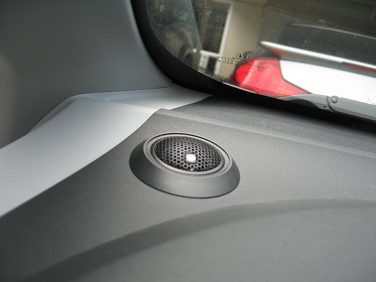

Did you want the tweeters to fit behind the factory grills? My installer had to dremel the grill portion of the factory tweeter so that the Rainbow tweeter would fit inside. It doesnt look completely stock anymore but I think it looks pretty good.
Yours looks just about as perfect as I could imagine! I don't care about keeping the factory grills. At this point it's just an issue with committing to my A/D/S component set which doesn't really fit my car (5.25"). Plus, running all new wires out to the massive crossovers they require would be a relatively large project for me - and I would have to buy a nice amp for them real soon $$$.... If I had a matching 6.5" component set (even with domes) I would definitely consider it, but until then I may have to run stock for a bit and sell off the A/D/S set....but I'm on a bad site for selling 5.25" speakers! Might try Craigslist later this week...

That Rainbow tweeter install looks nice.

Those are the stock tweeter housings (which you are missing if you have holes in your dash) that have been modified to fit the Rainbow tweeters.
