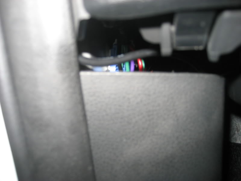

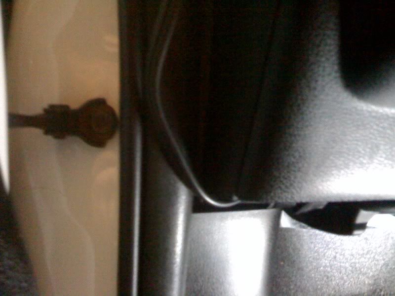

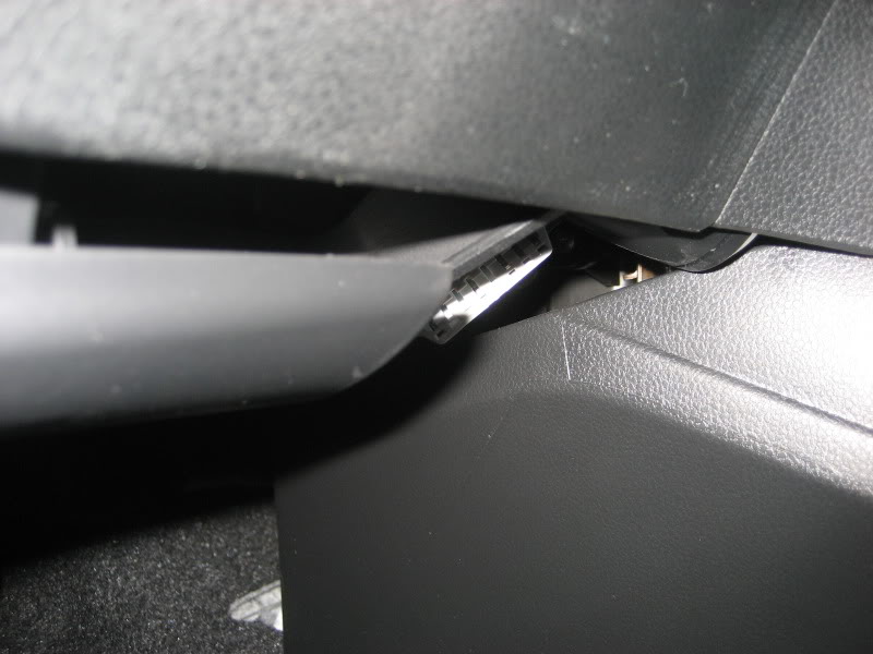

Old Dec 25, 2009 | 10:41 PM
kiggs's Avatar
Posts: 31
Its funny you have that setup- I have a nuvi 265tw and I keep it in the same place- but, I pushed the wire into the gap in the trimwork under the steering wheel.... gimme a bit and Ill take some pics.

Old Dec 27, 2009 | 03:05 AM
Nighthawk_GD3's Avatar
Posts: 213
From: Fairfield, CA
This may be a dumb question, but in looking at the add-a-fuse it looks like they all have just 1 wire coming off. Can you elaborate on how to hardwire a gps with add-a-fuse? Also to do this would i just cut off the 12v outlet that it came with?
Old Dec 27, 2009 | 11:39 AM
kiggs's Avatar
Posts: 31
Um, im actually kinda stuck there- For my birthday, my girlfriend is going to have it hardwired, (best buy does it for $50, and since they wired my bazooka sub, im pretty happy with it) and Ill see what they do to it, and let you know. Im just going to purchase another 12v dc cable in case I need to move the unit from car to car.
Old Dec 28, 2009 | 05:36 PM
Vash's Avatar
Posts: 1,053
From: North Carolina
Edit:
Got some pics (iphone, sorry)
sorry i haven't checked this in a while i did the same thing! i'll post more pics of what i done tomorrow. i have a VERY simular setup as you but i didn't tuck in the wires untill after it crossed the stearing wheel. i'll get out tomorrow and try and tuck it in from the side like you, i hope it turns out ok

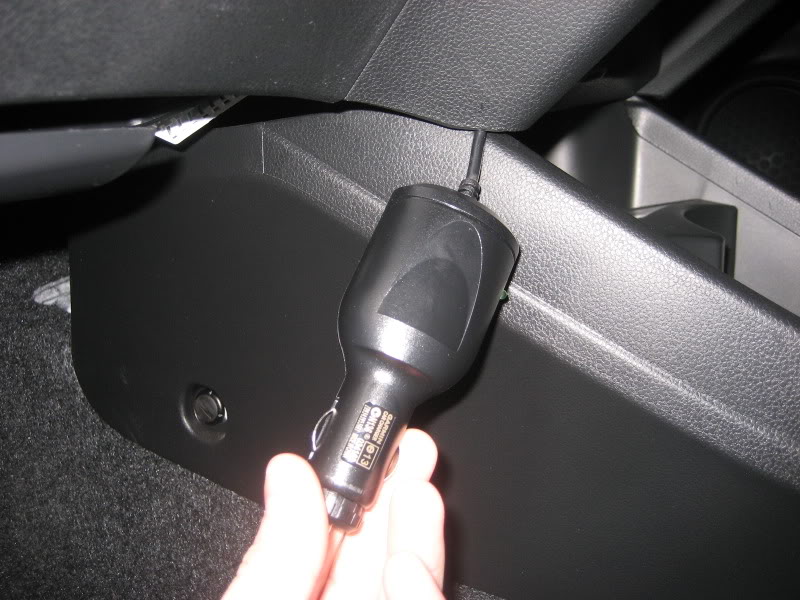

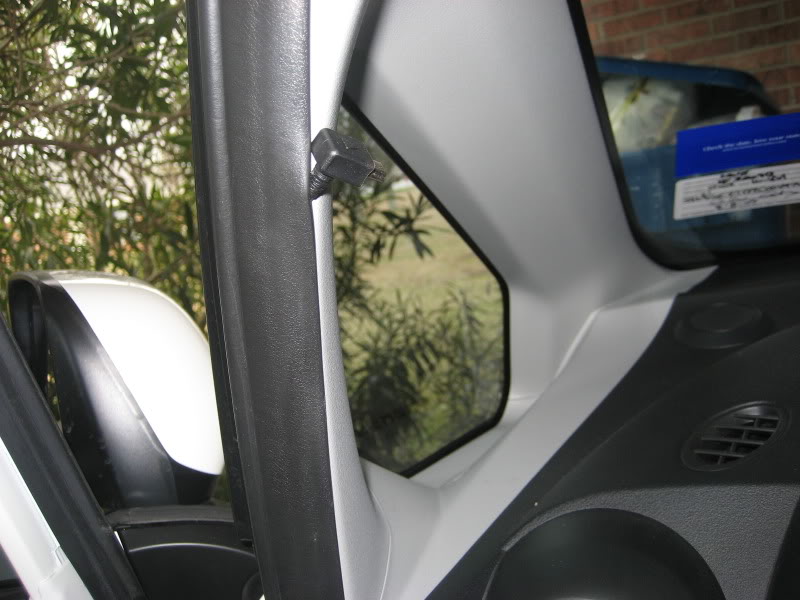

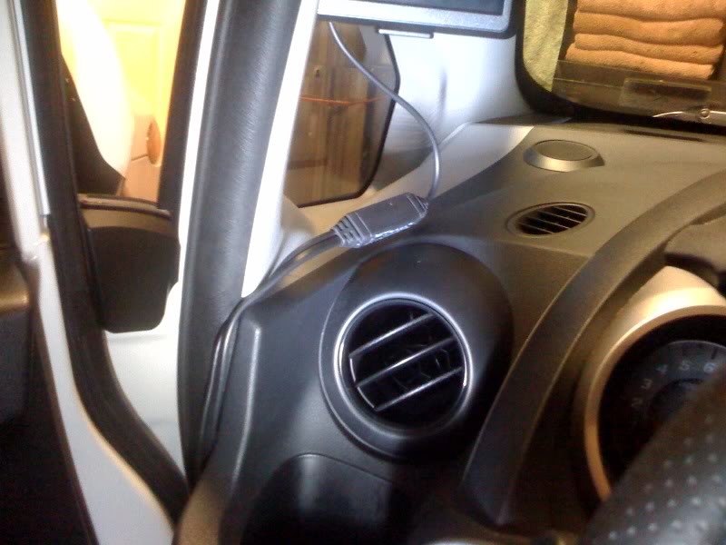

Old Jan 3, 2010 | 02:49 PM
Btrthnezr3's Avatar
Posts: 3,266
From: Texas

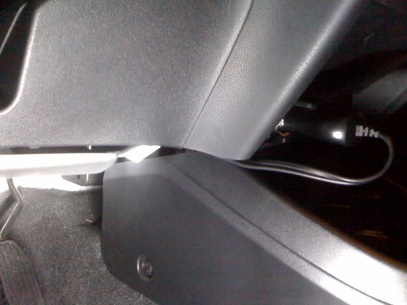

Hey Vash...you can also hide the wire even more by putting it inside the weathe stripping. I have my gps mounted like that. The plug, I have precariously (when not in use) laying on the lower dash cover (can get it out really easy if using). and then the wire goes across the under dash cover, and then comes up where the hood release is but instead of having the wire just going, I tucked it under the weather stripping so it is not visible again until it comes out above the cupholder.
Here's my plug coming out
The cord going from the pillar into the lower dash cover
Where I have the plug hidden
My hand retrieving the plug
The plug coming out with plenty of slack to be plugged in
I don't use my GPS every day, probably not even every week. So it benefits me to have the wire in there, ready to go, but the actual unit stays at home until we venture out to the big city (lol). This helps keep it hidden also for thieves. I just unhook the suction from the quarter window, and you can't even tell it's been there.
