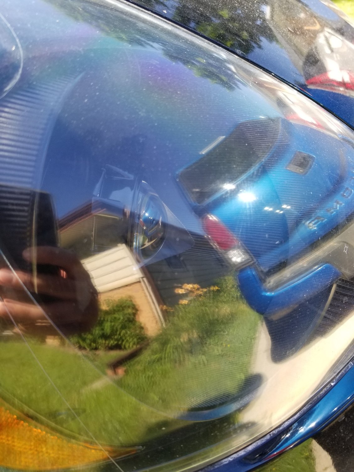

Sorry to keep everyone waiting, but it has been a busy week at work and with the kid. Here are some closer shots, but I need to do more when I get better lighting in the evening and of course night output shots(I don't even know what that looks like yet). Sorry for the glare on these (probably can see my truck better than the actual headlight). Also, looks like I need to run the polishing pad some more on these lenses.
