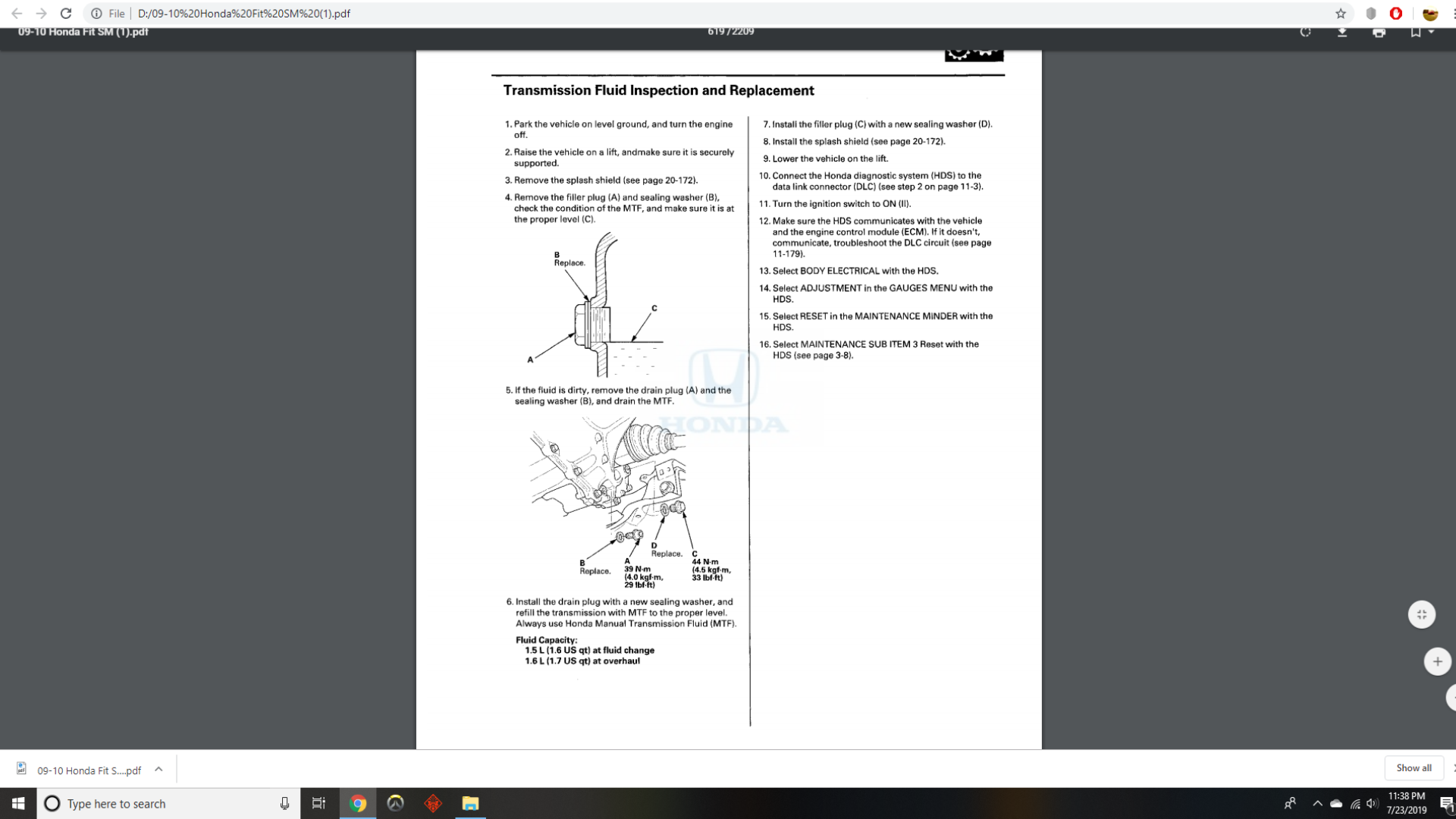

This is from the service manual. I'm not bothering to attach the splash shield removal, its really self-explanatory. Also not strictly needed, you can access both bolts from underneath. You'll need to borrow a buddy to help pour new transmission fluid into fill hole. You could also drill a hole in the top of the lid for the transmission fluid bottle, and snake the pvc tubing into the hole and squeeze to pump into the transmission, or a siphon pump for $8 bucks from walmart will do. It's an extremely simple job, having done it twice on my Fit it's among one of the easiest maintenance jobs. But those damn spark plugs man....
