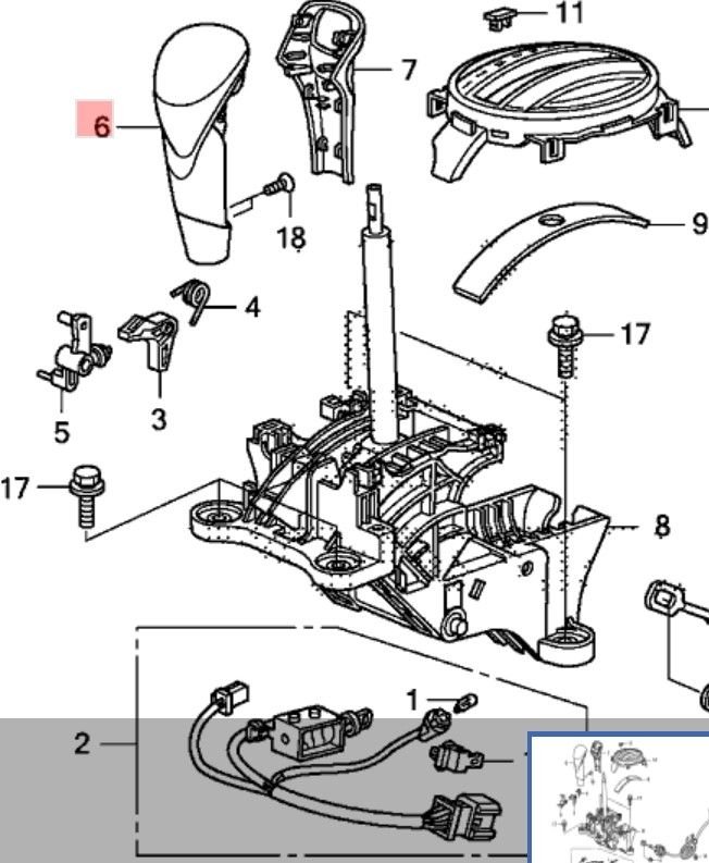

What's missing?
Something missing so switch not activating when put in park. Have rigged it as seen and works ATM. Without switch press only way to remove the car keys is to disconnect negative from battery.
Picture is underneath the auto gear shifter.

I see from your pic that you have #3 & #5. Unfortunately, this parts diagram isn't oriented in a way that makes it useful. Maybe the wiring harness #2 has a piece missing.

Think I'll have to be more thorough looking for bits that have fallen off/broken tomorrow. Suspect some sort of spring missing ie that #4
Now that you mention it, I don't see the spring, #4 in the diagram, that looks like it would be on / around that "V" rocker. Almost looks like the pivot post for that "V" rocker is snapped off but I've never seen this mechanism in real life, so just a guess.

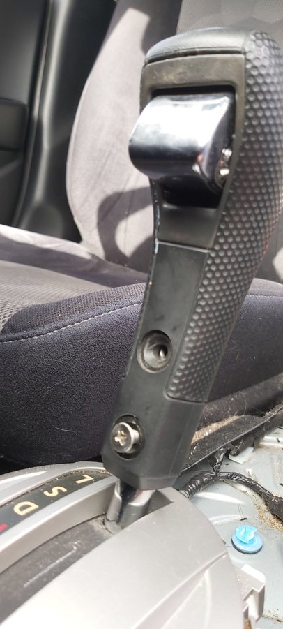

Having seen the video, I don't think anything is missing.
Rather, my guess is that the shifter isn't properly locking into place.
To the right side of the picture (in first post), there's something that looks almost like the center cardboard of toilet paper rolls. And from that is a protruding piece of dark metal.
When you move the shifter into park, its supposed to move all the way to the left and then all the way up until it pushes against the little flap of metal you have a piece of wood ziptied to. Its supposed to push around where that metal bends into a C shape. That is when its supposed to trigger the switch.
The way you placed the piece of wood indicates to me that the metal from the shifter handle isn't moving all the way up. So most likely, the issue is in the shifter handle itself. According to the video, that protuding metal should always want to move itself up, unless you are pressing the shifter "button" at the top of the handle. Broken spring at the bottom of the handle?

You were right Goobers. Found a screw missing on the shaft and another that's too long. Will need to get the proper screws. Thanks everyone for your help.
