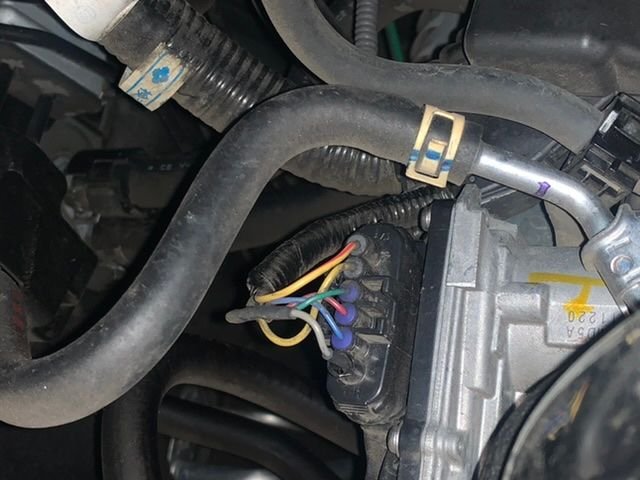

I had CEL/VSA lights and limp mode due to a broken wire on the throttle body harness. Based on your codes, it may not be that particular harness but check the connectors/wires. May be as simple as fixing a broken 18 gauge wire. *Fingers crossed*
Bottom (gray) wire had completely pulled from the connector and threw the engine lights/limp mode.
