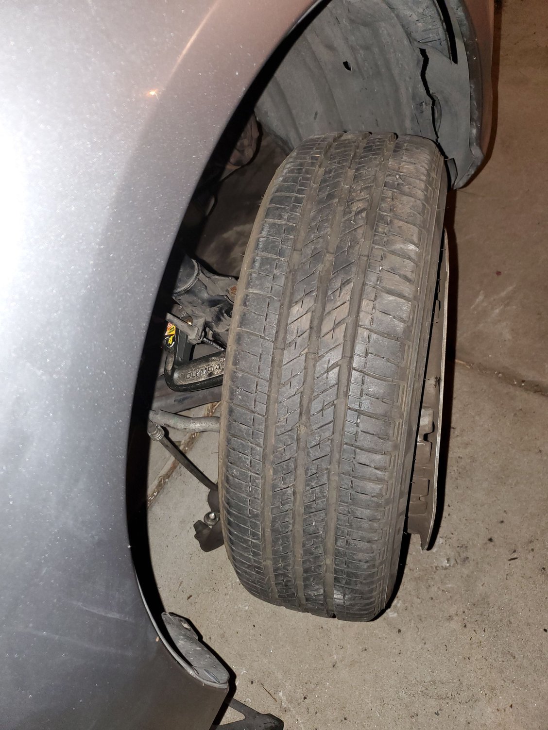

Drive axle replaced
I just replaced the engine on my 2011 Honda fit. When I put the passenger side drive axle, I need about 1/3-1/2 of an inch on the upper hole on the strut to insert the bolt connecting wheel hub assembly. Looks like the axle is completely engaged and the dust cover is all the way in. I wonder if I should remove the ball joints connecting the wheel hub to the lower control arm and to the steering rod end, or should I just use the vise clamp to try to force the steering knuckle into the strut assembly?
Gsp is seen here. Ill take the wheel off and make a better pic later
Wheel is turned outside on the top

I probably can just dislocate the ball joints on the strut assembly to be able to put the steering knuckle in the place. I just don't want to force it in.
