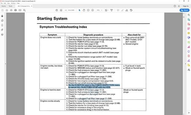

That is a story. However, in troubleshooting guide I saw one of the possibilities of fixing engine not igniting is PCM reset.
Any ideas are welcome. If there is a schematic of the engine wiring connectors with their approximate locations, that would be a great help.

I have an original service manual as well as a cheap Autozone version of it. None is dealing with the troubleshooting of the no pulse signal in fuel injectors.
