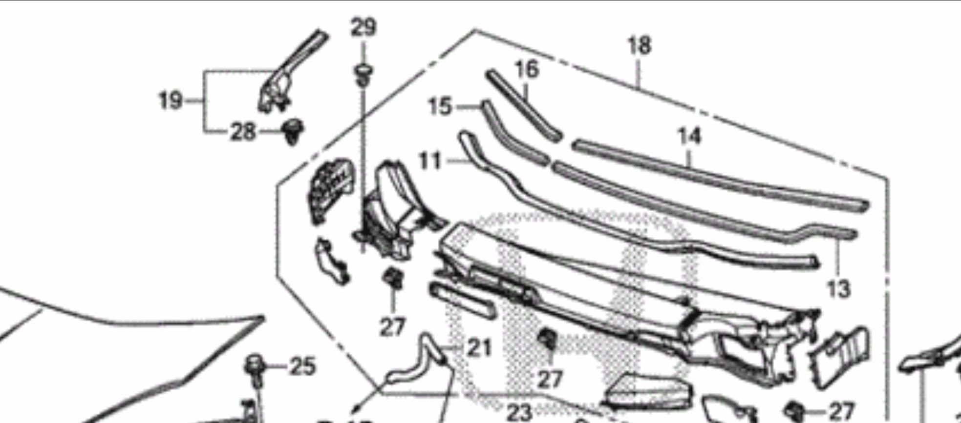

Looking for the part number for the trim on the passenger side lower corner for the windshield of my 2009 Fit Sport. I can’t figure it out on any Honda Parts sites.
Mine broke when the it was replaced and flew off. Didn’t know how bad it was broken until it was gone.

Looks like this?

maybe? I was hoping to get the part number so I can check the schematic diagram.
might Cover, Passenger Hood Hinge - Honda (74222-TK6-A00)

In my shop manual they are called " Hood Hinge Covers" Make sure to order the right side.

74212-TK6-A00
90602-TK6-A00
These are what I ordered from https://dreamshop.honda.com
I as the Guinea Pig for this site for my friends and I just replaced these pieces yesterday! Use this site to find your exact piece! https://dreamshop.honda.com/s/catego...g0000004HolGAE

After having two fly off, I selectively placed a small piece of 3M tape to hold mine in place. It allows easy removal, but some grip and all has been well for many years since. Just a suggestion.

It appears that the recommended wipers hit the piece and may be knocking it off.

mine was being hit by wioer
I mistakenly put the listed rear wiper up front and it was fixed by swapping them.
