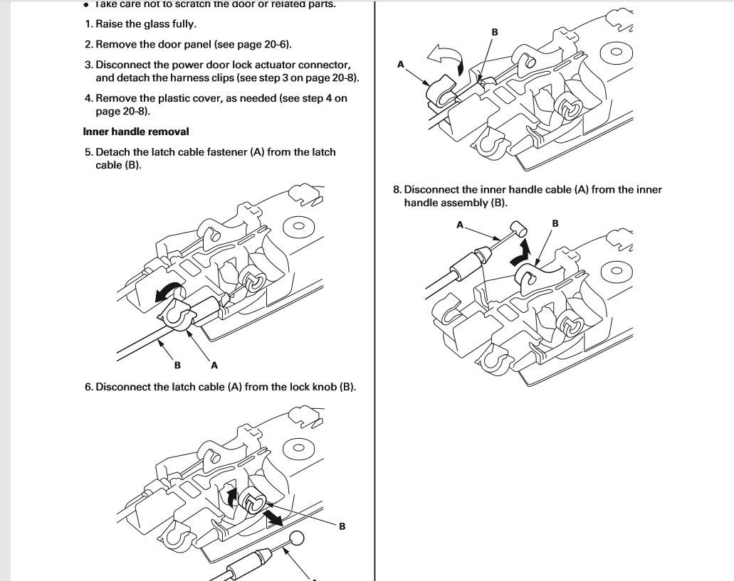

hello everyone, I would like to seek you guidance on where to connect the cable of the cylinder lock. Reason is whenever I use the key to open the door its not opening. I also saw from the inside that the cable from cylinder lock is disconnected. I would appreciate if we have a diagram or picture of the cable connection. Thanks in advance.

This help?

Almost. :-) thanks for your response.

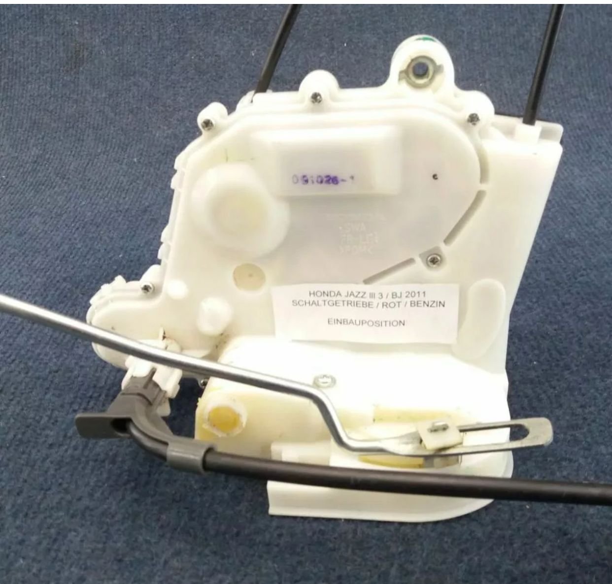

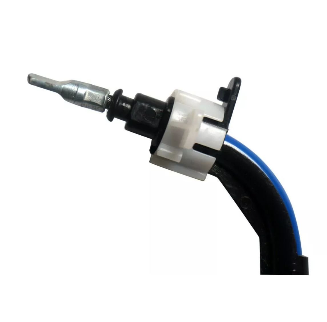

I am able to source a picture. I was referring to the black cable connected to the actuator. I found out that my actuator from the driver side has no opening for the cable. Hence, I will replace it once the new once arrives. Thanks for your help.

Found it
I found a picture on the internet and noticed that my door actuator on the driver side has no opening for the cable. I am just waiting for the new part to arrive then will replace it. Thanks for you response.
