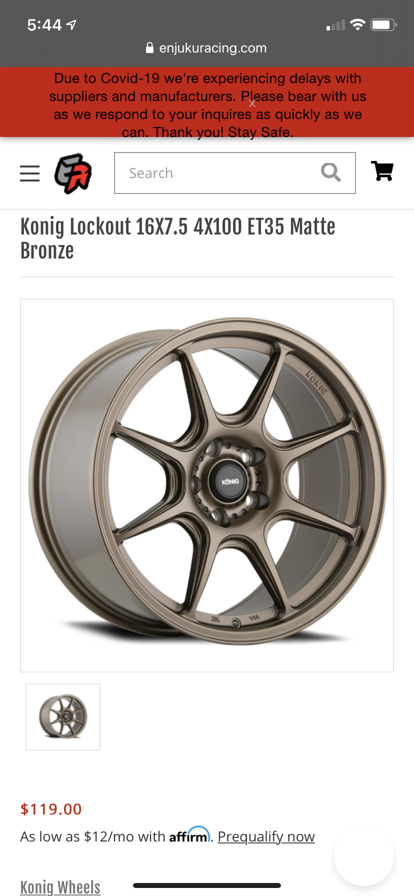

16x7.5 +35 offset 205/45/16 tires
#1 will it fit with no rub?
#2 do any of you have pictures of it on a fit?
#if not please share some NEW rim ideas in this price range cause I’m struggling to find a nice set.

Is your car stock height or lowered?

I have been able to run 205/50R16's on stock wheels, so clearance shouldn't be an issue...
Old Aug 24, 2020 | 04:53 PM
Posts: 7,624
Stock wheels and 16x7.5 +35 are very different things.

I'll take some pics of clearance with my 16x7 +35s. stock ride height though.

I'm also running 205/50r16 on stock sport rims with stock suspension height. I'm closer to your +35 though, as I am running 20mm spacers in the front. Only when cornering hard with a mid-corner bump have I had a rub.

Okay, with 205/50/16s on 16x7+35 wheels, stock springs I had approximately 2 inches of clearance with the wheels at full lock. From memory I recall j's racing using 8 inch wide wheels on the front with the stock offset. Actually, i just found the link.
and they fit 215 width tires.
