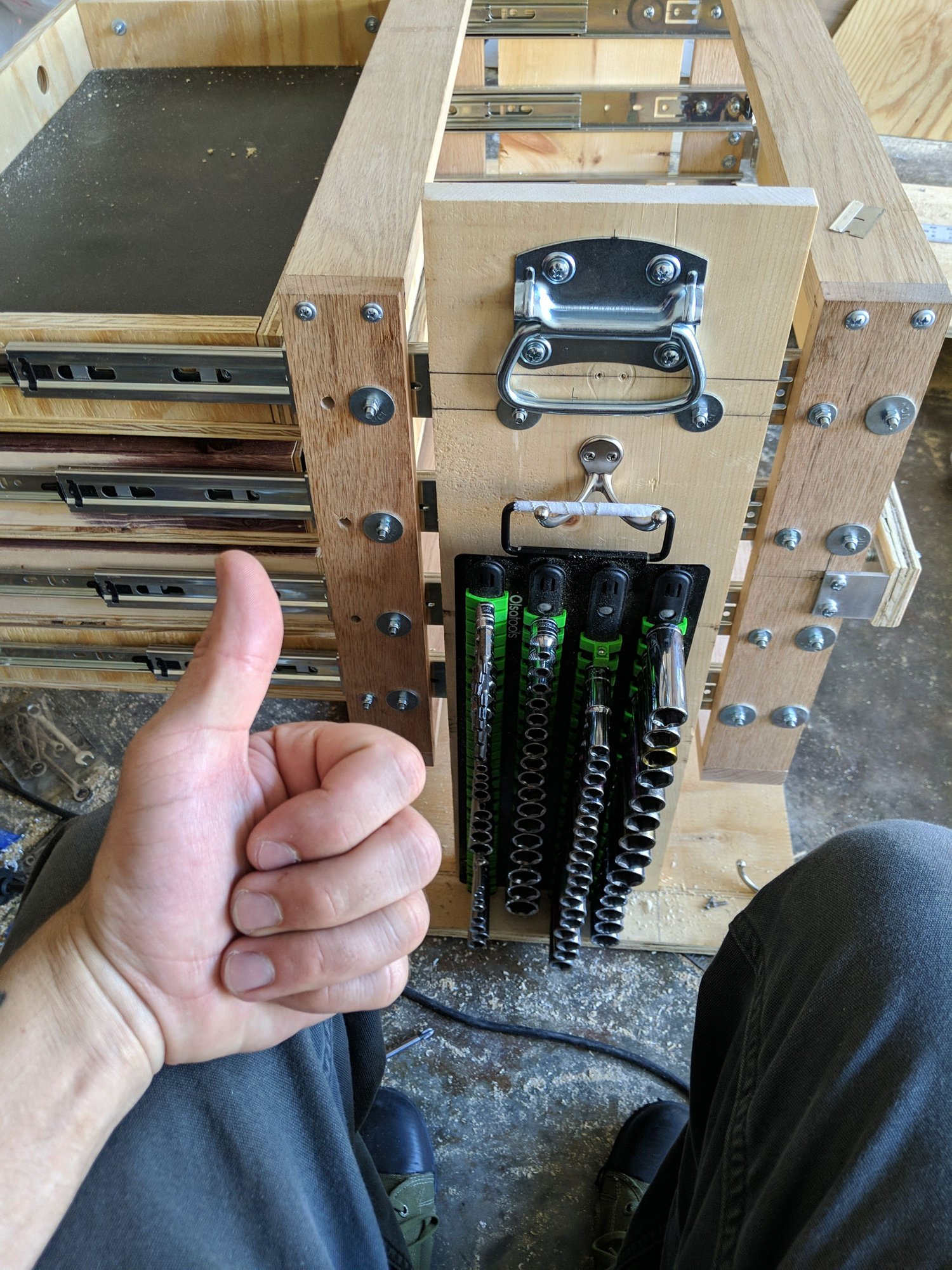

I've been doing stuff with wood lately so my head's been elsewhere!
Ramp for our two 10 year old dogs
Toolbox that I definitely should have designed with solid 5ply sides and a full back panel (and the soft close drawer slides. Those springs would have kept me from needing to put a strap around the drawers). Was trying to use scrap n save wood for the ramp.
Was slightly proud.
