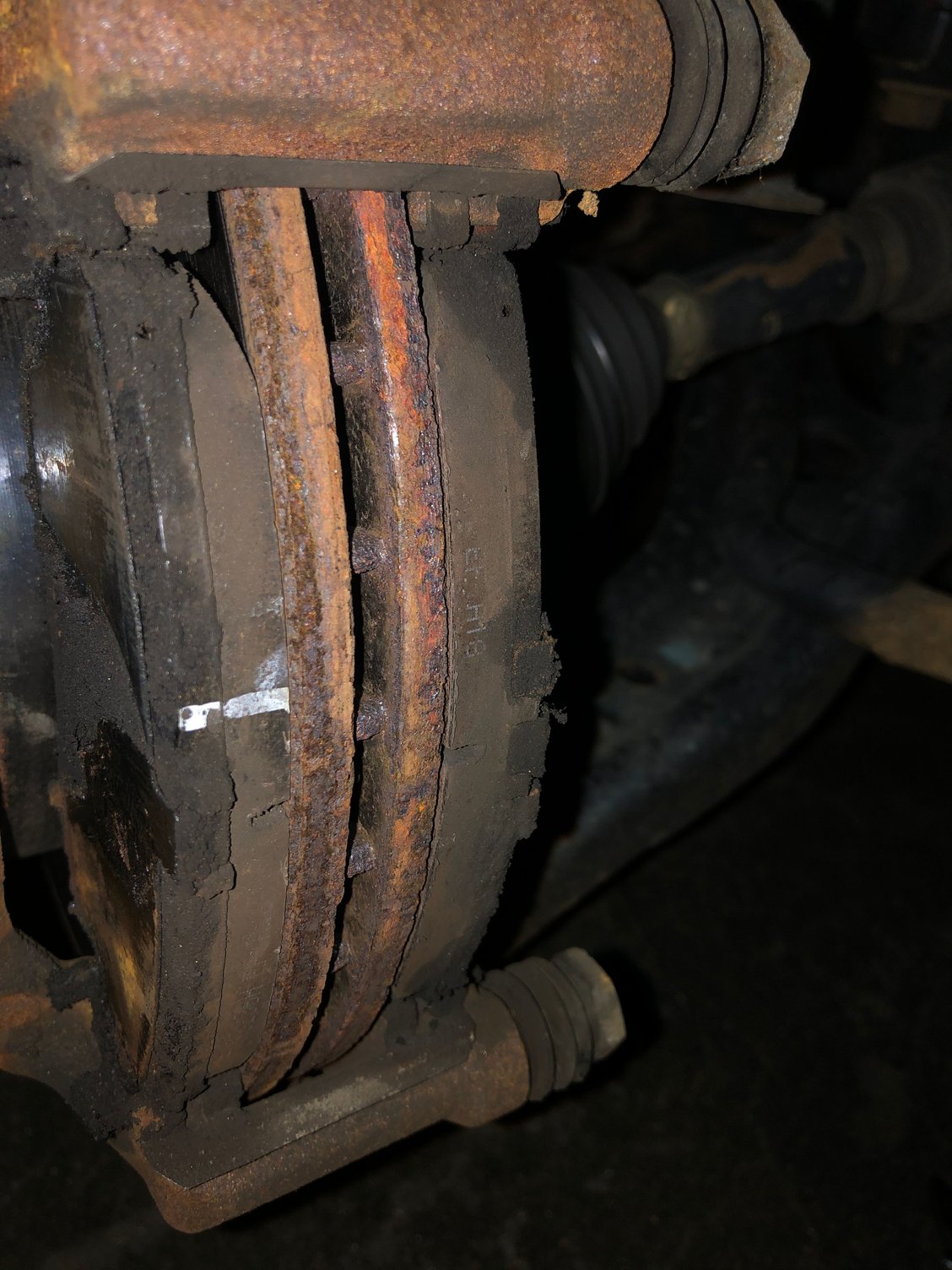

I think you solved it or at least I hope. I pulled off both wheels and calipers today and discovered that the pad spring clips were missing on both sides... thank you for the picture. I am going to buy some of these and see if this solves the issue. Not sure why they would replace the whole caliper before trying this...
thanks for all the help and insight. Here is a photo of the pad with no clips...

Now for our poster! Since we've verified absence of the springs we now have to consider resurfacing or replacing the rotors unfortunately. The new springs may not spread the pads enough to fully overcome the warping that must have occurred to create the sound demonstrated. If the rotors weren't warped, it's my assumption that it'd sound like a constant rub, easily overlooked.
The springs are obviously very simple, small, and rough-fitting (that's to say there's play when installed) things. Things matching that description may seem unnecessary, but they are in fact the only things keeping your brake pads from rubbing on the rotors! Without those springs, the pads are never spread apart after being compressed, so they wear faster and get hotter than they would under normal operation.
The pads will rub and make the rotors retain while accelerating/cruising (when they should be cooling off) and then sit against said rotors when you stop. So here's the theory: The excessive heat generated by all this rubbing makes the metal of the rotors get relatively soft, making them vulnerable to pressure. Then stuff gets squeezed and they warp! Alternatively, they get squeezed and cool at different rates: the area covered by the pads vs the uncovered area of the rotors, and this contrast in cooling causes the deformation.
​​​​​​But don't be too sad about replacing the rotors (quite reasonable at ~ $60.00 or less for a good set when properly shopped for) because the absence of rubbing will actually restore (through removal of resistance) some lost power and fuel economy!! Your car used to have more pep, and you'll be getting it back.
If you'd like to test the assumption about warping, you need only to remove the offending wheel/s once more and take a straight edge to the rotors. I assume they should warp on both sides, since the system works by pinching, so you may well get away with checking only the exposed side in a couple places. A sturdy metal woodworking square similar to what's seen below should get the answer for you

That means the reason they were missing is because they don't come in the new sets (if bought from Honda, aftermarket sets *should* come with them, mine did) and intend for you to reuse the old ones.
So whoever did your brakes didn't install the springs, not because of error so much as technicality. The new pads come with anti-squeal clips for the brakes to sit in if I'm not mistaken, and most come with springs, leading one to assume everything that should be installed/replaced is included. So it falls to the technician to look and think: these were there before, so they should go back on.
If you're wondering whether they're needed, well, you experienced warping and these are singularly purposed to prevent that. Even if they were never on the vehicle, you need them because you experienced the thing they prevent.
So where to from here? O'reilly's sells the hardware kit (I think shipping outweighs benefit of ordering them online). Here's a LINK. You can call them with the part number found in it, or get them from another store, it's just that I'm used to seeing O'reilly's stores everywhere.
Alternatively, you could replace the pads with aftermarket ones and the new springs will come with them. If you want a specific parts recommendation, I went with Centric Posi-Quiet Ceramics via rockauto. I can't speak to improved stopping power since I added slotted rotors at the same time, but they seem good all around so far.
