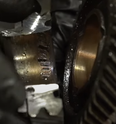

hey long time later, finally got everything sorted out. it was much, much worse. heated up some bearings and locked the transmission up
check. your. fluid. levels.
Here's some grooves in the inner surface of a gear from the bearing.
That's what's left of the bearing. Some cutting had to be done, the gear was stuck on, but the bearing was trashed.

Oh wow, an impressive amount of damage. So do you think the transmission was the cause of this? Or did the clutch blow up first?

oh yeah I forgot to mention that. the transmission was definitely at fault. It was basically permanently fused in 4th gear.
The clutch was in fantastic shape. There were some gouges in the springs that seemed to line up with gouges in the flywheel bolts. I’m assuming that was a result of the failure, so I replaced that too just in case.

yup junkyard trans and new clutch kit. Took a while to get around to it since I have a truck also, and wife and my priorities took a while to align 😂

@punx45 Nice work, punx. So, your diagnosis of the failure was that your MT fluid level got low, or completely disappeared, and that lead to the transmission failure?

you got it!
