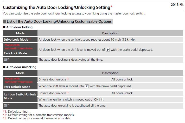

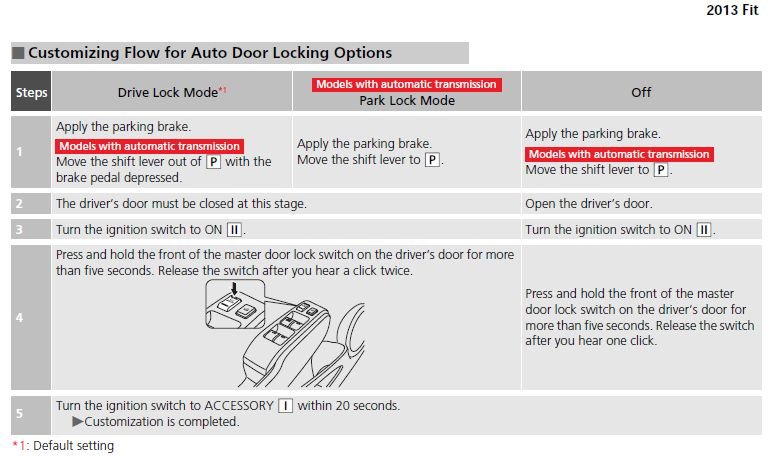

I'm not sure if it'll help, but from the Owner's Manual in our 2013 is this. You can deactivate the auto-locking using the Master Door Lock Switch. I don't normally drive our Fit, so have no experience with any of this.
