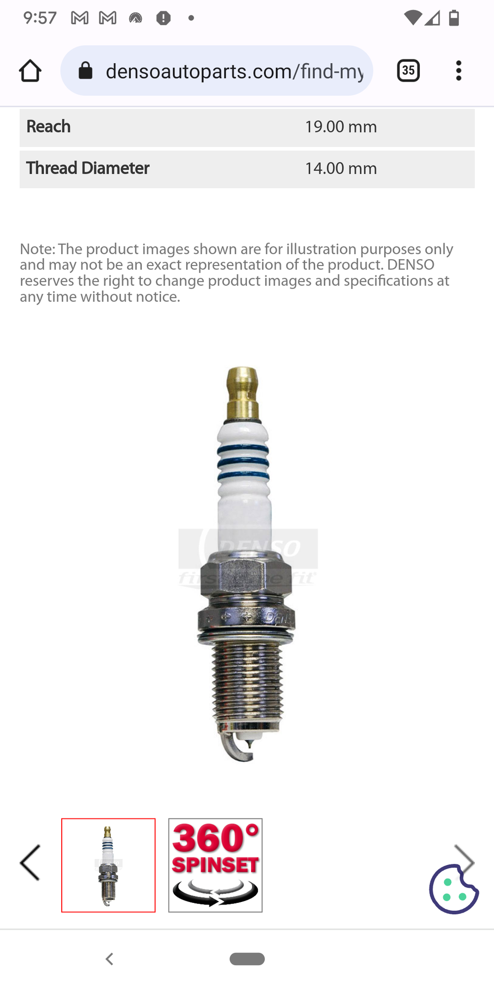

BTW, are any of the IK22 plugs you have had had all white tops (no blue bands)? The plugs I received today where all white on top (no bands). Was wondering if Denso has changed design.
Thanks
Old Feb 13, 2022 | 10:01 AM
  #37
Pyts's Avatar
Joined: Mar 2016
Posts: 1,325
From: Metro Atlanta, Georgia
Can't say whether they have stripes, but I don't think that's of much concern. Here's a
And here's two images showing measurable specs and appearance for reference (couldn't link because of how the site works)
In the image that lets you rotate the plug, there's no stripes. Its just got crummy picture quality.
