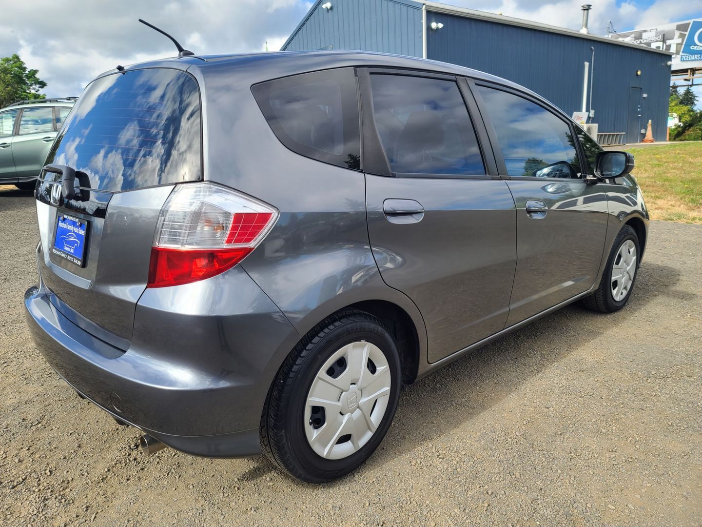

I clicked Plugs Never Replaced, No Faults
but I just picked up my 2013 yesterday (and she only has 5,700 miles)
how long should I wait to check the torque?

nope mine is a 2013 (2nd Gen)
last year of the 5sp auto

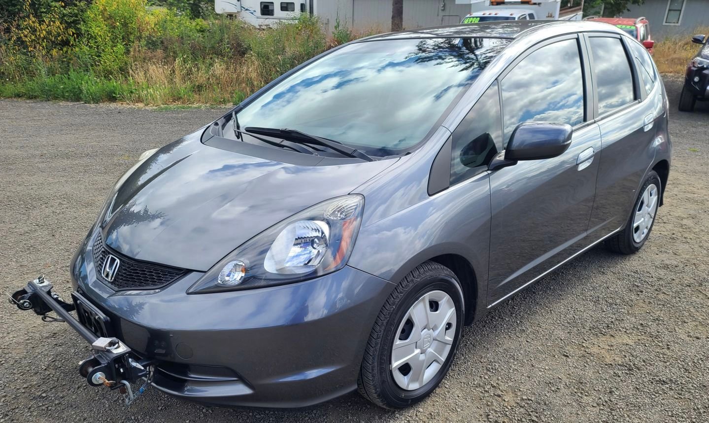

My low mileage 2013
I’ll be taking it in at about 10K to talk to the dealer about recalls and TSB’s

I need to lock that into memory. 2013 can be a USDM second generation.
It looks awesome!! Congrats!
