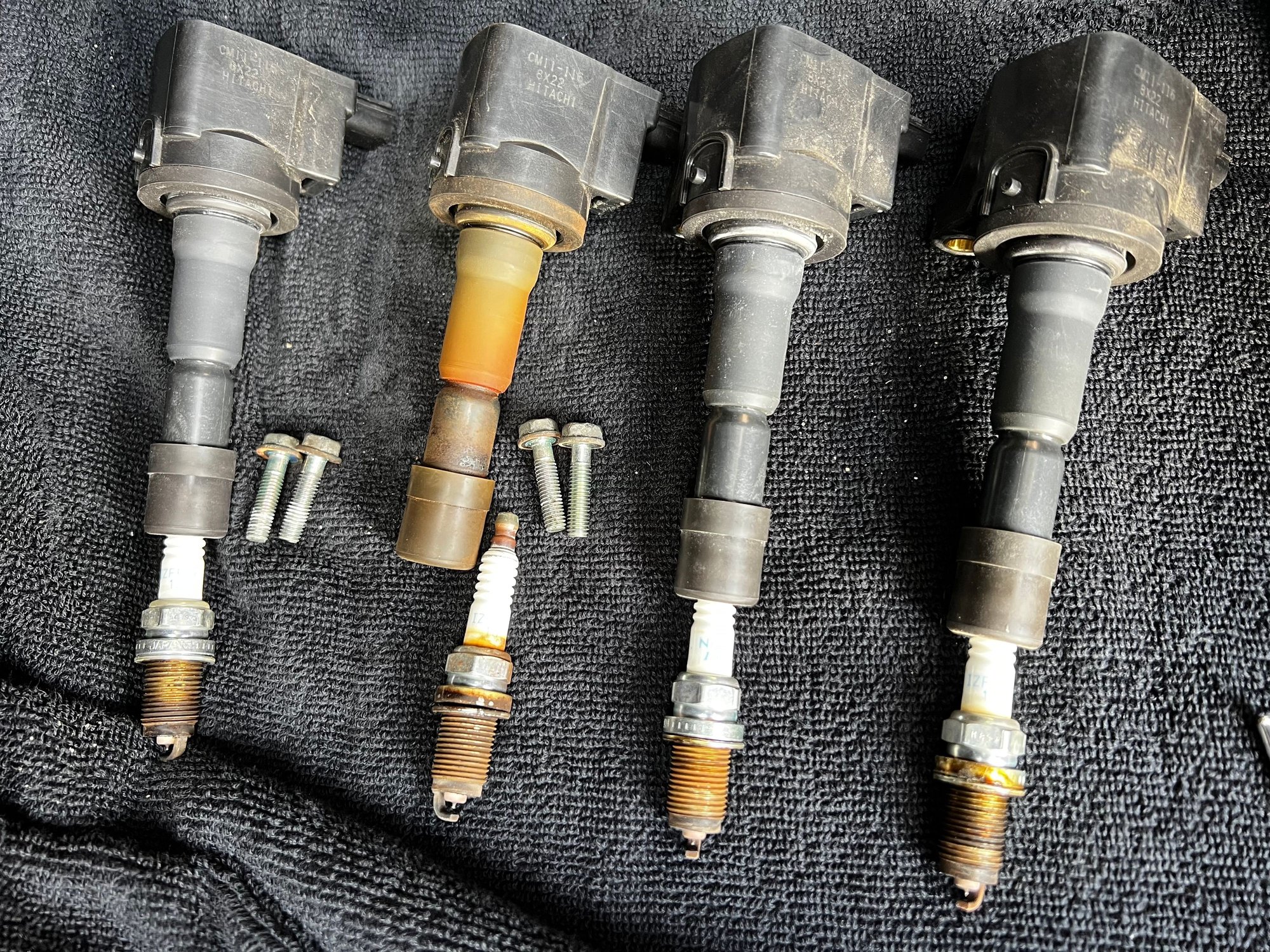

Man, what a pain. Replaced the plugs/coils and upstream o2 sensor. All of the coils came apart trying to get them out of the wells. (three different pieces). From left to right, plugs 1, 3 and 4 could have been unscrewed by hand. I put the spark plug socket and extension into the well and attached the wrench but they came out with no effort. Put in new NGK plugs and Denso coils and car fired right up with no flashing CEL and revs easily. However, I'm too wimpy to try and drive it because I live on a mountain and worried about another tow if it won't get up driveway.
Bonus, now the power steering works again.
If I can get on ramps, oil and transmission fluid tomorrow.

Nice work!!
You can let it idle for 30 if you're worried. that should be enough to pop a code I think, or it was for me anyways.
I'm surprised to hear the coils came apart. I may be lucky in that department as mine never gave me trouble.
I'd recommend checking the trans fluid when you're able, and since it's new to you, getting rid of the old brake fluid and coolant (and trans juice) since the previous owner probably never did.
Also very surprised to hear power steering failure somehow correlated with the misfire. Not too versed in electronics, but I wouldn't have suspected. Numerous folks have mentioned power steering non-op lately and I had no idea what to point them towards. Will keep your experience in mind for the future.
