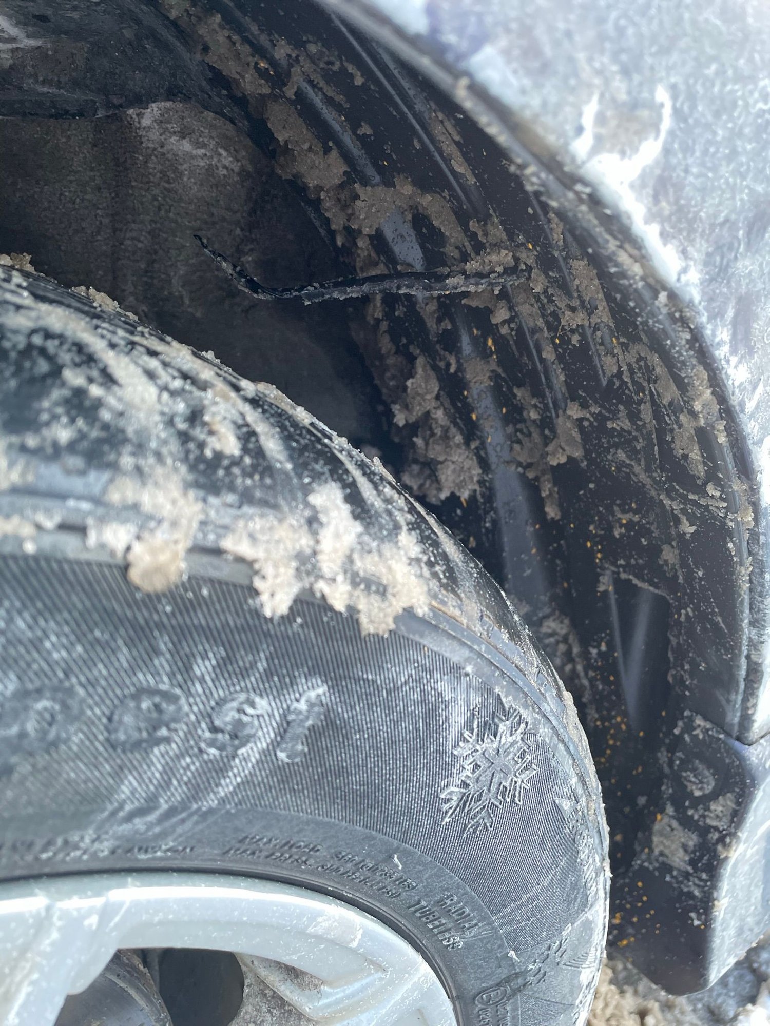

Hello,
I was removing ice around my left driver wheel and noticed an electric cable was ripped off. all lights are working fine. and the car seems fine. What would it be?
The cable color is red.
Attached is a picture.

You can't tell much from your pic. Does the wire look factory, or like someone added it- like an aftermarket block heater, aftermarket fog lights, etc.? I'd look at the fuse box on the left side and see if something was added to the panel for power. If that doesn't work, look under the hood for the same thing. If that still doesn't work, lift the car up, remove the wheel and remove any screws etc holding the fender liner on, and then gently pull the liner down and see if you can see where the wiring travels to. Good luck!
