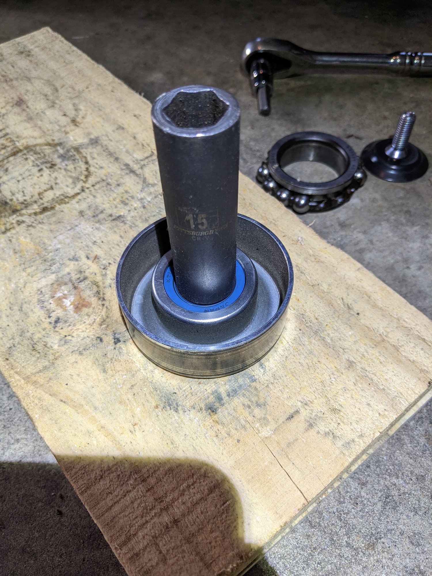

UPDATE: Jerks sent me a 6205 instead of the 6203 😂 way too big. Being in the moment I didnt check *before* removing the old bearing from the pulley.. Now It's reinstalled. Used a 15mm deep well socket with the drive end against the inner ring to pound the old bearing out. Needed something sturdy with a bearing sized hole in it to set the pulley wheel on so that the bearing could come all the way out of the pulley (if just setting on wood the bearing would become flush with the pulley against the wood during removal before dislodging completely). To that end I used the remains of an old wheel bearing from a ford escape. Will take pics to aid in clarification.

Took some pics. Note: I found it easier to remove the belt from the top with a regular 19mm combo wrench and a flathead to scooch the belt off the alternator pulley. For the tensioner, the front bolt's easier to access from the hood, back bolt from under the car. Tensioner comes out under the car easiest. Clearance for a torque wrench is best from under the car for both bolts, even though visibility is impaired for the front one.

Starting to knock out old bearing
Got flush with the pulley as mentioned in above post
Finished knocking it out on this old inner race from a ford wheel bearing.
Started the new bearing by placing the old one on top of it and going around with a standard 2lb claw hammer knocking it a little at a time, checking each time to see it go in evenly. Finished using 1-1/16 socket and a 49oz dead blow rubber mallet. If I kept using the old bearing it might've gotten stuck in the pulley with the new one. Though the image shows the drive side of the socket being up, i flipped it for hammering, placing the drive side against the bearing. Seemed flatter/safer
