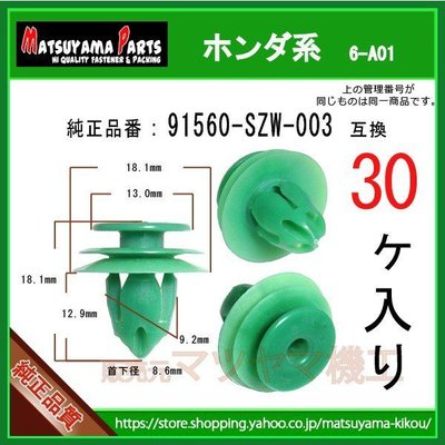

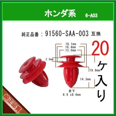

Has anyone used the 91560-szw-003 clips instead of the 91560-saa-003 door trim clips for their ge8? The SAA are $2/each and really difficult to source, the SZW are much much cheaper and way easier to find. The dimensions are very close and seem like they would work just fine.

I know this thread is a little old but I had the exact same question when replacing speakers in my '13. I can confirm that some 91560-SZW-003 equivalent clips will work in the door panels as a substitute for the red 91560-SAA-003 clips. They seem to be a slightly tighter fit. That's a good thing for keeping your door card on but a bad thing if you forget an old clip in the door when replacing the panel. The green clips were much harder to remove than the red clips after installation. You will absolutely need a good set of trim tools if you ever need to remove the door panel again. This could be a result of the differing spec or the fact that I bought Chinese knockoffs. Here's a link to the exact product I bought.
91560-SZW-003 91560-SZW-003
