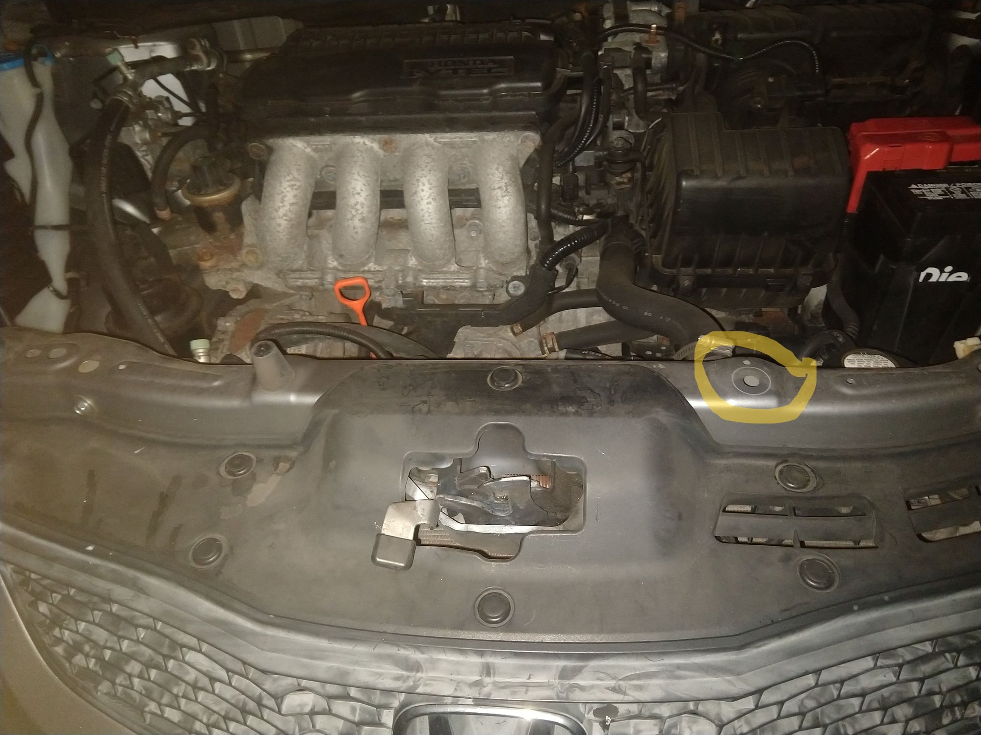

It doesn't look like it's important. But it's bugging me. What's the part called? Should I get I replace it?

Lol.....wouldn't it be easier to put the yellow marking around the one on the other side that's still there?
I don't know the official name for the pair. I've heard them called hood rubber snubbers. They twist into the radiator support and help keep the hood from shaking when the car is running.

I trust most y'all here know Fit and its parts like the back of your hands. So circling a missing part would be instantly identified by the experts here.

Just noticed that the same part is missing on our 2013 Fit. I'm guessing it to be Cushion, Hood (30MM), Honda 91601-SZ5-000 or 91601SZ5000. I'm glad that @56chevydan reports that they twist in because the back side cannot be accessed.
Just to be sure, these are the same part?
