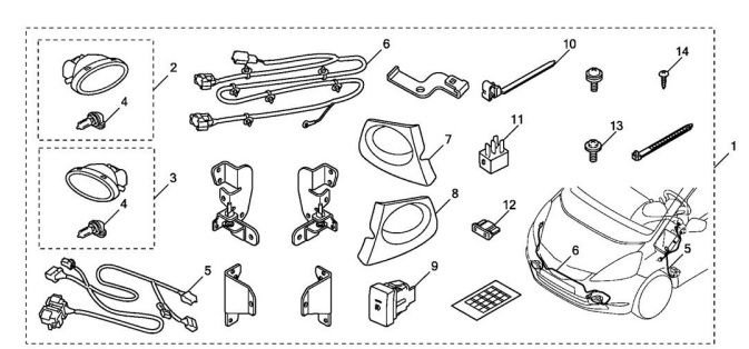

You can get fog lights for the non-sport bumper. Part # 08V31-TK6-100

The Sport bumper bolts on with no issues. You can also buy dealer optional fog lights for your standard bumper as said above.

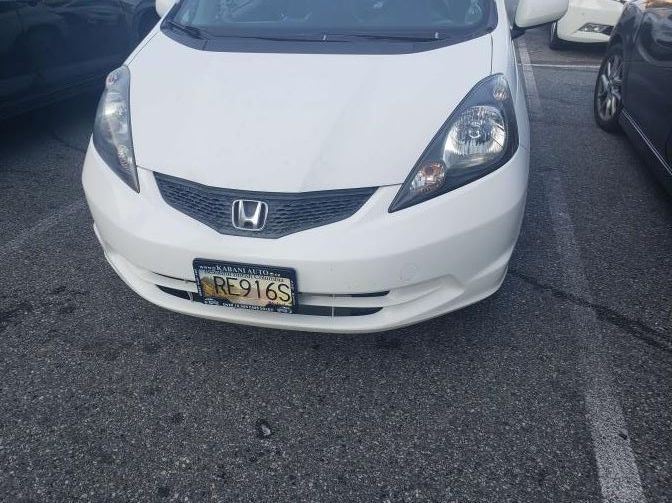

I don't think my base bumper has slots for those, hence why im looking for a sport bumper. However this is still good to know for when I need the fog lights if I make the swap.
Base bumper, no obvious slot for fog lights

I read elsewhere you still need the sport grille, are there other bumpers I can look for that fit onto the GE?

Fog lights are not the same on Sport and base. Look at this thread for a picture of the base fog lights: https://www.fitfreak.net/forums/2nd-...it-2013-a.html

You have to cut the holes. There are markings on the backside of the bumper of where to cut. The part # I showed earlier are fog lights for the base model.
