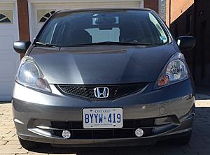

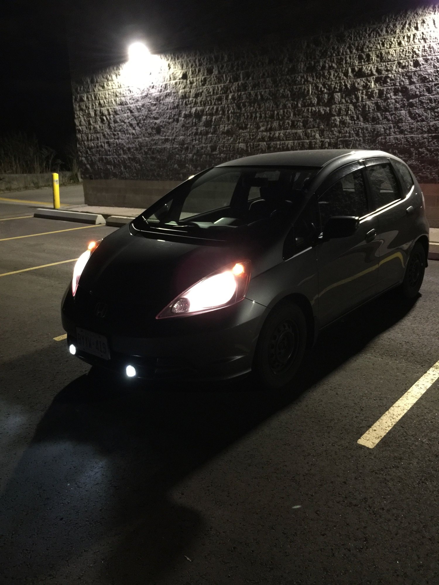

I wired up the switch using a fuse tap connector, with a 15A glow fuse for the accessory fuse, and a 3A fuse for the add-on/tapped switch. It's not the neatest job ever, but they work now.
2013 Honda Fit DX with Canadian Tire 3" aftermarket fog lights.
