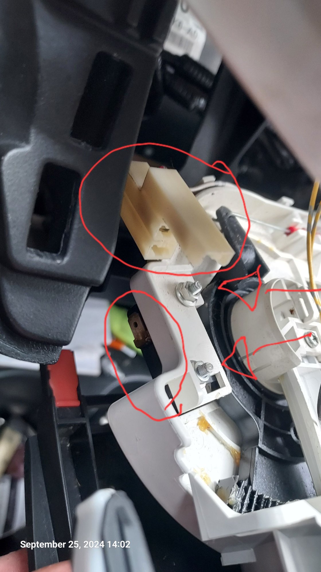

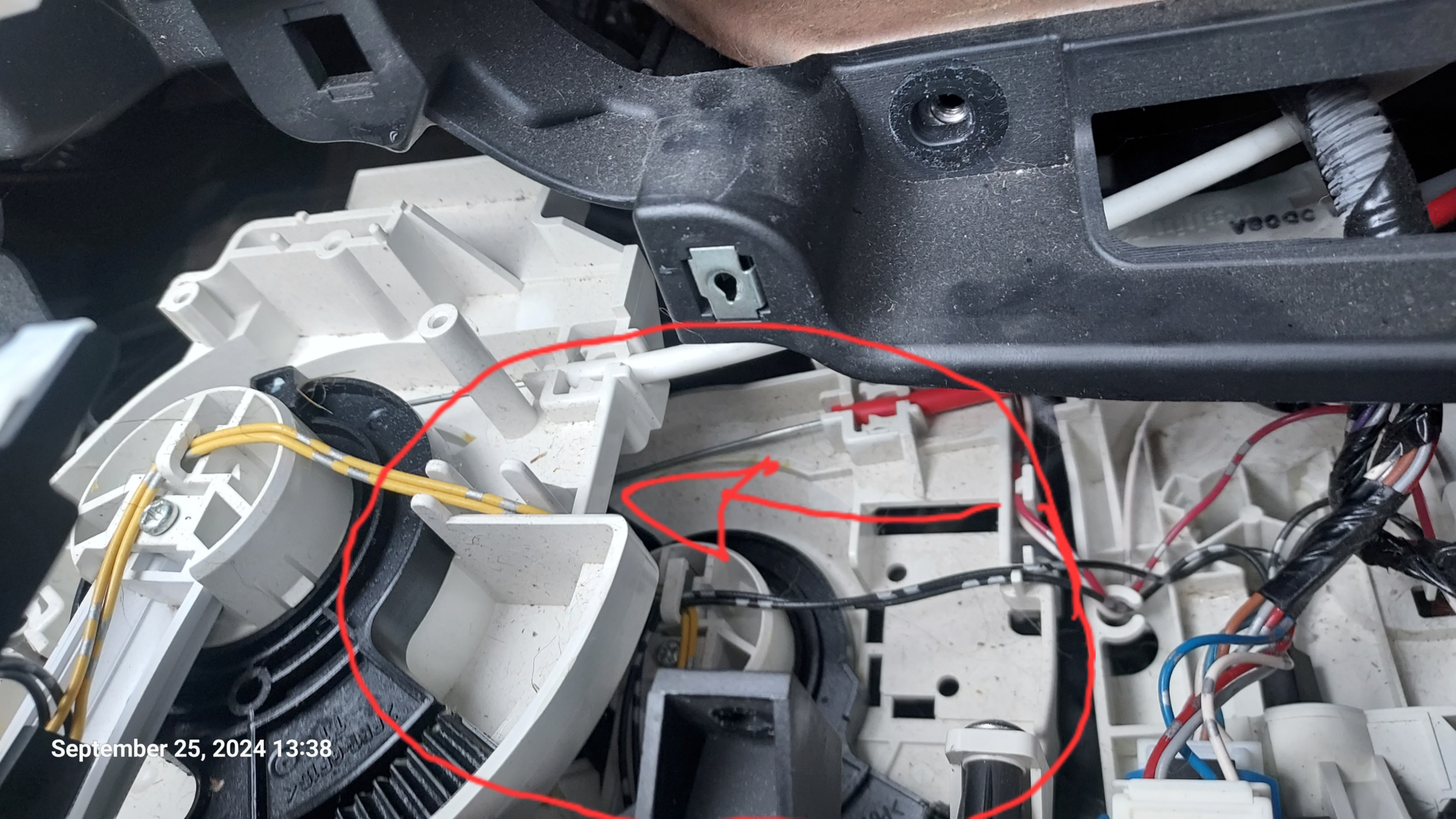

The ac defroster switch
This job was a bit more technical than I would have liked. Remove all the dash components to get the the temperature control system. Take the temperature control knob off using the Philips screws on the back. Do the same for the vent selector knob. Locate the switch in the photos. Good luck!
Bottom left corner of the vent selector
Top left view of switch with wire clip (top) and the switch (lower) circled and switch bolts with arrows
Lower view of disconnected switch and arrows to the bolts
