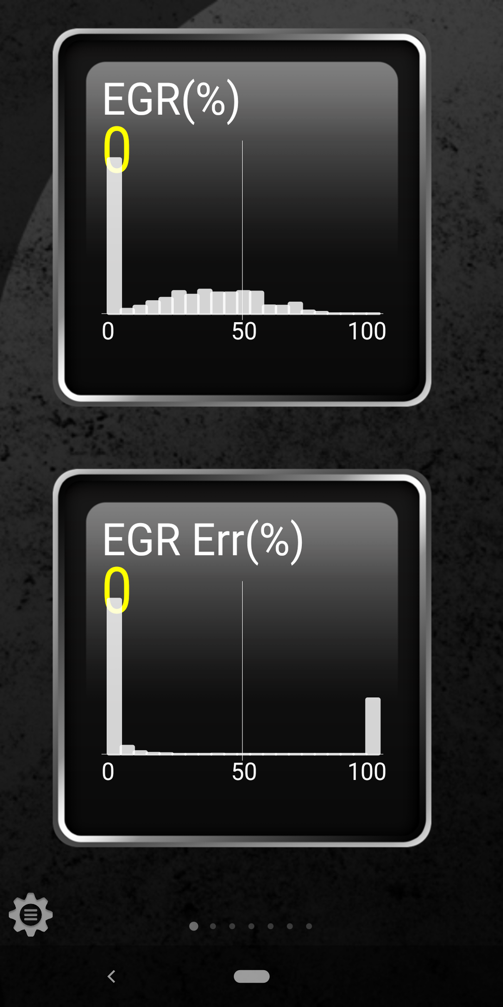

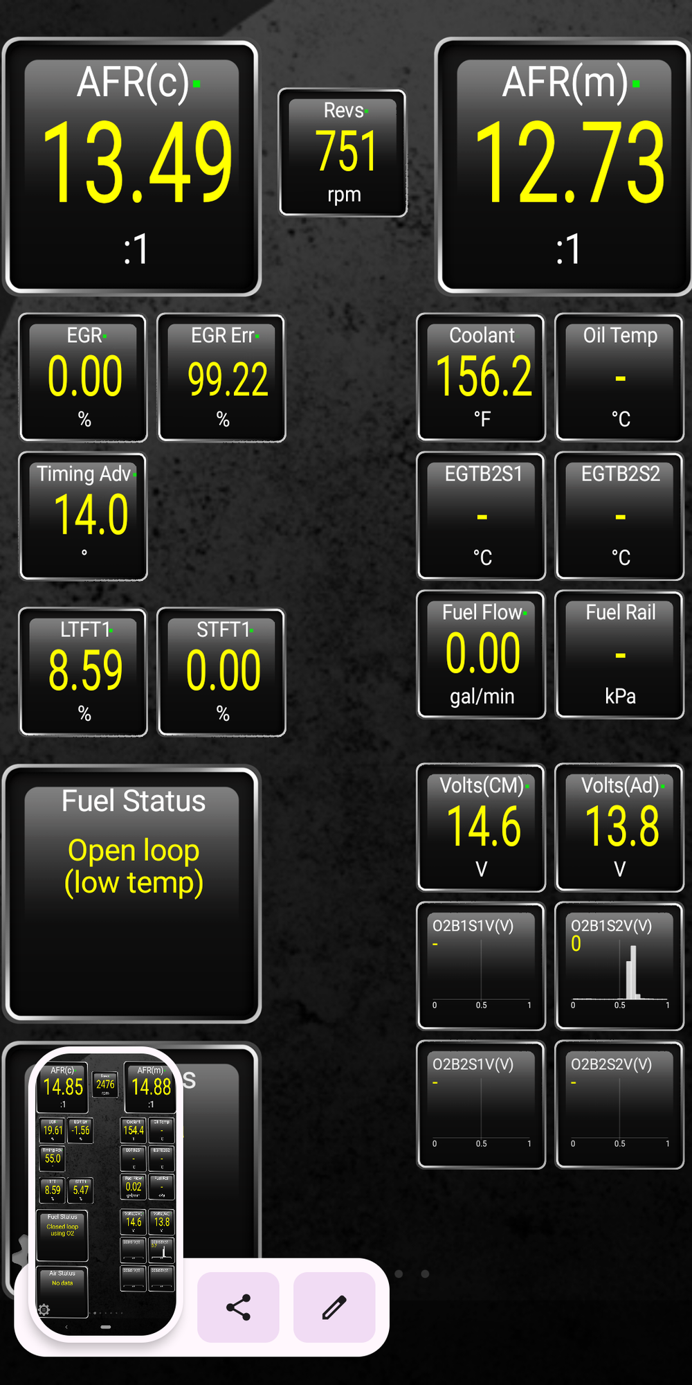

Old Dec 14, 2022 | 05:45 PM
Pyts's Avatar
Joined: Mar 2016
Posts: 1,325
From: Metro Atlanta, Georgia
Not in any order
These were all taken between warm up (indicated in the 4th image) and putting around between 1st and 3rd in the neighborhood. I think peak rpm was 4k in 1st, peak speed was around 35mph.
EDIT: worth mentioning that EGR commanded was 0 when idle/clutch in/coasting neutral. It read as 99.22 error at those times. Took a second either to recognize or engage when accelerating.
I think since you have no CEL/codes, we need to attempt to figure out what status/conditions shut off of EGR without throwing a code.
Be much easier though to suggest double-checking your most recent work on the car for anything amiss.
I know you're quite experienced and don't mean any offense with that suggestion. I'll still check the bishko manual to see what I can drum up for EGR not opening
