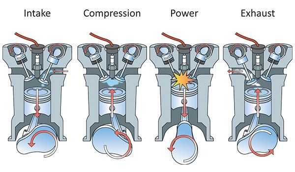

For OP, maybe this will help explain our apprehension about your mechanic's conclusion:
You may well know the above already. I don't mean any offense. It's just.. if that pin that held the piston on came out, or if the rod came off the crankshaft.. stuff would get goofy real quick. like, seized engine. sh*t, you could prolly just rotate the crankshaft by way of the harmonic balancer (biggest pulley) and put this whole matter to rest.
If you were to hear a bunch of clanging and clattering, or it won't rotate, I'd be super interested.
Sorry for what you went through :/ Just looking at how that plug got smooshed I could see how one would think it contacted the piston.
