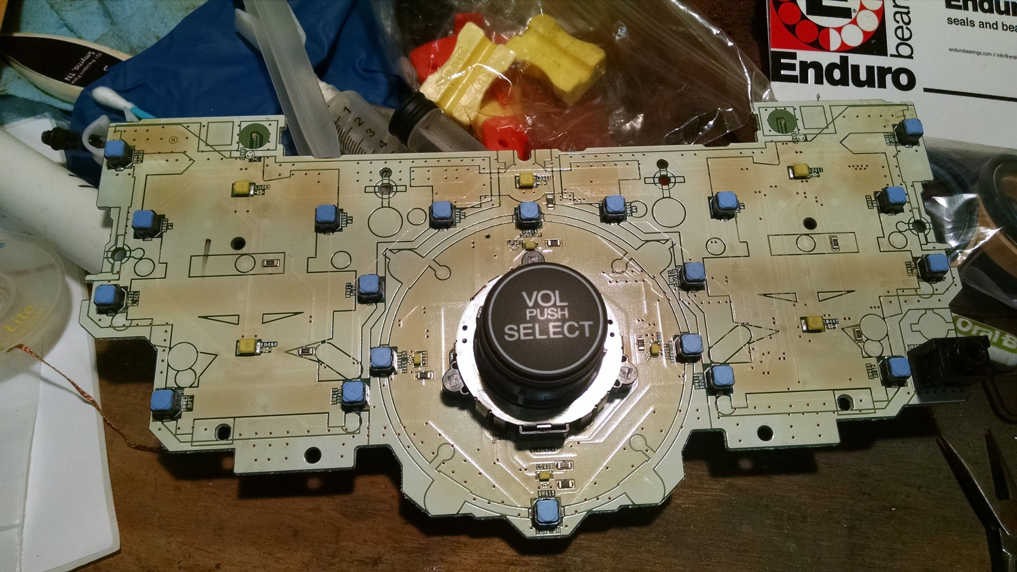

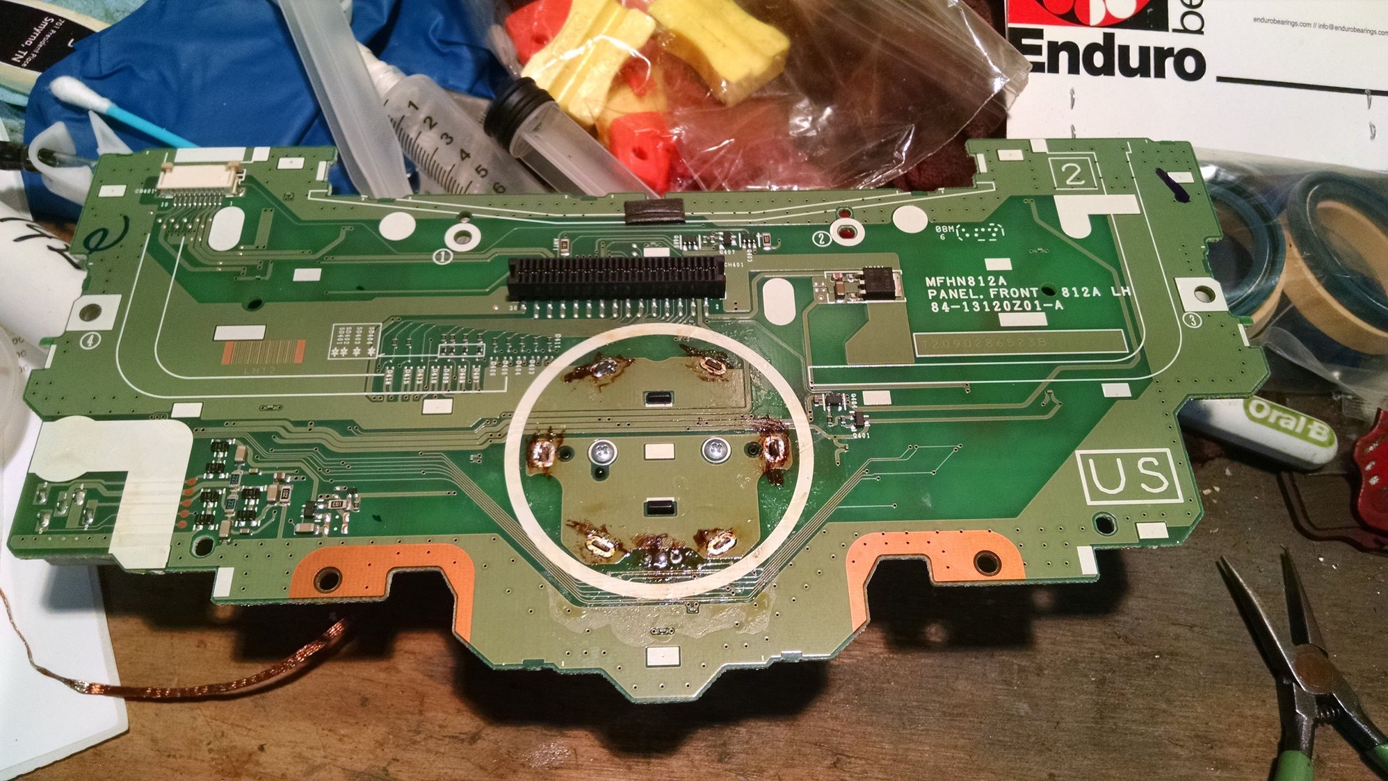

I took mine apart when it failed in the same way. It is a very labor intensive process with lots of de-soldering and delicate parts. My fix lasted a about a year. The 2nd time, I replaced it as Red_05.
It is a digital mechanism that that uses brass fingers on the back of the knob to "skip" across lands on the PC board. I suspect the grease/lube becomes conductive and causes the erratic behavior. You can buy an aftermarket face plate to convert to double-DIN as I did.

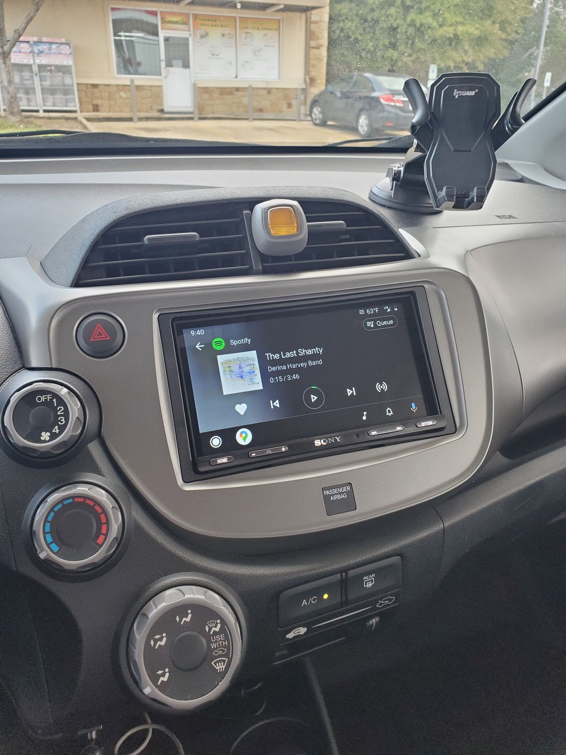

We had the same issue with our OEM radio, the volume knob determined what it wanted to do when turned. We replaced it a week ago, mainly to get Android Auto but toying with the idea of a backup camera. It does not seem needed, though, with the good visibility of the Fit.
There are Youtube videos on replacing the Fit radio, but it is really easy. There is one bolt holding in the radio from the bottom (but ours had already been removed, I assume by the previous owner). Once that bolt is out, open the upper glove compartment and there is a notch in the radio faceplate on the left that you can use with a pry tool to start removing the radio from the dash. It has 8 or so clips holding it in to the dash and it pulls straight out.

It is the ATOTO A6Y (lowest version 1GB + 16GB)(I think it is no longer in production) using the Metra dash kit.
These look intriguing, but I have not investigated. https://a.co/d/dMJUVjB

I don't think contact cleaner would work. It would have to flush out all the old grease, plus you would have to re-add some kind of grease to replace the old, I suppose.
My biggest challenges were the desoldering of the larger metal part (pictured) that acted like heat-sinks and the small metal (maybe brass) fingers in the actual knob assembly after full disassembly. The latter are easily bent/broken while trying to clean them. It is not any type of potentiometer nor is it optical. The multiple spring-like fingers contact multiple contact lands on a circuit board to "count" the rotational movements of the knob. This is how it would work in my mind anyway.
If it helps any, the knob assembly must be desoldered from the main board before you can disassemble the knob to get to the problem parts.

Cleaning the fingers worked for only a couple of months on my 2012 Fit and it was a real pain to unsolder the encoder intact. I ended up replacing the encoder which is a lot easier because you can cut the 6 mounting tabs and 3 leads and then unsolder them later individually after removing the encoder.
The encoder is an Alps Alpine part number EC40A1520403 and is in stock at Mouser as part number 688-EC40A1520403
