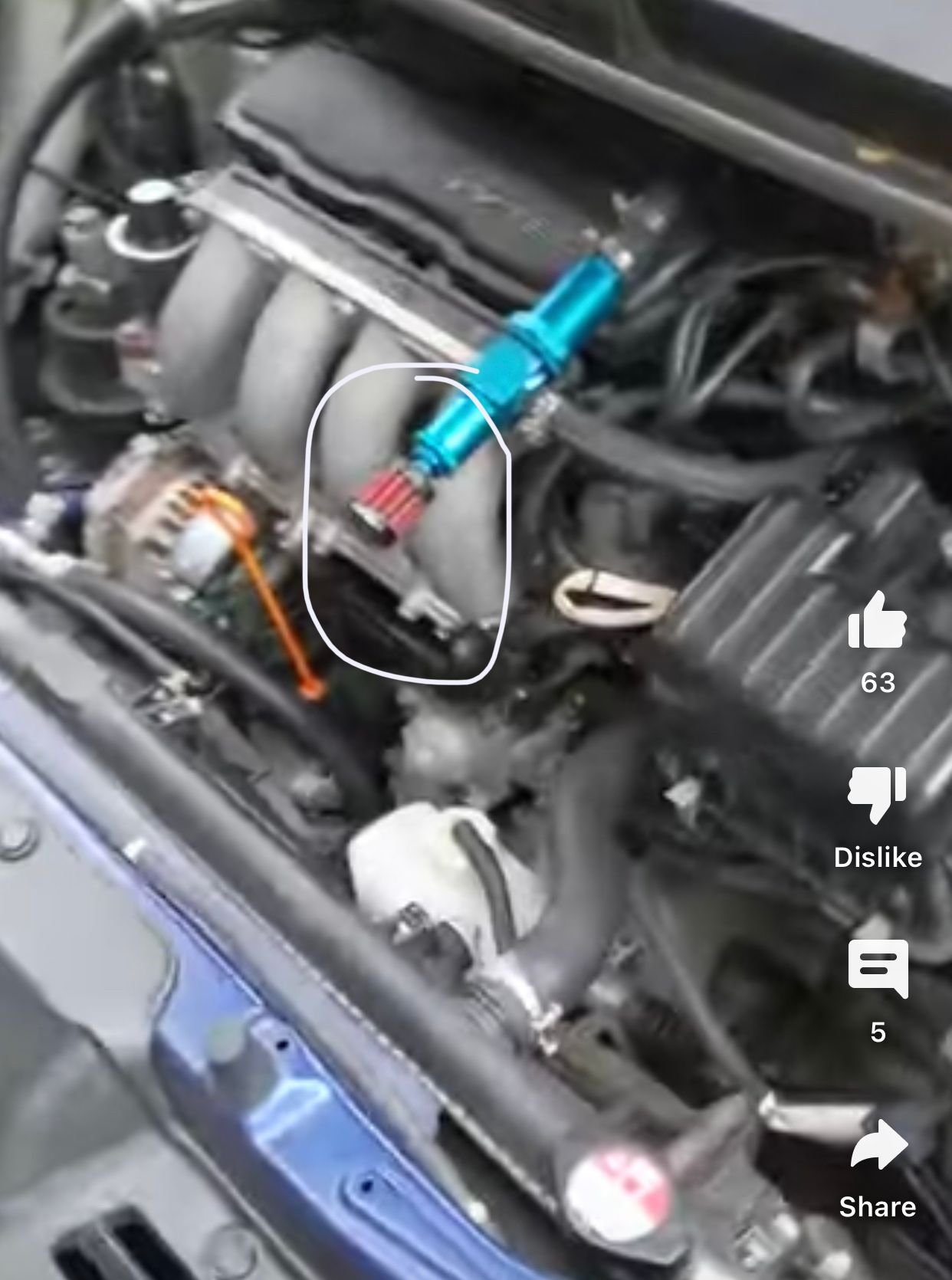

What’s that cone air filter thing
I founded this from a video and saw this

I know about the breather filter but don’t know about the blue thing

That's.. my car I think. it's a knock-off t-rev. secondary pcv valve purposed for creating negative crankcase pressure. I don't recall making a video but.. thats my mounting location, colors, hose clamps, ect.

no oil in throttlebody, feel akin to, i'm told, a lightened flywheel.
It reduces the amount of engine braking that takes place when the clutch is disengaged during shifting.
Don't jump on me for a misstep in speaking here I'm sensitive about my mod - which lacks a measured or explained performance descrip. from the manufacturer.

It came with specific instructions to use a separate pcv line from the one the factory valve is in. Taps into the one that goes to the airbox. I'll post up two or three pictures showing routing.
I didn't find any claims about a cleaner throttle body, and it wasn't something I was l was looking for. Really I'm unsure if that's a benefit, because I'm pretty sure it means all the blow-by gook stays in the oil. That would probably be a pro if I increased frequency of my oil services.
The other negative I see for this device is the junky little air filter, but man, I shopped and shopped for a higher quality one.
With regards to effects, I do notice a stark difference every time I press the clutch pedal down, as well as when I let off the throttle fully while in gear - moreso at higher rpms.
​​​​​​If not for that, I would have chucked the thing under the premise that I don't know whether I'm doing harm or good.
