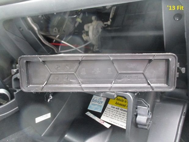

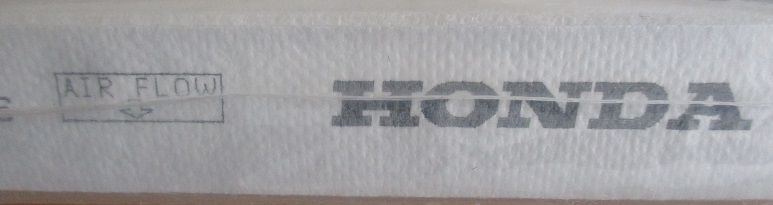

Arrow faces down towards the fan / blower . Just happen to pick one up for the '13 FIT .

The filter is on top of the blower , so air is drawn through the filter from blower motor .

You want the sucker to suck air through the filter.
The blower, aka the sucker, aka the sucker-blower, aka the blower-sucker, blows air downward and sucks air from above it. The filter location is above the blower (you can call it the sucker if you wish) so the arrow on the filter, which indicates air flow direction, should point down. That way the sucker will suck air through the filter. To avoid confusion I call my blower a sucker. What goes up must come down. What blows must suck. For every blow there is an equal and opposite suck. And vice-versa.

Supposedly pleated paper filters allow air to pass through in one direction, with less restriction than in the other direction. Also, they fill up with particulate matter faster, and their flow rate decreases faster, if air is sucked through in one direction, than in the other. Why? I don't know. Maybe the manufacturers made this "fact" up? Anyway they all have an arrow printed on them, fiberglass filters too, indicating which direction the air should flow.
Very important: if you put a filter in one way, and you take it out, and then put it back in – do not put it in the other way! It is pretty obvious why.

I don't know what video you are referring to but I think the arrow on the filter should point down. That is the direction that the air flows. HVAC devices do not blow air through air filters, they suck air through air filters. That by the way helps make sure that the filter is pulled down against the filter cabinet and that therefore air can't be forced around the filter. The arrow on the cover for the filter refers to the direction that the cover goes when snapping it in place – because it says "up" next to the arrow, which points up..

Yes the arrow on the filter should point down. The blower-sucker is sucking air through it, from below it.
