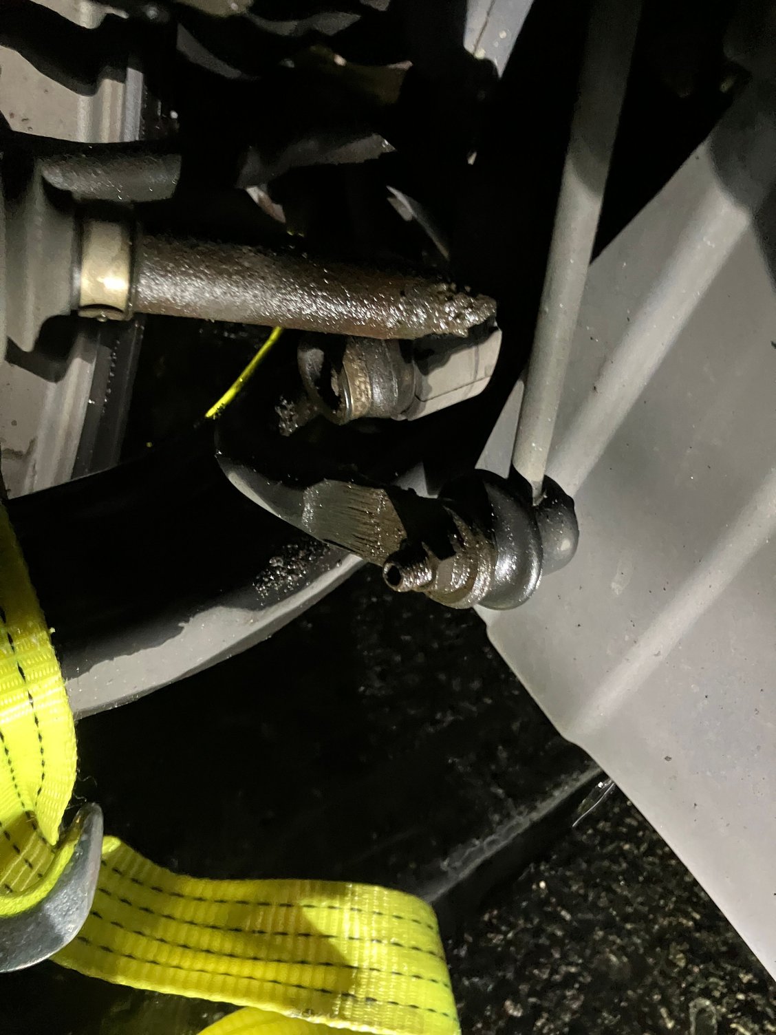

Have a 2009 base model , runs fine. Tonight while driving there was a loud bang like I hit a rock. The engine runs fine but the car stopped moving. Shifting the tranny it’s clicking like crazy. No codes , no lights. Got under the car , passenger axle is snapped. Found there was a recall. Hoping Honda covers it. When I’m park the car still rolls like it’s in neutral. Can the broken axle cause this ?

The axle connects your wheels to the transmission and engine. Broken axle means that the wheel can turn freely regardless of which gear the transmission is in. Use your parking brake and/or wheel chocks until you get repaired.
You're in a salt state so your axle repair should be covered under the recall. It would be worth trying to get the other side replaced as well, even if you have to pay for it.

hoping they cover it at the dealer , but how is it rolling with the driver side axle still attached ?

You have an open differential. If one front tire can spin freely (e.g., on a patch of ice, or in this case because the axle is broken), the other front tire doesn't do anything because all of the power (or in this case, the stopping force associated with being in Park) goes to the wheel without traction. So, the broken axle (no traction) stops moving (i.e., is in Park) and the opposite wheel and axle spin freely in the transmission. Hence, no Park. Also why you always want to use the parking brake, even in an A/T car.
This is the same reason why your car stopped when one axle broke. If you had a locking differential you could still move with a broken axle. It wouldn't be a good idea, but you could do it.
